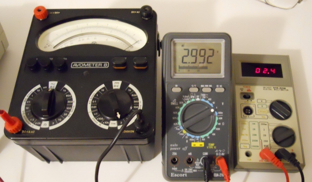

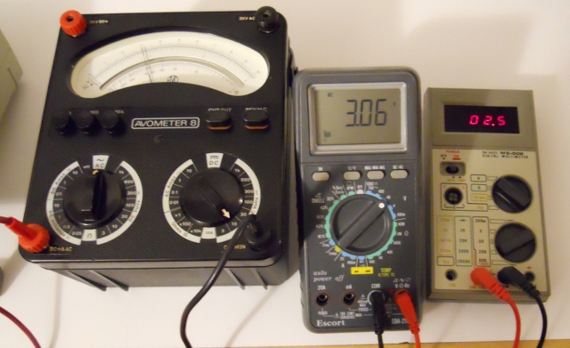

Mooly, your results are better than I expected. Any idea what they would be like on 60Hz or 120Hz? I'll test mine on the 200V AC scale out of curiosity.

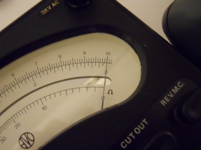

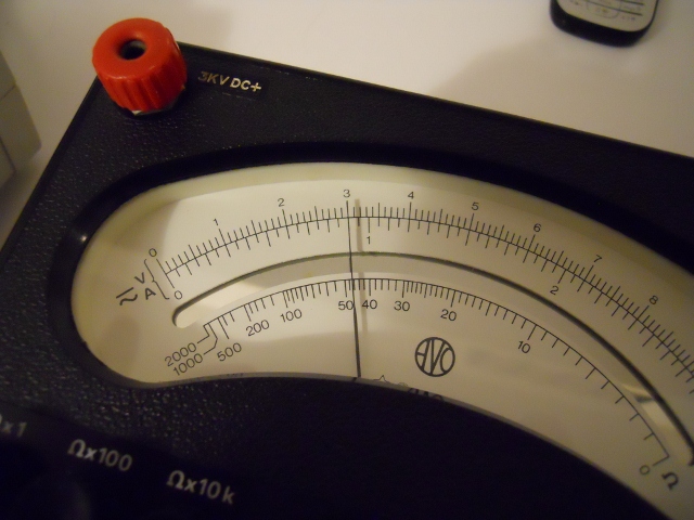

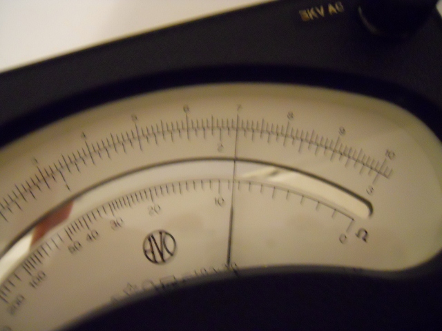

Here you go, this was at 60hz
That LED DVM is not to be trusted! 😉 The other one does pretty well, doesn't it? Close enough for our tests, I think.

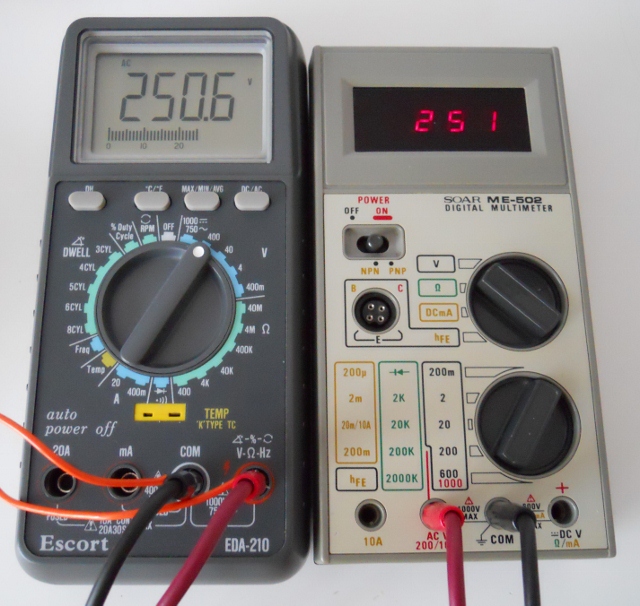

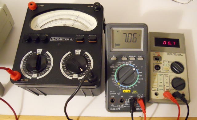

Pano, as you say "not to be trusted".

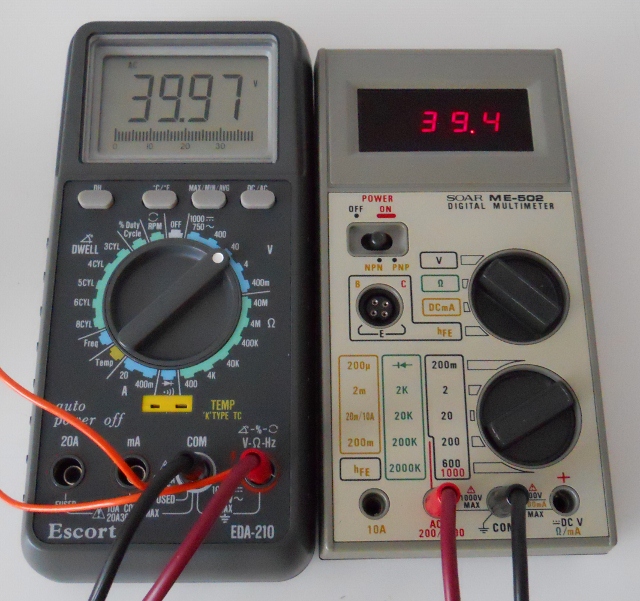

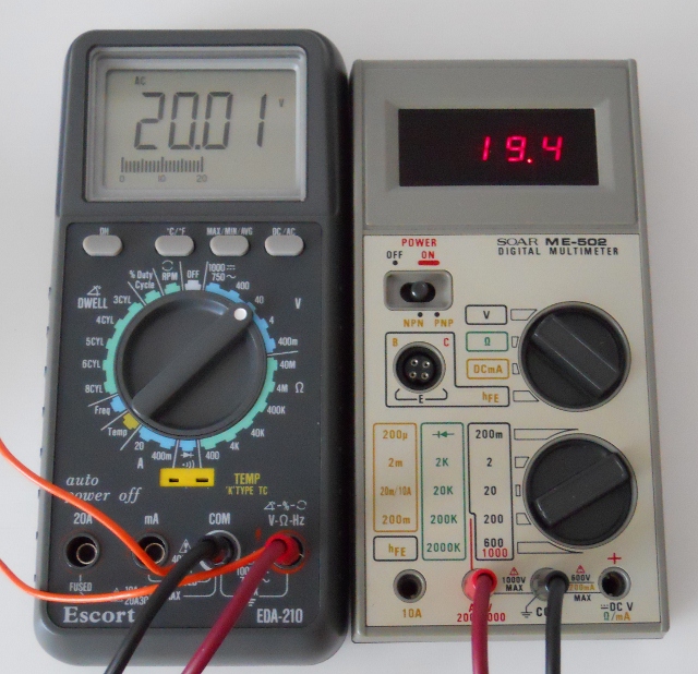

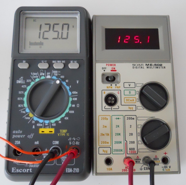

These pictures are self explanatory with range settings shown. Voltages were measure on a transformer secondary and primary tappings... compare the readings of the two DVM's with these higher voltages.
It shows that unless proved otherwise do not assume your DVM is accurate on low level AC even if it is a sine wave and even if it is within the frequency range of the meter.
Mooly,
if we assume that the "escort" is absolutely accurate +-0.005%, then the errors in the Soar are from left to right.
-3%, -1.4%, +0.08%, +0.16%
Some of these readings are right down to the least significant digit. Read the spec for the DMMs. What is the +- tolerance of the different AC scales? What is the least significant digit tolerance? What is the source impedance of the voltage being tested? What is the input impedance of the meter taking the readings?
What is the problem you are showing?

Thanks for the double check, Mooly. The LED meter does a lot better at higher voltages. That's why I have suggested not using a 200V scale for these tests - you can't be sure of the readings. On a 20 VAC scale, things will be a lot closer.

Hi Andrew,
There's no problem, it just came about discussing possible inaccuracy of meters (or lack of) at low AC voltages after I posted a pdf on my AVO calibration.
The DVM's and AVO in all the tests were run in parallel so source impedance doesn't affect the readings which in the last tests was mains and transformer secondaries. It is pure luck the tranny gave just under 40.00 volts as that coincided with the 40 Vac range on the escort meter.
The SOAR manual was mislaid some years ago (it's around 30+ year old now) and the escort was an "aquisition" from a colleague.
You're welcome.
The SOAR officially doesn't have a 20Vac range, just the 200 and 600 volt. Personally I tend use a scope for all audio measurements with a claculator alongside 😉

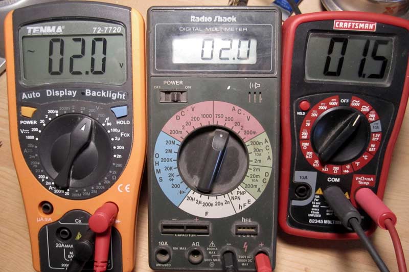

Inspired by your meter check I did my own shown here. Actual voltage is 2.08V AC 120Hz.
Any higher and the Tenma and Radio Shack showed 2.1V. Any lower and the Craftsman shows 1.4V All on the 200V AC scale.
Not surprising that the Craftsman is off. It's a $30 meter designed for much higher AC voltages. As the voltage drops, it's farther and farther off. The other two work just fine for general audio use up to about 1Khz

Great to see another comparison like that, thanks.
Because I never normally use a DVM for signal measurement it's something I never gave any thought too. Some folk are going to get misleading readings following my method in the other thread if they have a meter like these.
2 volts at 4 ohm =1 watt
1.4 volt at 4 ohm = 0.49 watt
Massive error... eek !
