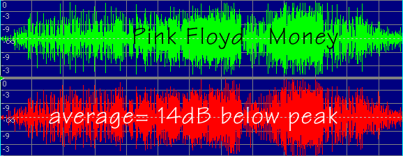

Gogitech - I suspect that you were missing the real peaks when you measured. They can be pretty fast and almost impossible to catch with a DVM. I looked at my version of Money (there are so many remasters) and it has an average level of -14dB, pretty hot. Thru the loud sections the average is only 12dB below peak. (see below) Still, of your peaks really were 2.5V that would put the average way down at 1/2 volt, or 31mW. I'd be as skeptical as a.wayne on that one. Possible, but not likely. I've attached a zipped MP3 of a 120Hz tone at -14dB. It matches the average level I found on the Money track from the CD layer of the DSOM SACD version. If you can, please measure that at the same volume setting as you played Money.
The "tricK" with the 120Hz tone is that it's easy and accurate to measure with a DVM. And it's recorded at the same average level as most music. You might want to sneak into it if you don't think your speakers will handle it, turn it up slowly. Not likely to be a problem, if music at the same level is not.

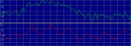

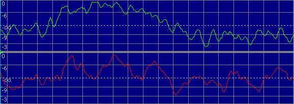

Nice plot showing compression.
Note all the peaks above the one of mONEy.
They all reach the same Vpk. Coincidence or compression?
As far as I could tell there wasn't any clipping here. It is, after all, a premium edition. 🙂
There isn't a lot of dynamic range, but it's loud Rock, so there shouldn't be. Compressed? Sure. But that's part of the genre. No idea if it's more compressed than the original.
EDIT: I take that back. Zooming in on the rage you pointed out, I see what looks like hard limiting. Zooming in further shows either clipping or a brick wall limiter. See attached as typical of that section. Funny thing is, that flat top is not at 0dB, it's at -0.7dB. There's still a bit of room above it.
