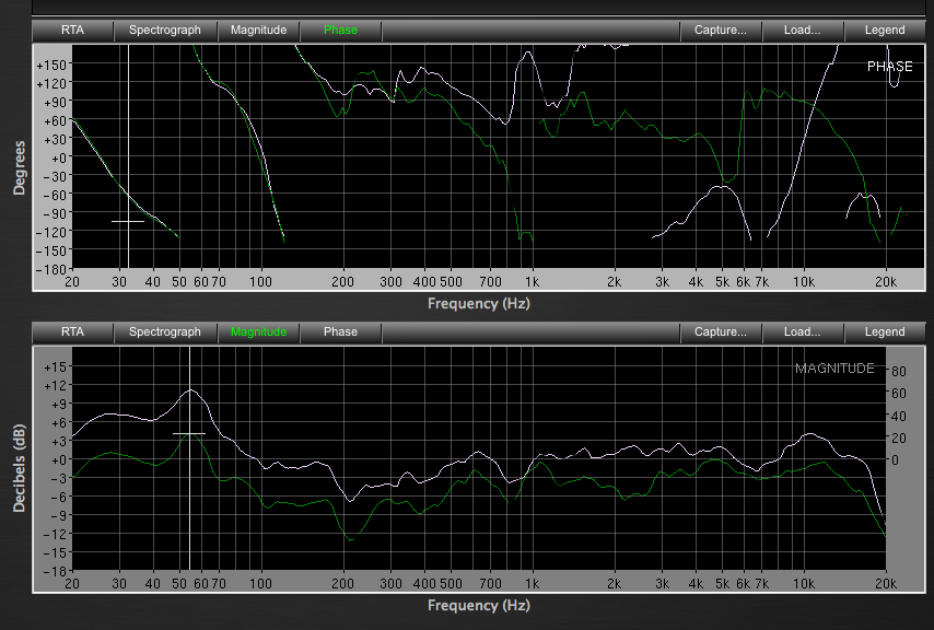

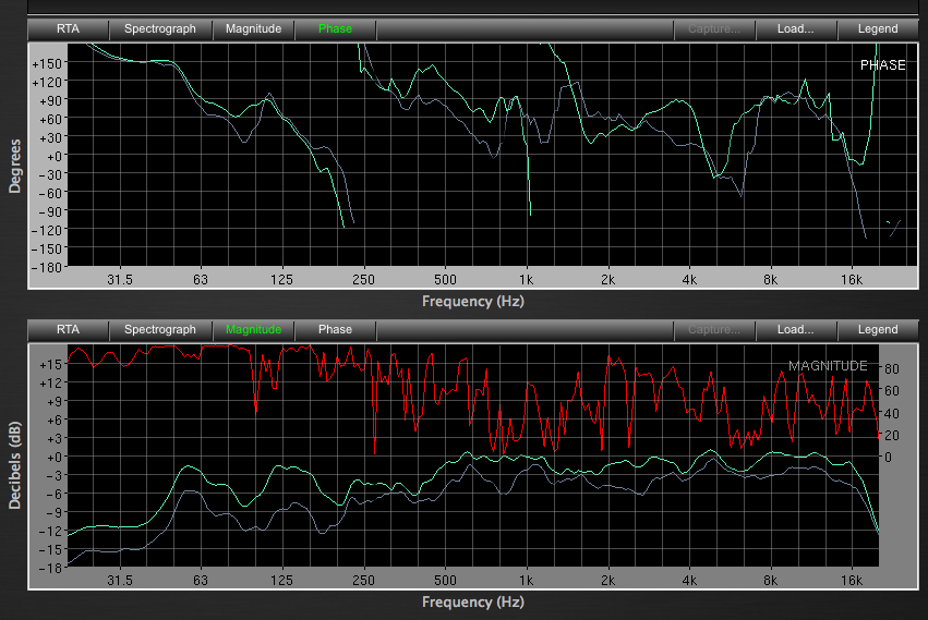

Testing my home stereo indoors results in about a 3 dB gain (as measured with a dB meter) from one to two speakers, the same as one would expect in the difference between coherent (+6 dB) and incoherent noise (+3 dB) summation.
The graphs show that in the LF, where the phase aligns fairly well between one and two speakers, the gain is a bit more than 3 dB.
With the mono sub engaged, the level increases 6dB in the sub range when both left and right inputs are combined.
Small movements in the microphone result in large magnitude and phase differences, IIRC the "nosub" mic placement was more centered between L/R, the screen shot with the sub was my normal "couch potato" listening position which is a foot or so to the right of center.
At any rate, when considering the increase from one to two "full range" speakers, one should probably not count on more than 3 dB, and choose power and sensitivity accordingly.
Art
