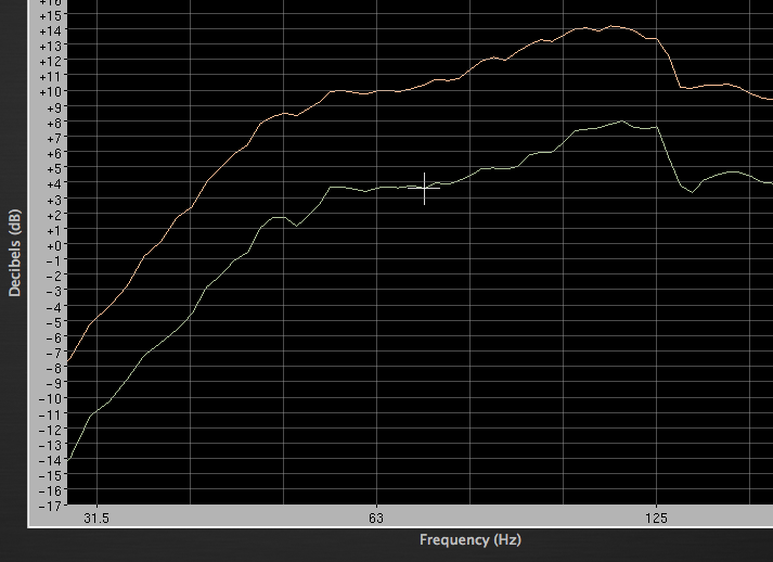

Okay, here we go.
Details of my system as it's set up are in my signature.
I ran Money as loud as I'd want to listen to it, then did the 120Hz test, using a Fluke meter (ought to be reliable). Came out at 1.3v for the Fostexes, 0.1v for the subwoofers - the crossover isn't far from 120Hz, so thought I might as well measure it. Turns out negligable.
Taking 1.3v RMS,
1.3^2=1.69
1.69/8=0.21w average power to the Fostexes.
Now, as many of you will know, the FE126s (and others) have a prominent upper midrange: sensitivity ranges from low 90s in the lower mids, peaking at 100dB at 7kHz.
I have installed a notch filter to tame this peak by ~4dB, leaving a sensitivity in the mid-90s.
Listening distance of maybe 2m, calculated SPL (taking 95dB@1w) = about 88dB.
Peaks of 102dB, 4w per side used out of maybe 15w.
Subwoofers aren't even trying.

If two speakers are in use then maximum SPL will be ~ 3dB more than that.
Hi Andrew, I think you've missed something - you gain 6dB for the other speaker: +3dB on double cone area, +3dB because you double electrical power.
... and the 120Hz was 14dB down.
Chris
PS - Pano, you're about right: the Tripath amp is running off a 12v SMPS (which happens to run closer to 13v).
The stereo speakers are too far apart to gain anything of significant in SPL.
I do agree that the very low bass is changed by connecting the second speaker, although this is debatable and others have said I speak rubbish on this.

"The stereo speakers are too far apart to gain anything of significant in SPL."
Conservation of energy requires that two more or less identical speakers reproducing the same signal and receiving the same amount of power in a typical listening room WILL produce an spl that is a clearly perceptable (about 3db) as being louder than only one speaker because approximately twice as much acoustical energy is being delivered to the room. To convince yourself of this simply have someone turn one of the speakers off while listening to some music.
"you gain 6dB for the other speaker: +3dB on double cone area, +3dB because you double electrical power"
I think this is double counting. There is no inherent advantage with respect to spl gained by doubling the cone area, provided that the cones are too far apart to couple (increasing radiation resistance), cone motion is linear and they are being operated well below thermal compression. If the amount of power delivered to the first speaker were increased by the amount that would have gone to the second speaker, and the speakers were operating well below significant thermal compression, then the spl would be more or less the same as with half the power going to each of two speakers. Two watts into one speaker should provide about the same spl as one watt into each of two (+/- identical) speakers.
Bob
Bob
Hi Bob,
Your post would imply that placing the two speakers next to each other will result in a 3dB increase in sound level, as they are now acoustically coupled.
People are in bed here, so I'll leave this quick test in your capable hands.
Alternatively, with an SPL meter running, disconnect a speaker and see what the level drop is.
I'd be interested to hear of your results: I'll be trying the above experiments tomorrow.
For now, goodnight
Chris
For now, goodnight
Chris
Bob,"you gain 6dB for the other speaker: +3dB on double cone area, +3dB because you double electrical power"
Bob
As long as the speakers are within 1/4 wavelength distance between the two there will be a 6 dB increase going from one to two, 3 dB for doubling cone area, 3 dB for doubling the power, exactly as stated.
Room modes and different distance between the two speakers and the listener (or test mic) will result in fluctuations from the ideal, but one can easily see the 6 dB level difference between one and two speakers tested outside, as in the chart below.
Art
