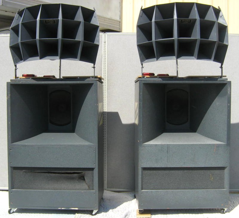

I'd like to see a 19" tweeter 😀
Here you go! (mine are similar but 10 cell)I'd like to see a 19" tweeter 😀
