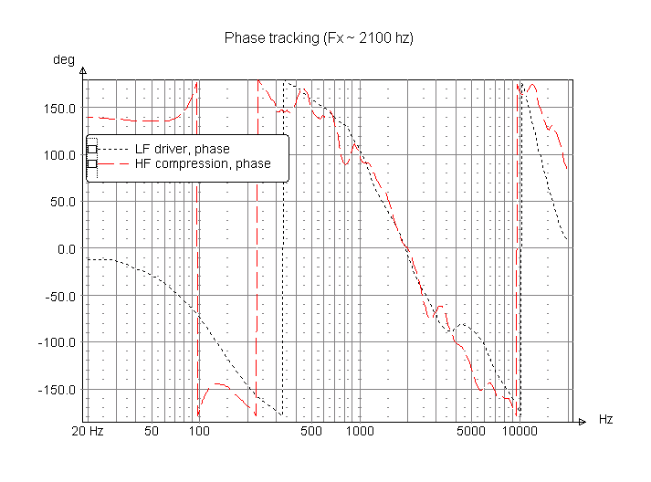

I might mention that the mid and tweeter overlay each other perfectly on the actual Frequency Response graph...
Best Regards,
Terry
Edit: The phase tracking of the frequency response overlays very nicely. See attached. 🙂
