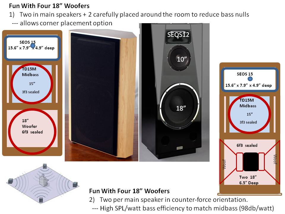

Fun With Four 18” Woofers
1) Two in main speakers + 2 carefully placed around the room to reduce bass nulls
--- allows corner placement option
2) Two per main speaker in counter-force orientation.
--- High SPL/watt bass efficiency to match midbass (98db/watt)

This is quite interesting, although it's a bit more than what I am currently aiming at! That doesn't mean I don't want to see it!
