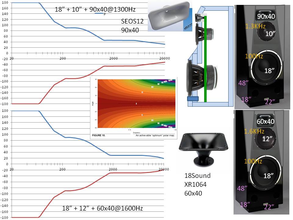

Consider two Classic 3-way high efficiency designs:
18" woofer + Xover 90Hz to 10" midbass + Xover 1300Hz to 90H x 40V waveguide with 1" compression driver. The 90x40 polar pattern is good for home theater couch, or corner placement.
18" woofer + Xover 90Hz to 12" midbass + Xover 1600Hz to 60H x 40V waveguide with 1" compression driver. The 60x40 polar pattern is good for small rooms.

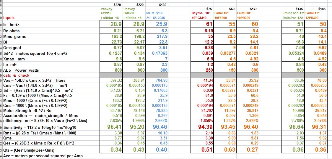

18" Peavy LoRider 18" woofer ~$220 This is a well reviewed, pro audio quality woofer.
model 479910 has a 163g Mms and produces 32Hz bass in an 8 cuft cabinet.
model 560600 has a 198g Mms and produces 24Hz bass in a 12 cuft cabinet.

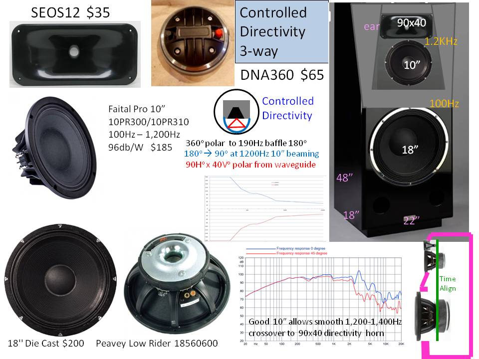

GOOD 10" and 12" midbass:
Faital Pro 10” 10PR300/10PR310 100Hz – 1,200Hz 96db/W $165
Faital 10FE200 $60, needs large sealed volume
Beyma CM10 $80, needs large sealed volume
Faital 12"12PR300 $185
Eminence DeltaPro-12A $135

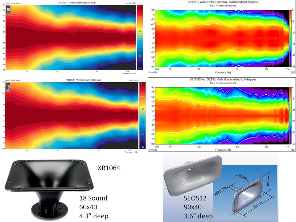

90x40 waveguide === SEOS12 ~$30
60x40 horn 18Sound XR1064 ~$85
12+SEOS designs at:
Fusion-12 Tempest - Fusion Series - Waveguide Speaker Kits DIY Sound Group
Price Break Down:
12" Eminence Delta Pro-12A: $139.99
Denovo DNA-360: $79.50
SEOS-12 waveguide: $28
Set of crossover parts: $46.04

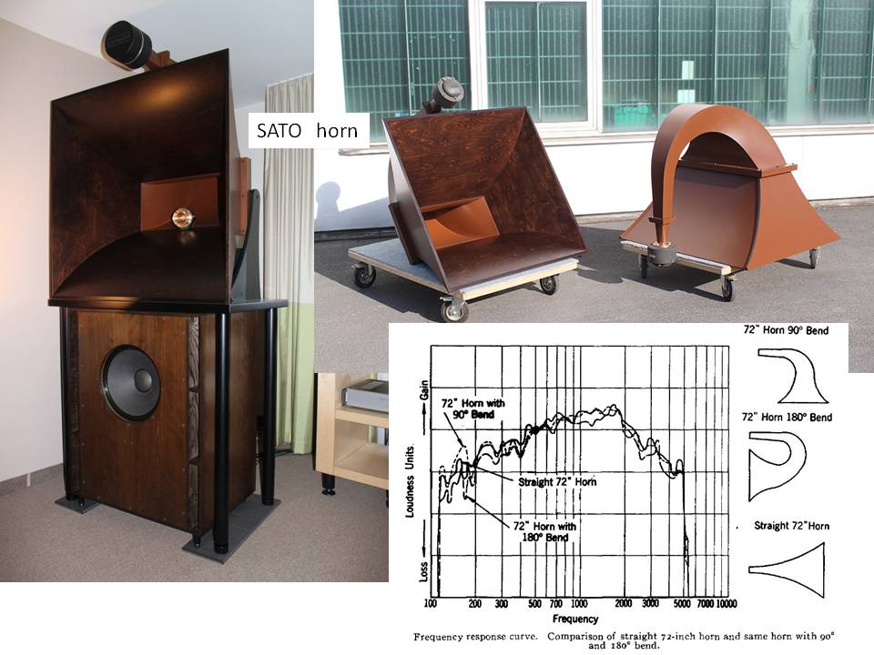

"Western Electric 15A Small SATO Horn". Terry Olson
TerryO,
Are your Small SATO Horn speaker plans similar to the Jean Hiagra design attached?
TerryO,
Good question, I'll have to check one against the other and see if they are similar.
