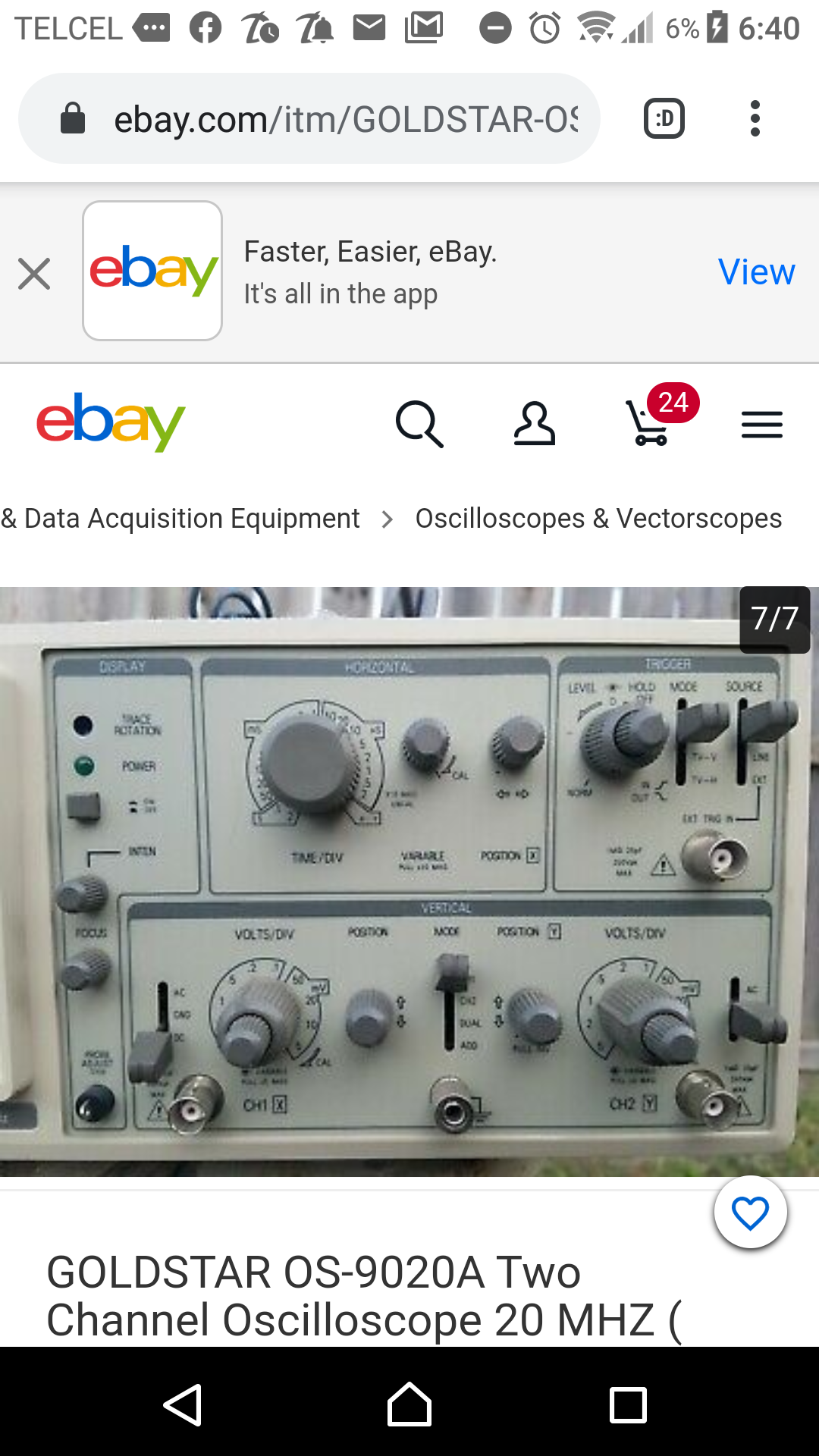

Thank you is the same model scope of ebay, but i Will buying from a person in my city.

Perry i lost the deal when i was driving to the house of the seller,some one arrive first and bougth it.
I think i lost a very good deal, i was going to pay 20 us dollar for that scope.

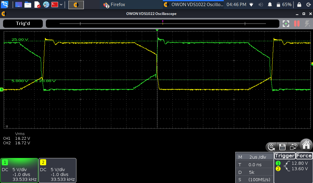

i m back again with this amp, now that i got the owon scope, can you comment what do you think i posted a pic from the signal of the psu i do not see a problem with it.
ihave +85 and minus 85 volts in rails i

i tried to measure switching signal , there is no signal in the gates i measure other pins and got only the dc voktage of the rails in the pins a said before
i think the next step is replace the switching Ic.
