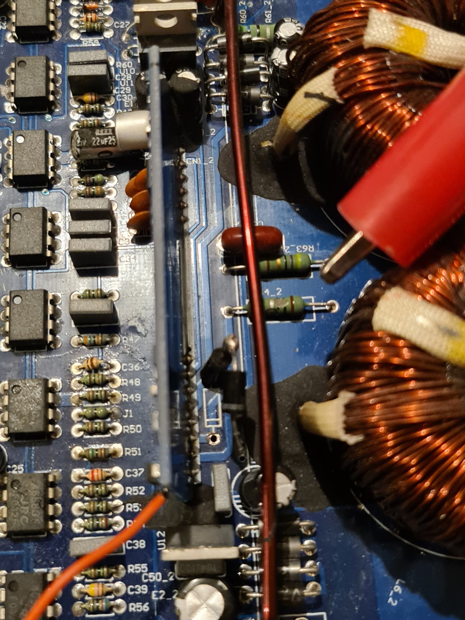

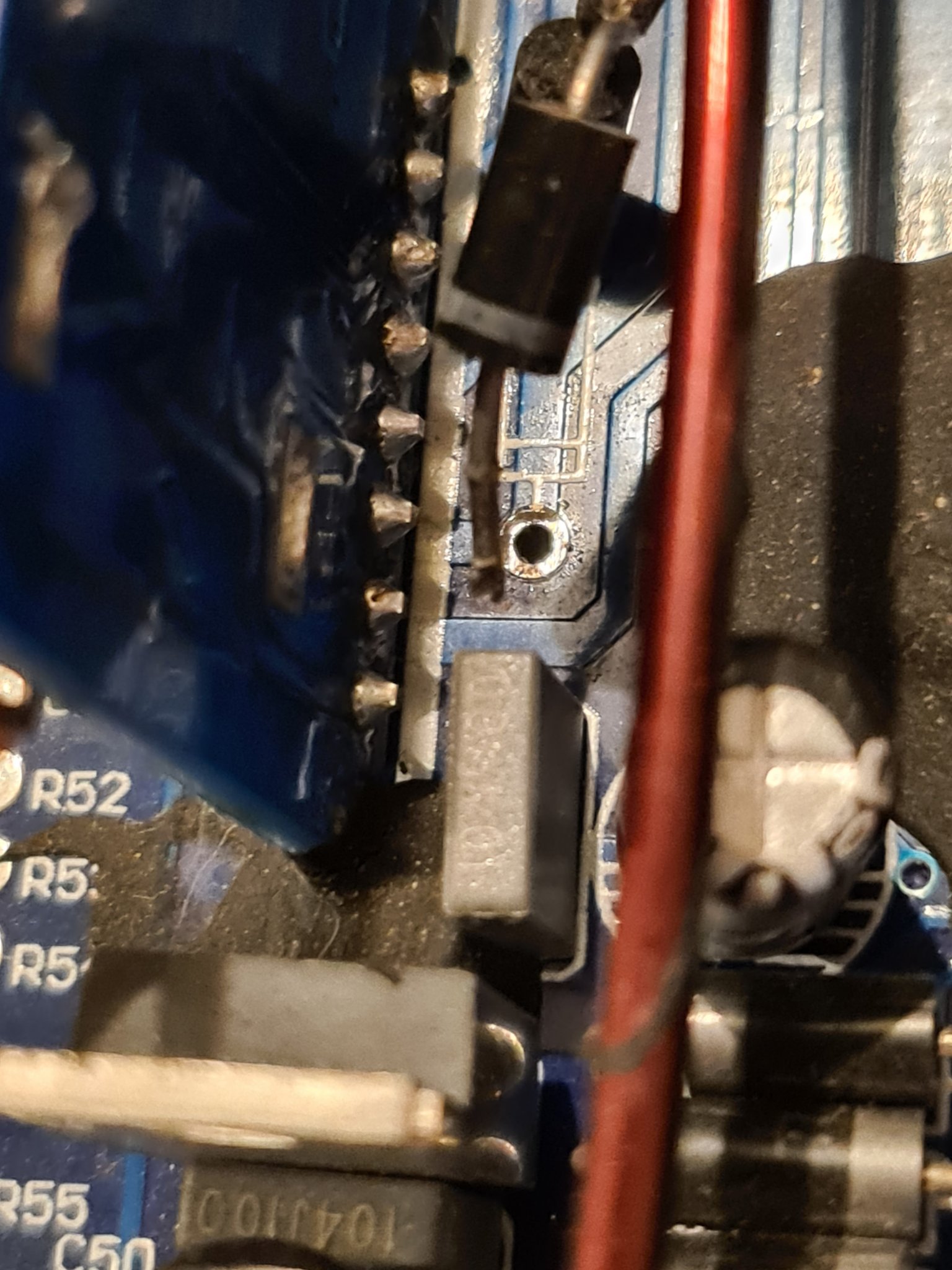

I Will inspect again there is a posibility something. else in the driver board has damaged, because at the beggining a protection diode of 250 volts going to pin 12 of the board was in short circuit.(i replaced with two 100v +150 volts) tha makes me think a high voltage come into the board trhu pin 12 tin 12 is the same pin where negative of 9v battery is conected,at this moment i desoldiered 1 pin of the diodes in series from the board just for testing
In cl1 y got 9.31 volts (down pin negative)
Yo are right Perry, i found a signal! Excuse me i expressed incorrect, i mean i do not find good drive signal.

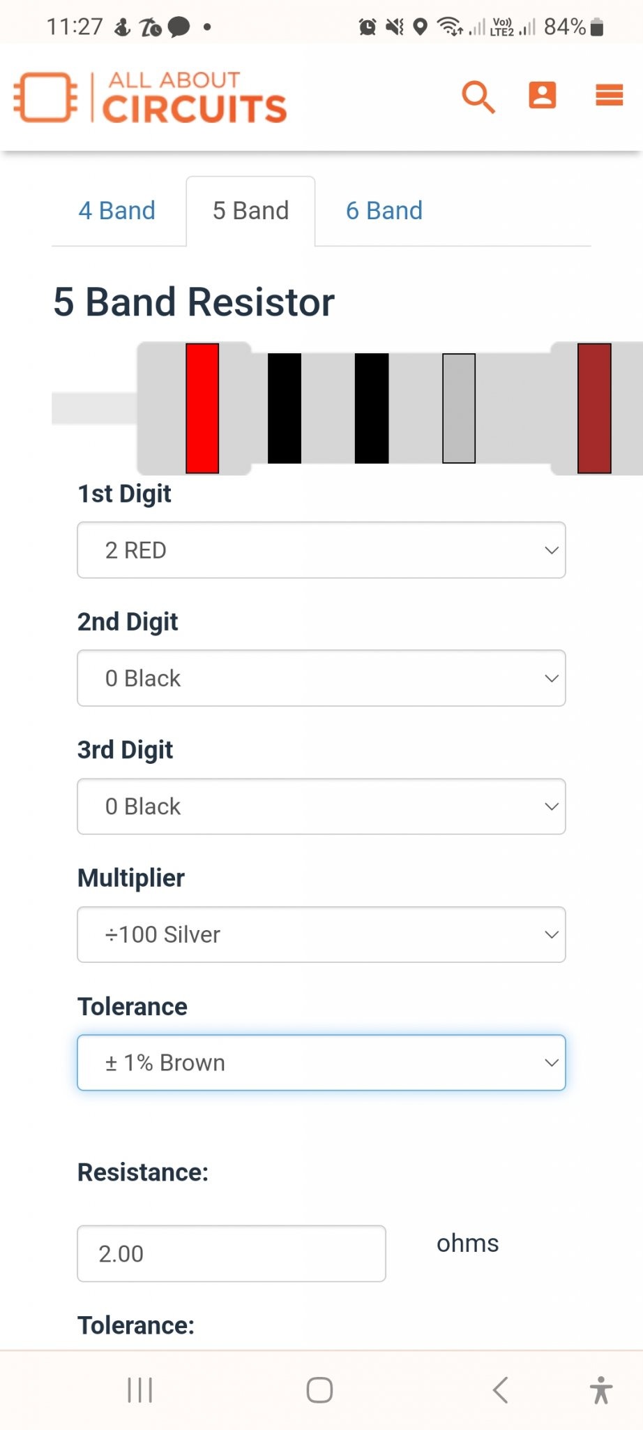

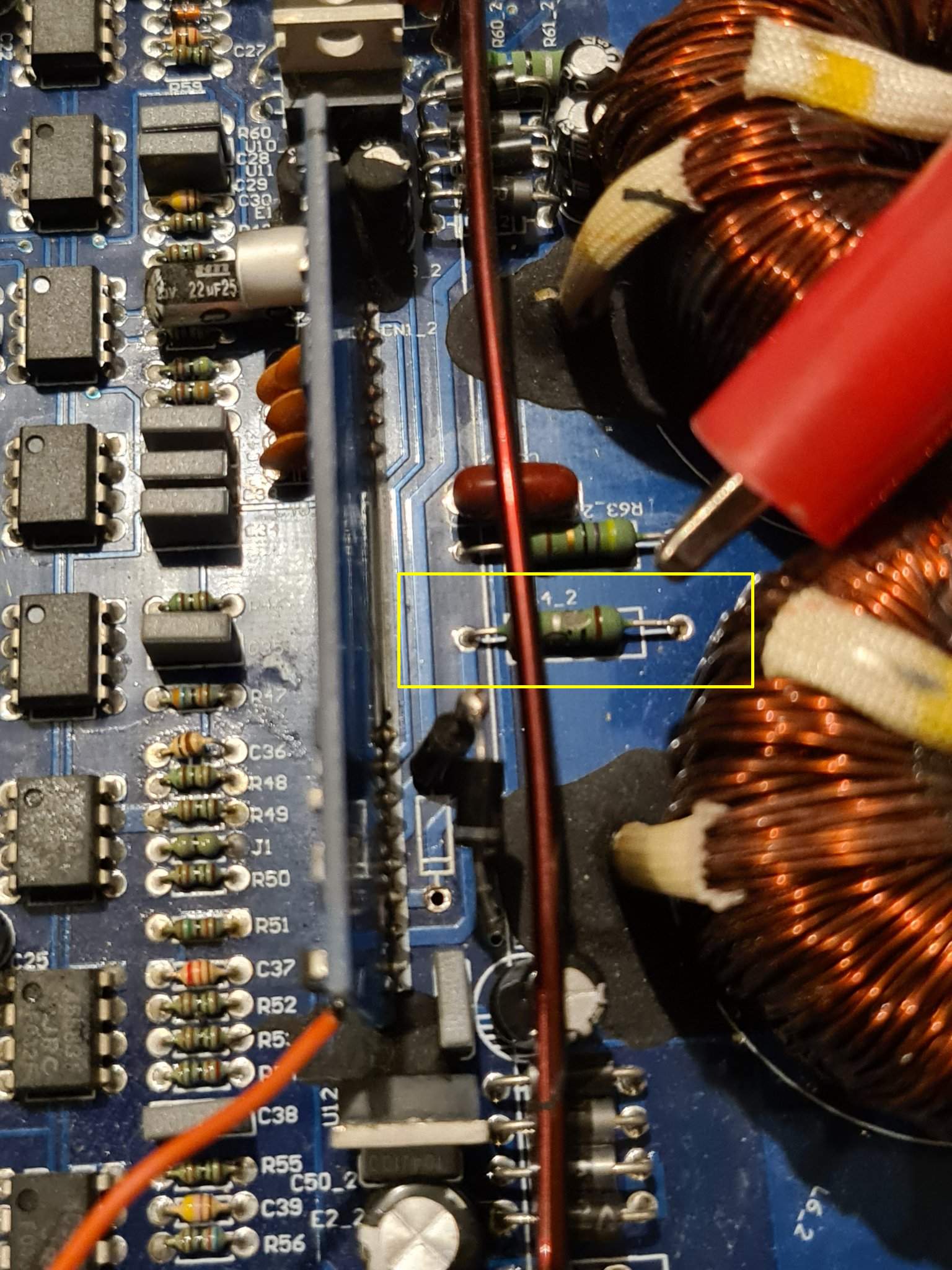

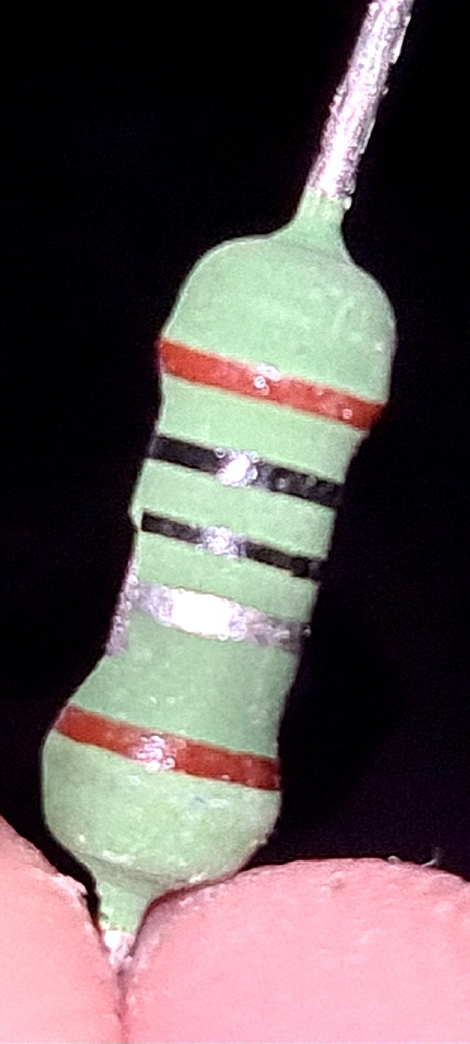

Is 5 band resistor
Now my doubt is: 1 ohm or 2 ohms, is more like red color to me, i do not know, what do you think?
If someone have this amp tha can help with meter redings of this resistor?

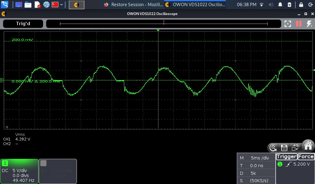

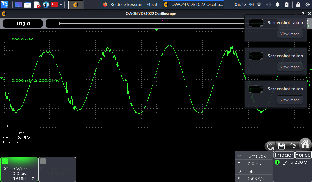

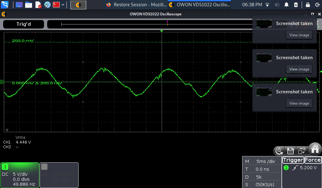

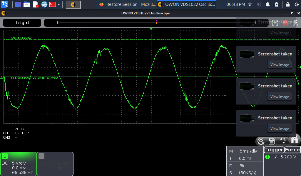

i installed teh fets the signal i got is a bit Noisy.
i will stop the rapair work, until i got more fqa38n30 the two fets i was using for testing before i got high drive signal got damaged
the fets are easily damaged i did not feeled extreme hot just got warm, but got damaged🙁
another fets i have tested (like 31b20) got hotter and do not got damaged
I did not installed the 10k resistor (was not necessary) the drive signal apeared after the 1 ohm bad resistor was replaced, and applied 9volts between VS and VB.
The signals i show in post 132 are directly taken from speaker output
