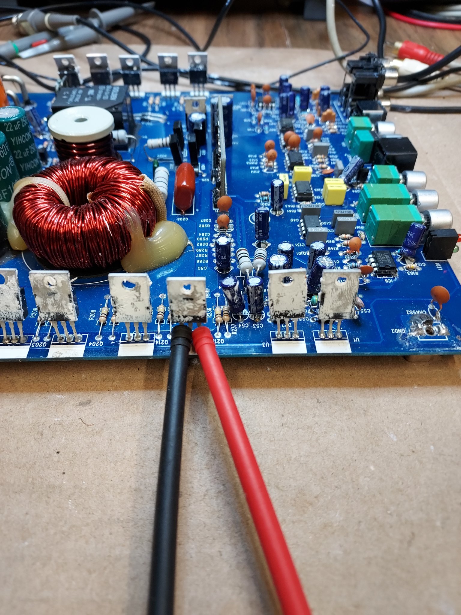

That sounds like there is a drive problem (likely on the driver board) for the high-side FETs.
The positive rail caps may be damaged if the amp didn't draw excessive current at 120v.
I had the current limited to 4.5A and only kept the remote on long enough to get the readings. Would the next step be to pull the output fets?

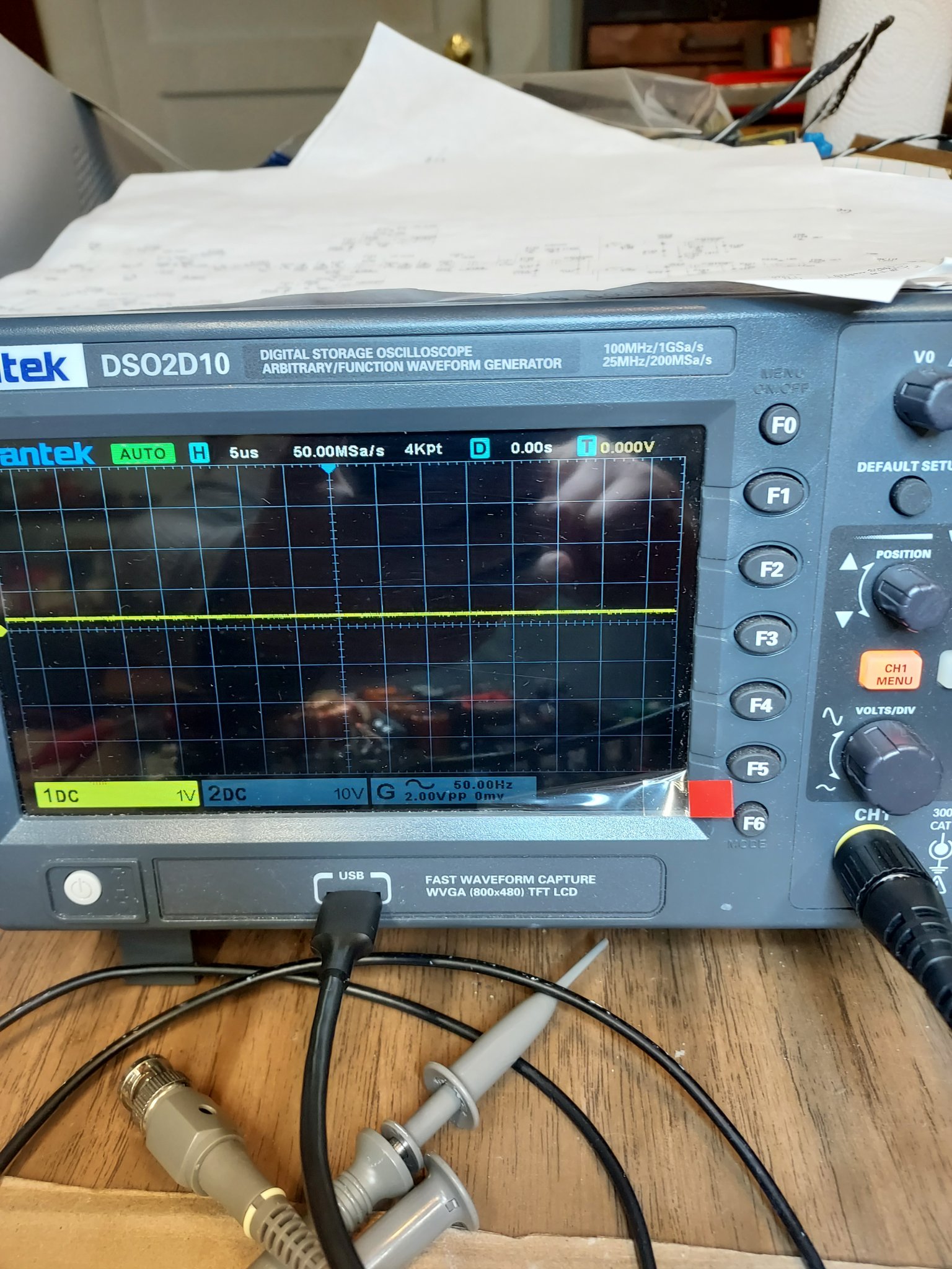

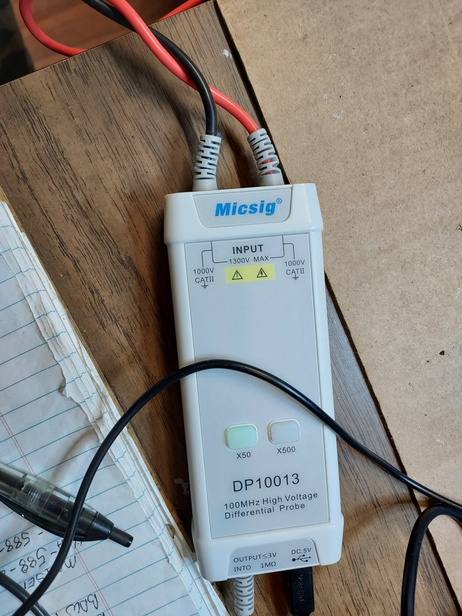

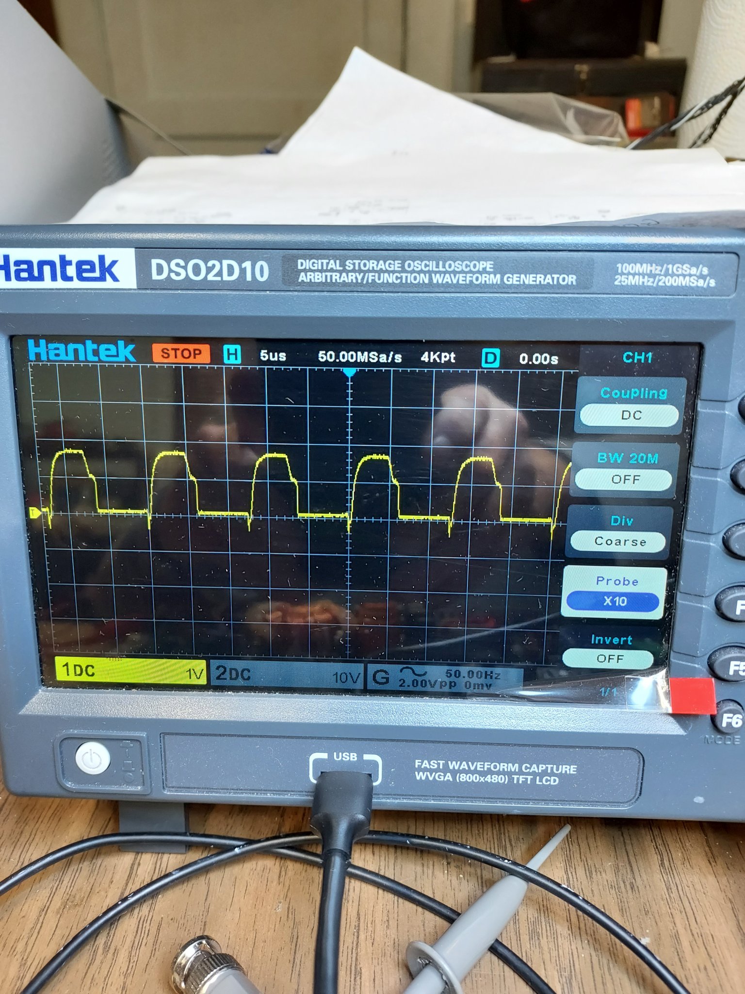

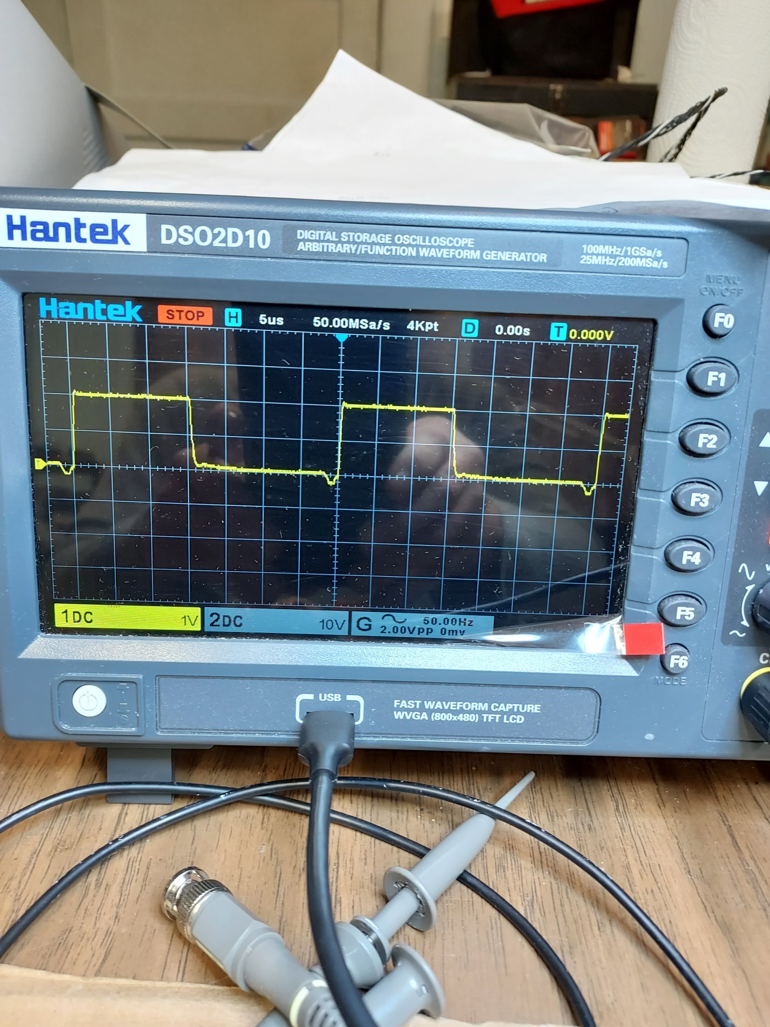

Using the differential probe, do you have a good drive signal on the high-side FETs gate to source?
