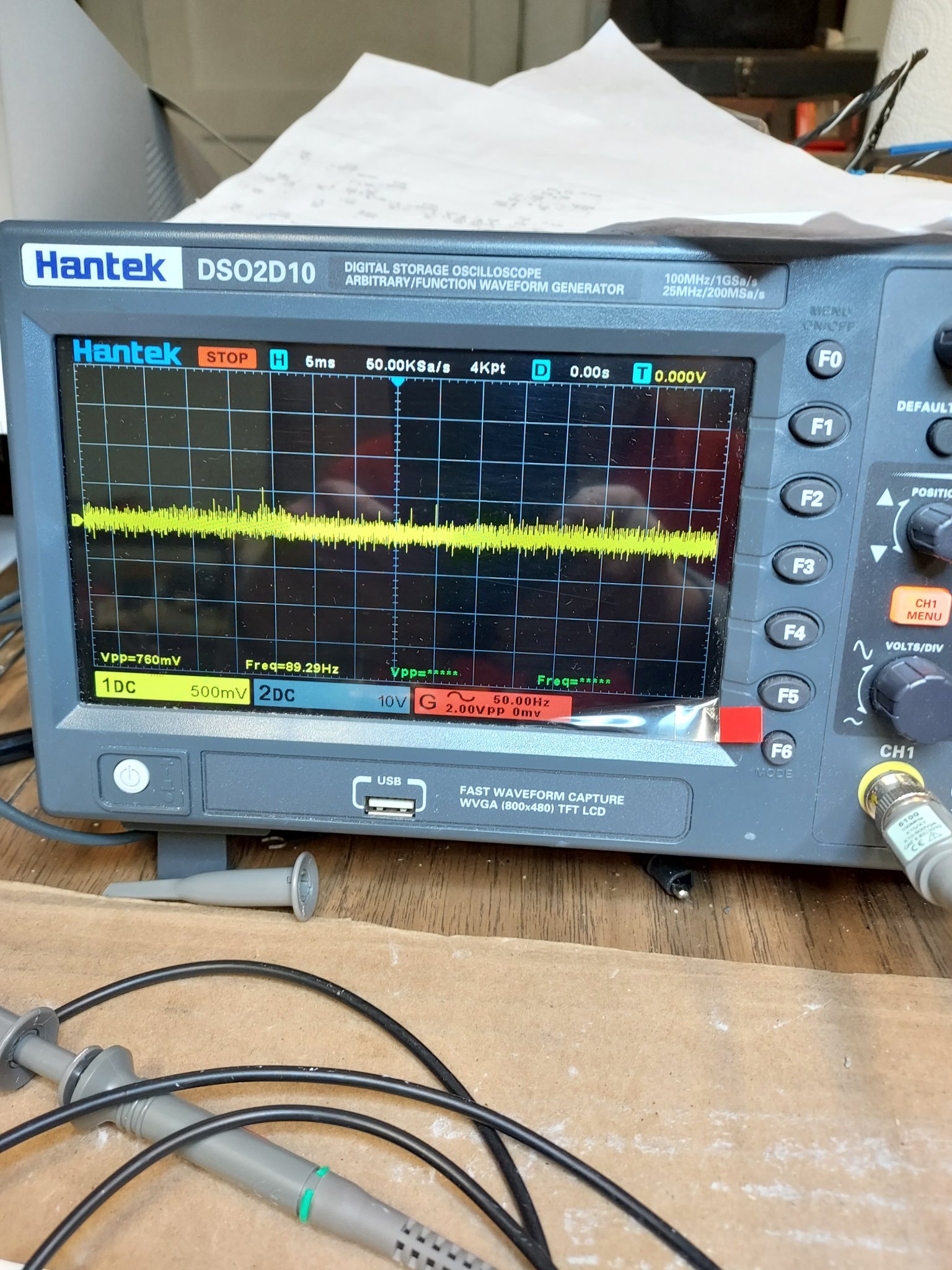

Attached screen shot of pin 7 of the op amp that I shorted pins 6 and 7 together. Pin 5 connected to pin 1.

For the shorted op-amp, does pin 7 look the same as pin 5?

For the shorted op-amp, pin 7 looks the same as pin 5.
