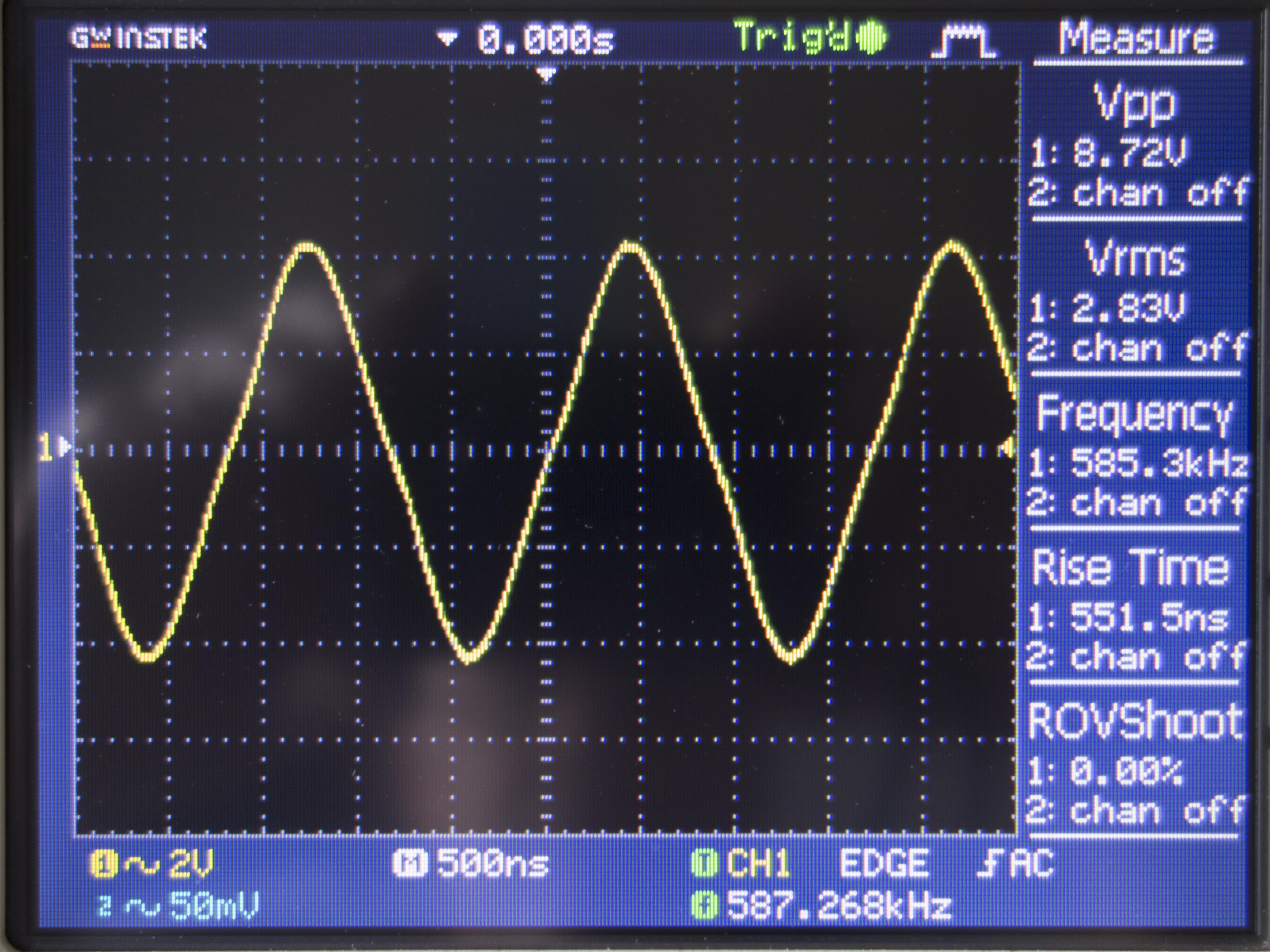

To answer your question first, Amp B RE picture ('Triangular)
This is with the Amp I term 'B' connected to the Earthed Ripple eater and output to the 8 ohm dummy load (with associated WW resistor inductance). Probe at x1 across the amp outputs.
Removing the RE earth the output reverts to pure sinusoidal.
When I switched on the amp today (no load) the output jumped back up as per AMP B with RE earth(ed) picture. About 250 mV P/P waveform (as against the low value yesterday). Nothing had been changed.
To keep it short, adding a 100 nF cap across the 2 secondary 25V AC ~ lines at the fuse block drops the waveform such that the RMS voltage is < 1 mV (1uS timebase) with or without the ground earth connection to the RE (slightly better with the earth connected). 25V~ to 0V also works but not as well (did not test both ~25V lines to 0V with 2 caps yet).
Ultimately the problem seems to be prior to the RE so I'll work on the transformer side first, before going back to actually loading the output, and see how it can be improved to stabilise the amp output voltage (i.e. such that this waveform is minimised)

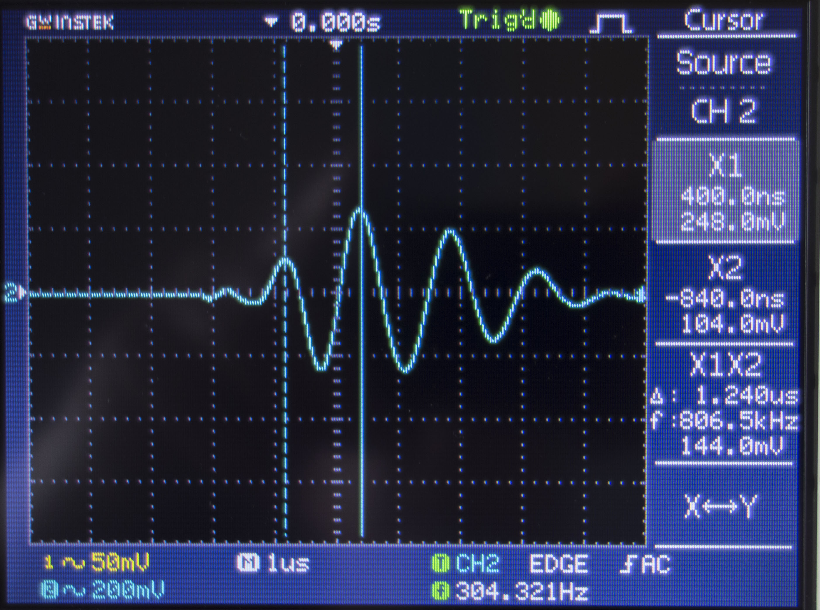

I could be wrong, but it might be you are getting this ringing as the diode turns off. The diode OFF capacitance rings with the transformer leakage inductance. The issue arises (I'm simplifying here - others will explain it better) because as the diode switches off, it essentially 'kicks' the tank circuit formed by the leakage inductance and the diode OFF capacitance so it rings at HF. You will see little HF oscillation bursts repeating at 2x your mains frequency - so 100 Hz where you are.
It could of course be that some other piece of equipment is causing this. Because the bursts are at HF, they couple straight across the average mains transformer where the pri-secondary capacitance is typically 500pf-1500pf (I've measured this BTW on some toroidal transformers)
If this issue is arising on your amplifier rectifier, you can fix this by wiring a snubber in using 0.1 uF (film) capacitor in series with a 10-22 Ohm resistor right across the AC terminals of the rectifier. Keep the lead lengths as short as possible.

It certainly seems that the damped oscillation is due to the interaction between the diodes and the transformer inductance. I found an article on Rod Elliott's site on "Snubbers for PSUs" which goes into quite a lot of detail. Have not had this problem before and it seems that my case is 'extreme' but this is the first time with this particular transformer. Rod believes that this 'interference' is not audible anyway (although I'm aware some say it is).
Using a ground lift with 100nf/10R resistor across 2 back to back diodes at the transformer side reduces the amplitude by a factor of 2 to 3 without any diode bridge snubbers.
Whether this damped oscillation really matters or not I'm going to be pedantic and do my best to eradicate it as best I can and let you know my final, earthed, PSU setup before I move onto the final act of testing the amp and listening tests.

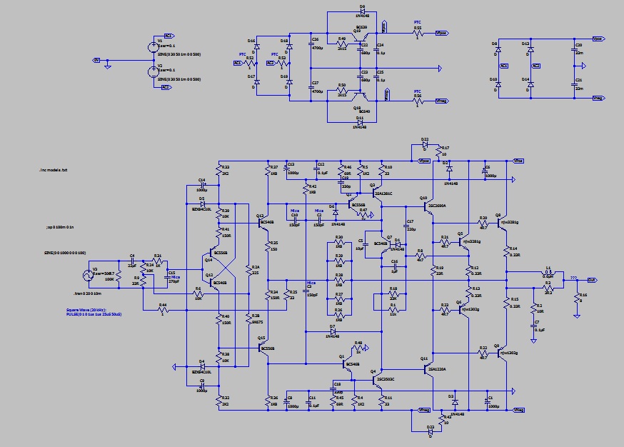

I just thought I would post a schematic of my complete setup (well, it does not include the transformers and soft start), this seems to work well too, with ripple eaters only for the front ends.
Please comment if you see potential issues/improvements.
Soft start is really simple: series resistor (6,8ohm 10W) on primary, and a relay to bypass it. Relay coil is connected via zeners to the rails at the smoothing caps, so the relay bypasses the resistor when the caps are charged to a voltage set by the zeners.

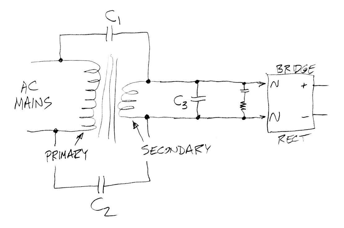

Bonsai, I think you need to include capacitor C3 in your amplifier and in your analysis.
C1 and C2 are the transformer's interwinding capacitances (with or without screen). C3 is an explicit discrete capacitor chosen by you and soldered to your circuit board. Quasimodo's design note makes a recommendation about selecting C3.
Notice that C3 forms a capacitive divider with C1 and C2, and so the RFI AC voltage on the secondary is less than the RFI voltage on the primary; its voltage is divided ... just as DC voltages are divided by a resistive divider. The ratio is:
{remember that impedance is inversely proportional to capacitance!}
If you choose C3 >>> C1+C2 then the denominator is enormously bigger than the numerator, and the RFI attenuation is also enormous. You get extremely little RFI on the secondary without an interwinding screen, and you get (extremely squared) RFI on the secondary with an interwinding screen. Benefit = high, cost = low, decision = easy.
- Vrfi_secondary = Vrfi_primary * ((C2 + C2) / (C1 + C2 + C3))
