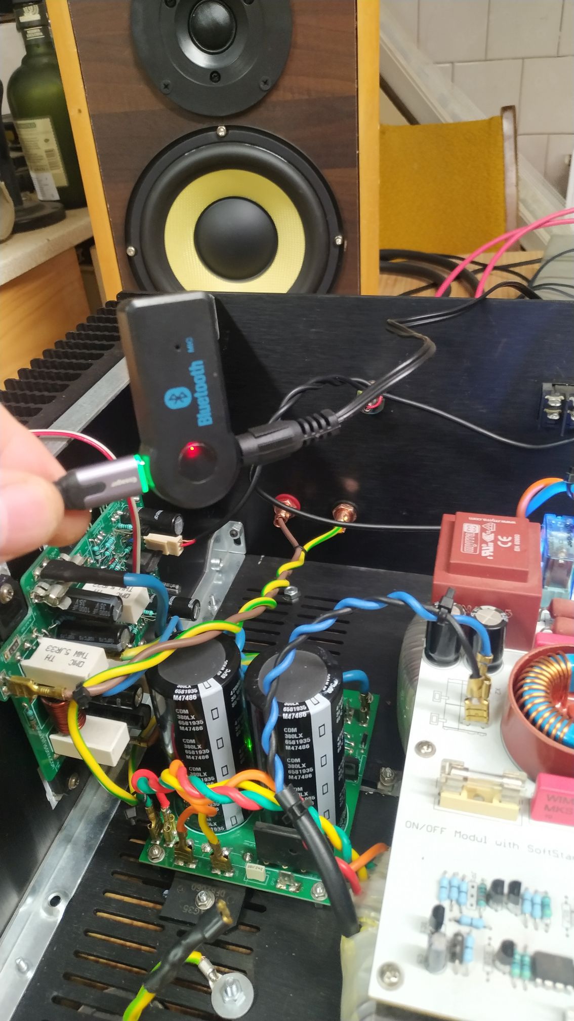

Hi Bonsai,
Thanks for the tips. I have just re-wired the Transformer to RE wiring using that large central copped ground between the 'secondary' caps as a star point.
The 2 amps are now connected (fairly crudely at present)
The 'cap bank' is not currently connected and the noise results are far better now with the news wiring 'harness' (< 500 uV with or without dummy load).
The 'damped oscillation' previously reported is somewhat the same but the shape is now irregular rather than 'classic'.
I've added a ground lift right at the transformer 0V output. Two 'back to back' diodes, 100 nF cap and 10 ohm resistor - all in parallel. This reduces the noise by 1/2 to 1/3 of the circuit without it. The RE earths are now left unconnected (was worried about ground loops if both RE grounds were connected at the same time)
Next step is to play around with snubbers at the transformer secondary and try and eliminate that 'quasi' (now) damped oscillation.
Anyway, currently looking better than it was 🙂
Will let you know how I get on.

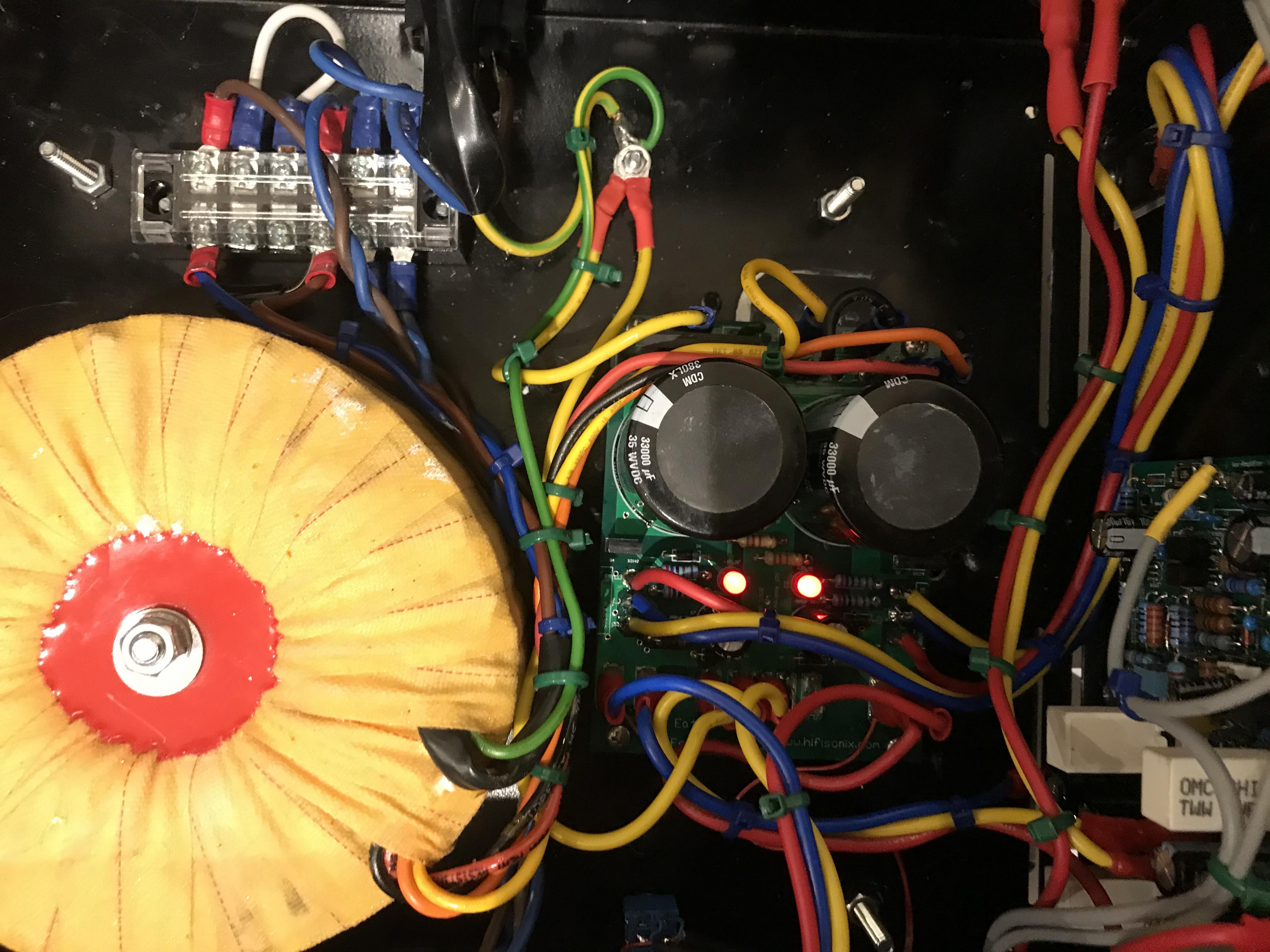

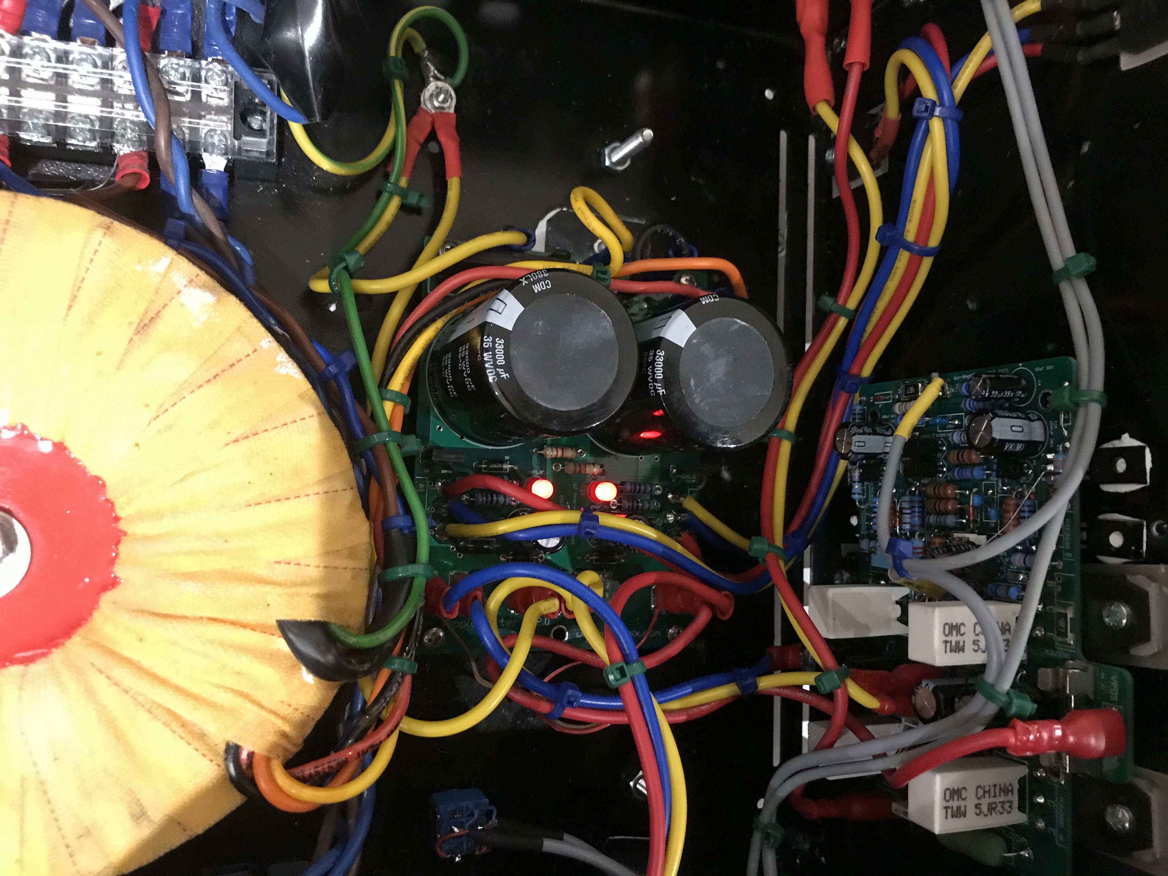

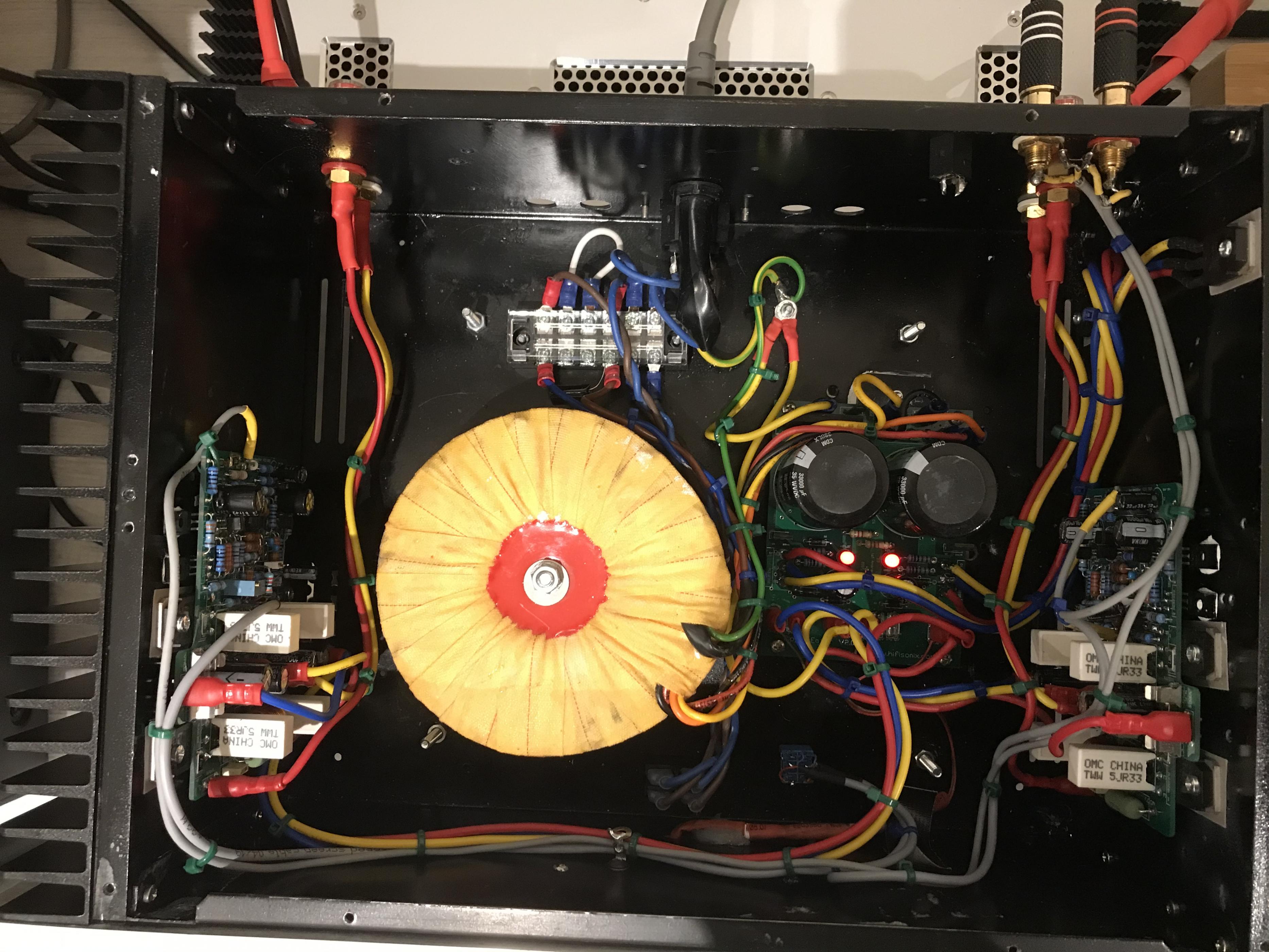

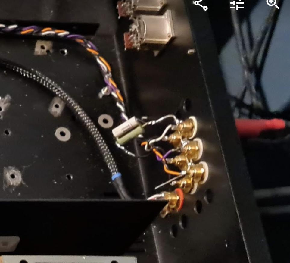

Bonsai, can you send a photo of your amplifier from the inside ??? And draw lines how you wired the ground and signals

If you connect just ONE channel from your CD player what happens? Is it still quiet?

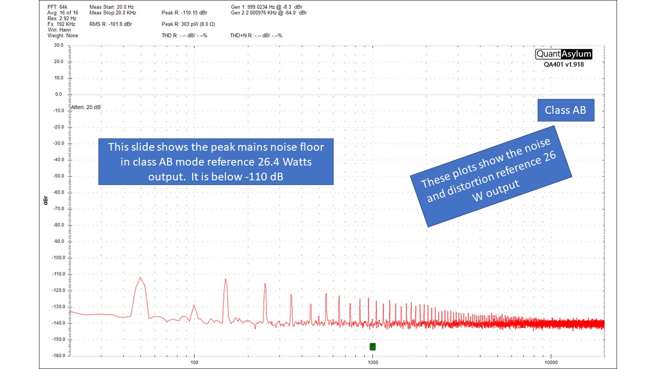

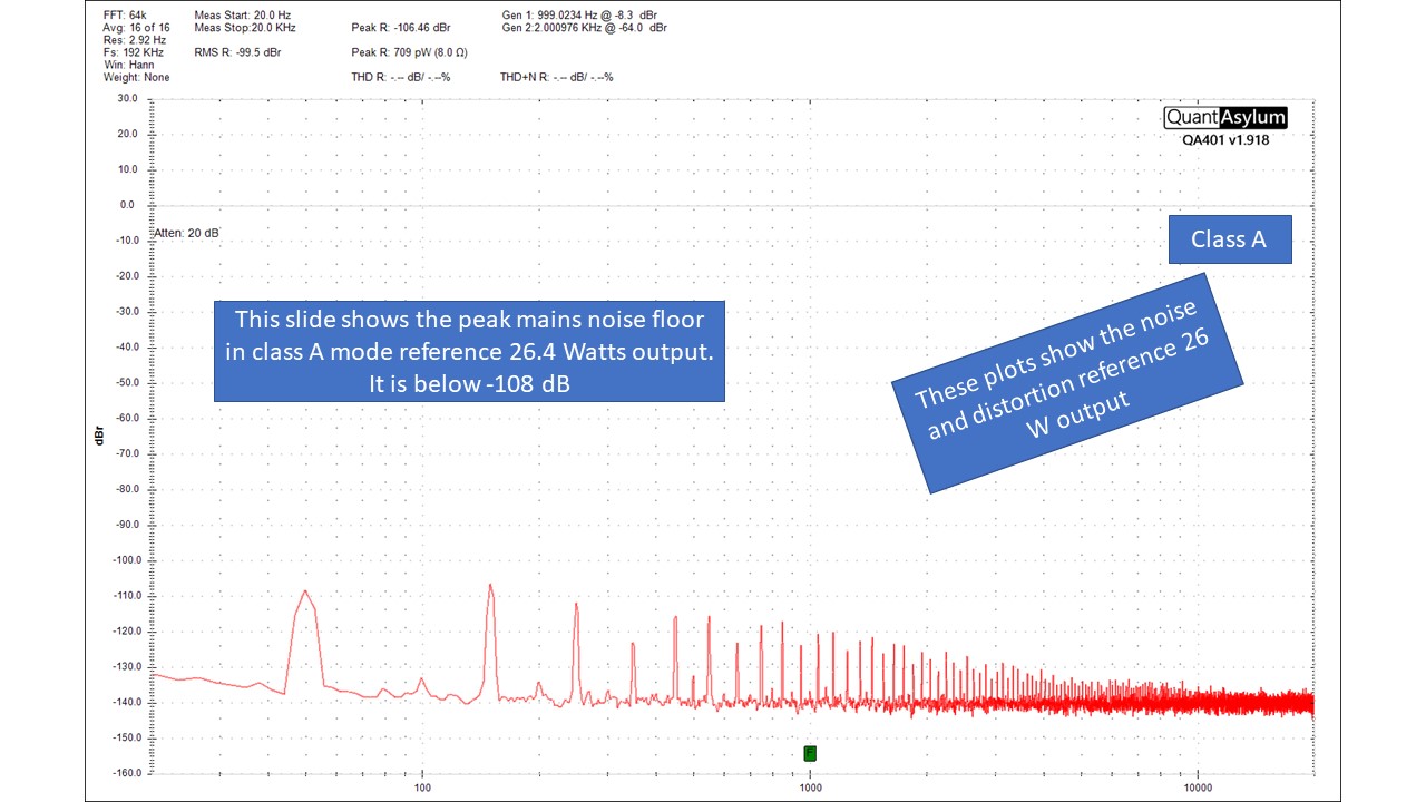

I will make a drawing and post it up. The mains noise floor on my amp Ref 26 W output is -105 dB in class A and -108 dB in class AB (just measured today).
I used a QA 401 distortion analyzer. The signal generator output was set so the kx-Amp delivered 26 W RMS into 8 Ohms (my supply railes are +-28V). The first 15 W RMS are in class A. Then I turned the sig gen off and this is the noise floor ref 26 W output.
Hi Bonsai. no,always hum.When I turn off the CD player from the mains then there is silence, or disconnect the RCA .
Thanks but i can't see the main frequency...
Do you mean that you took two measurements, one with input signal and the other without?
Plots are without any main signal.
Sorry but it isn't clear for me, what i missing?
To find the noise reference level I drive the amp to full power into 8 ohms with a 1 kHz signal so that the peak output is at 0dB. Then I turn off the stimulus signal and the noise floor ref full output power can be read straight off the graph. There is no change (<0.5 dB) to the noise floor between full output power and no output.
If you are getting hum with just one channel from the CD player but no hum with nothing plugged in, then it sounds like an earth loop. I think I may have misunderstood your original problem statement. The usual rule for this is:-
1. Nothing plugged in and amp quiet - little or no common impedance coupling problem in tne PSU
2. One source lead plugged in. If amp is still quiet then there is no earth loop problem between source and amplifier. If there is hum, then there is an earth loop (check each channel one at a time!)
3. Two channels plugged in. If amp is quieter, there is no earth loop or cross channel ground loop or common impedance problem. If there is hum with both channels plugged in, there is an earth loop problem.
Start with #1 and work to #3
I will send you a drawing later today (cannot do it before then unfortunately).
In the meantime, please can you look at slides 68 and 69 in the Ground loops presentation (link in my signature below) that gives a step by step guide to debugging hum and also Ilimnzn’s notes here
