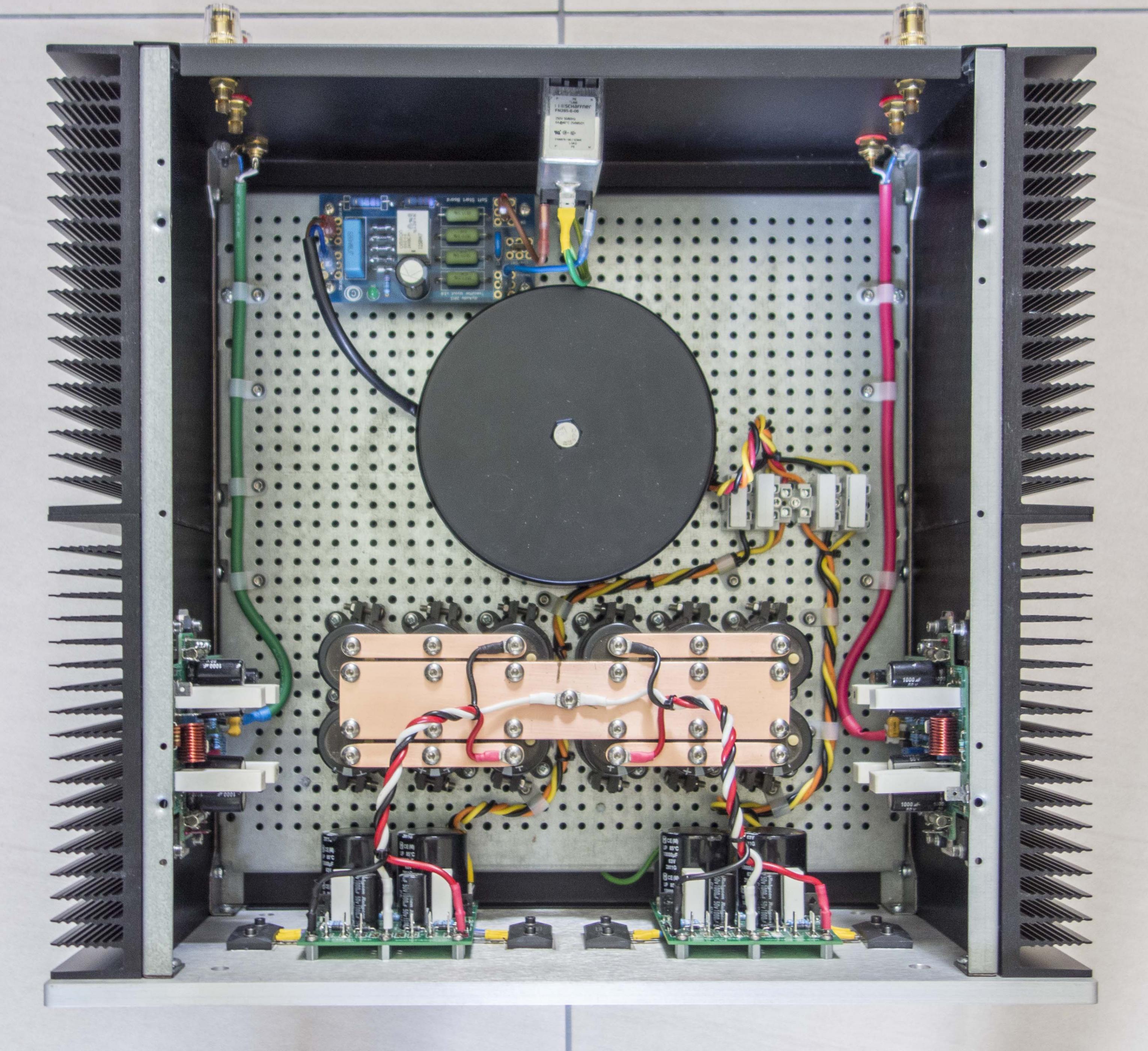

xK Amplifier PSU has now in chassis as per attached photo.
25-0-25V 500W transformer feeds 2 sets of secondary fuses, the outputs of which go to 2 Ripple eaters.
The Ripple eaters are then separately connected to 2 banks of external caps (3 by 4,700 uF 63V caps per rail). Note the output transistors of the REs have been changed from MJE to 2SA1295/2SC3264 (because I had excess stock of them) higher current/power handling transistors.
Now comes the power and ZN connections to the xK amps themselves.
Option 1:
Run twisted wires from the end of the cap banks to the power in of the xK amps. Problem arises on how to run the 'loan' ZN wire from the Ripple eaters to the xK amps.
Option 2:
Run the twisted power cables, along with the ZN wire, from the Ripple Eater's terminal themselves.
I would imagine that taking the PSU supply from the ends of the cap banks (Option 1) would be more desirable but then the ZN wire would not be wound - or just wound with the PSU wires for a short distance prior to the attachment to the amp power inputs.
Any thoughts/recommendations?

Rallyfinnen ,
Sounds like a simulation convergence issue you have and nothing to do with the circuit itself.
There are diodes around the cap multiplier that are designed to rapidly discharge the multiplier cap. In addition, since the load is high (2.4 Amps for a full class A implementation) the discharge time should be quite quick. Estimate it from it=CV so t ~ (100mf*25)/2.5 ~ 1 second. It will in practice be longer than this as once the front end voltage starts to drop, the OPS current also drops, so expect 5 secs or so practically.
With a typical brown out, you get a mains voltage dip for a few cycles. The kx-PSU (straight or cap multiplier version) should handle this ok since the filter caps are big (47 mfd per rail).

@polsol
Looks very neat!
Did you not move the output zobel to the amp boards? If you do that there is no complications, and you can go for option 1.
It looks like you have the ground connected to the center point of the big cap bank? Usual recommendation is to put a 'tab' to the side where you connect it to avoid the pulse currents from the rectifier pulses passing between the caps, but since you have the ripple eaters before, there should be no serious pulses, so I guess it's ok in this case.

Thanks Rally.
Nope, the Zobel is still on the ripple Eaters. Trying to keep it neat.
The 0V line (orange wires) from the 'fuse box' goe to the '0V IN' on the RE (separate lines from the fuses to each) the '0V' out (white wire) of each RE is taken to the central point of the large cap bank 'busbar'.
In other words the '0V' is a straight line connection from the fuses, via the REs) to the central cap bank position.
Similarly the AC lines (Yellow and Black) from each fuse box go to the 'AC IN' on the REs and the 'DC Out' lines from each RE to the centre on either side of the cap bank (Red and Black wires).
The ground/chassis earth is connected to the chassis below the mains input RFI and then fed under the inner chassis panel and connects to one RE 'Earth Point' only to prevent any possible ground loops.
In other words the '0V' line of the cap bank is raised over the mains earth by the second bridge rectifier into the RE above the chassis/ground - as per the original design
As you mentioned, I was somewhat worried about the cap bank ripple current if I connected the '0V' line from this central point to the xK amps directly. I'm not sure one could call it a 'star ground' where it's placed.
Cheers
That was my point about the central point of the cap bank, the general recommendation is to have a T-shape and connect the 0V on the end of the T to avoid the ripple currents going between the caps. But, in your case ripple currents should be almost 0 since you have the ripple eater before the cap bank.

"Option 2:
I would imagine that taking the PSU supply from the ends of the cap banks (Option 1) would be more desirable but then the ZN wire would not be wound - or just wound with the PSU wires for a short distance prior to the attachment to the amp power inputs."
_______________________________________________________________
Just twist the ZN with the +- and 0V. Then continue the ZN over the cap bank 0V and on to the PSU and terminate it on the ZN Tab connector. By keeping the ZN wire close to the cap bank 0V and twisting it with the +- and 0V from the amp module to the cap bank, you are minimizing the loop area. It should be ok. If not, you may have to move the Zobel onto the amp board. But I'd try it like I am suggesting.
You can easily check that everything is ok by looking at the output with a scope and feeding the amp with a c. 1 kHz sine wave so that its swinging about 70-80% of the rails. If its unstable, you will see it break into oscillation near the peaks. The other thing to do if that is ok is to drive the amp so it clips and check that it exits clipping cleanly without ringing. Finally, inject a square wave on the input so that you get about 2Vpk-pk on the output. The square wave should be clean without overshoot ringing, remembering that this is a TPC completed amp, so you will get overshoot but its critically damped so there is no ringing.
These tests are not exhaustive, but will expose loop gross compensation problems and OPS/VAS parasitic oscillation issues.
Beautiful construction job BTW Tony!

Thanks Bonsai.
Thus far I have the 'construction' with the A/C fuses feeding the bridge rectifiers on the REs and then on to the Cap Bank as per previous picture.
Amp A
Connected to the end of the Cap bank power with straight wires, ZN connected to the RE. Input shorted.
Amp B
Connected directly to the RE (power and ZN) using tightly twisted wires. Input shorted.

Not sure if you are referring to me?Can you post a picture?
Unfortunately I've already 'pulled the wires' whilst experimenting.
Otherwise it's the same as post 667 picture with straight wires from the cap bank on the left side plus a single wire to the RE Zn ('Amp A') and twisted wires (including the Zn connection) from the right RE to the 'Amp B' board as per 'standard'.
