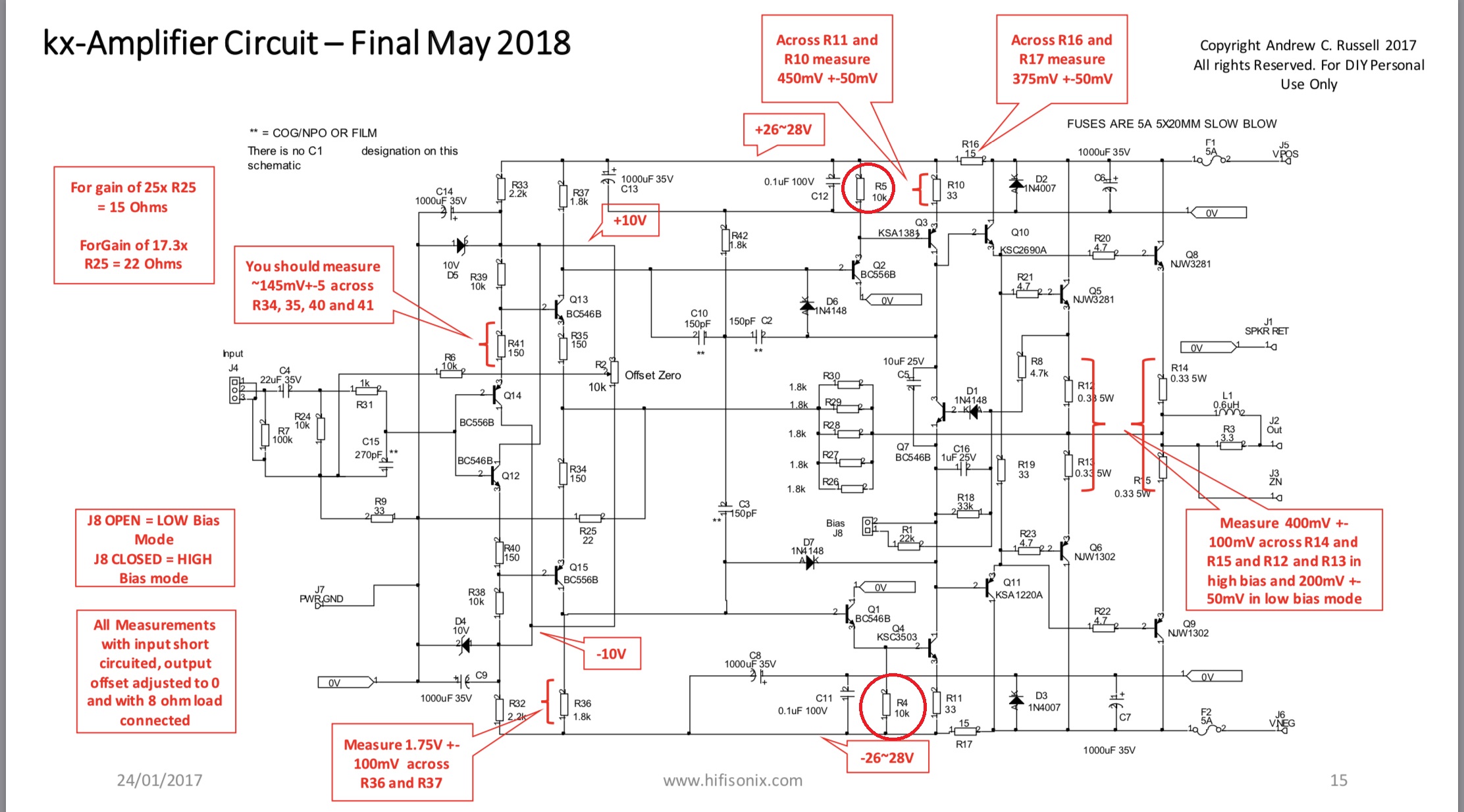

I’ll update the first post later tonight with changes to address the issue a few folks have had with 20 MHz oscillation.
If i'm reading it correctly, changing R4-5 should solve the oscillation too, without the extra RC? Is this based on simulation or has somebody tried it on an actual amp?
Since I did the RC first, I don't know how it would react to just changing the value of R4-5.
Do you see any downside to leave the RC in, I'm just thinking if I should remove the RC?

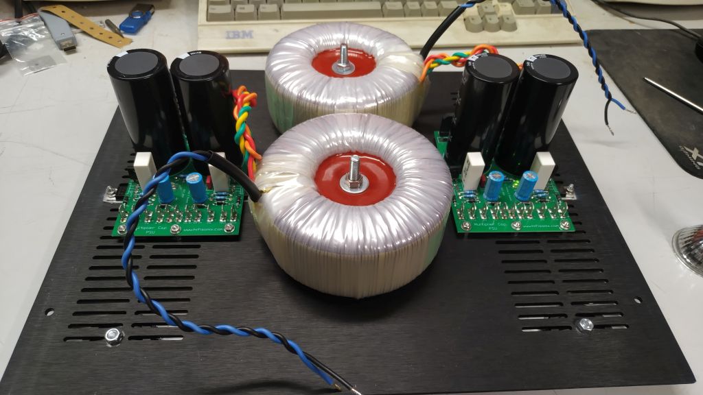

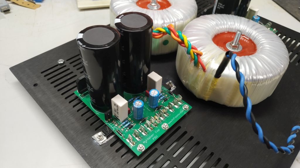

I have started making a chassis for my amp. I intend to use make enclosures for the power supplies and amps.
I gave myself lot of extra work because I recycled the heat sinks. They need to be sand blasted and re-painted + the other metal work on the rest. Very different from soldering and measuring 🙂

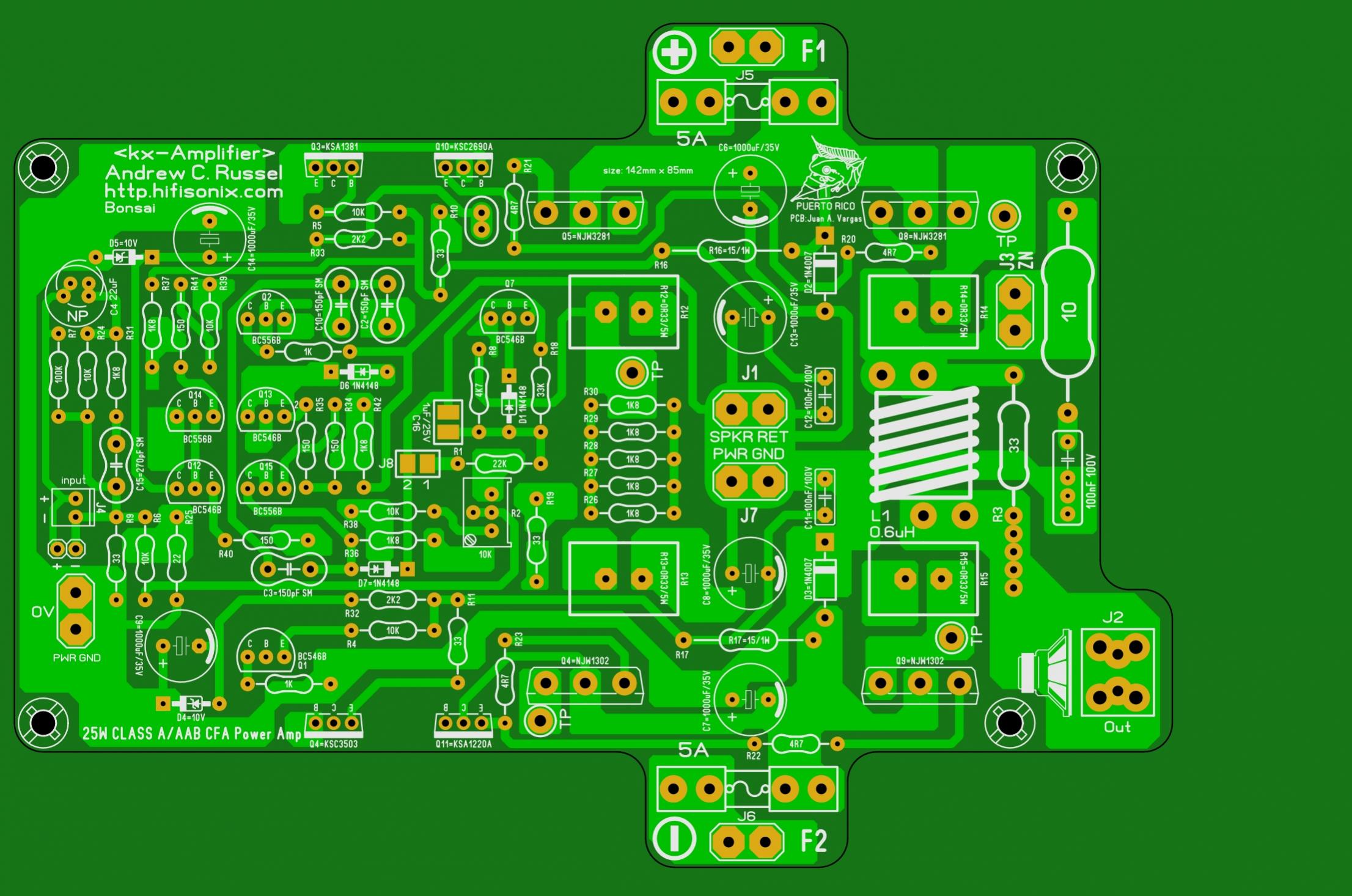

Yes. In the collector of Q1 and Q2 add a 1 k resistor. Keep the resistor close to the collectors.
Change R31 to 1.8 k.
Across each 1000uF cap add a 1uF 50V 1206 SMD capacitor.
Suggest you also put the Zobel on the amp board. Use a 10 Ohm 5 W metal oxide resistor and 0.1 uF 100V film capacitor.
(When you are finished, I will take a look at your layout for you if you like)

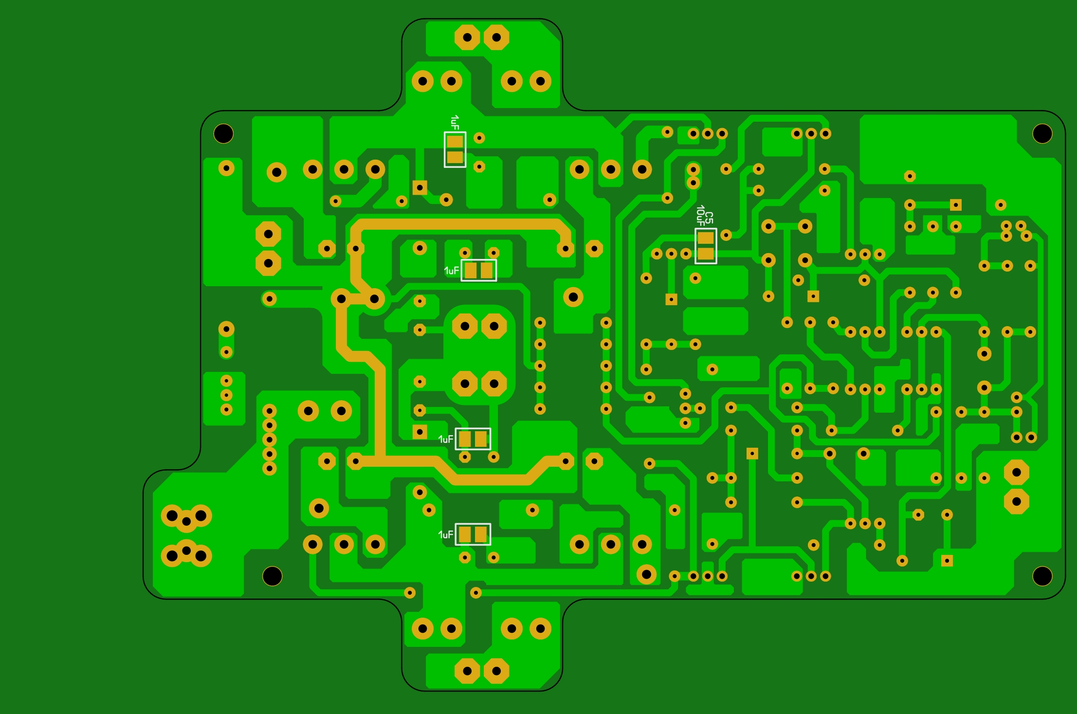

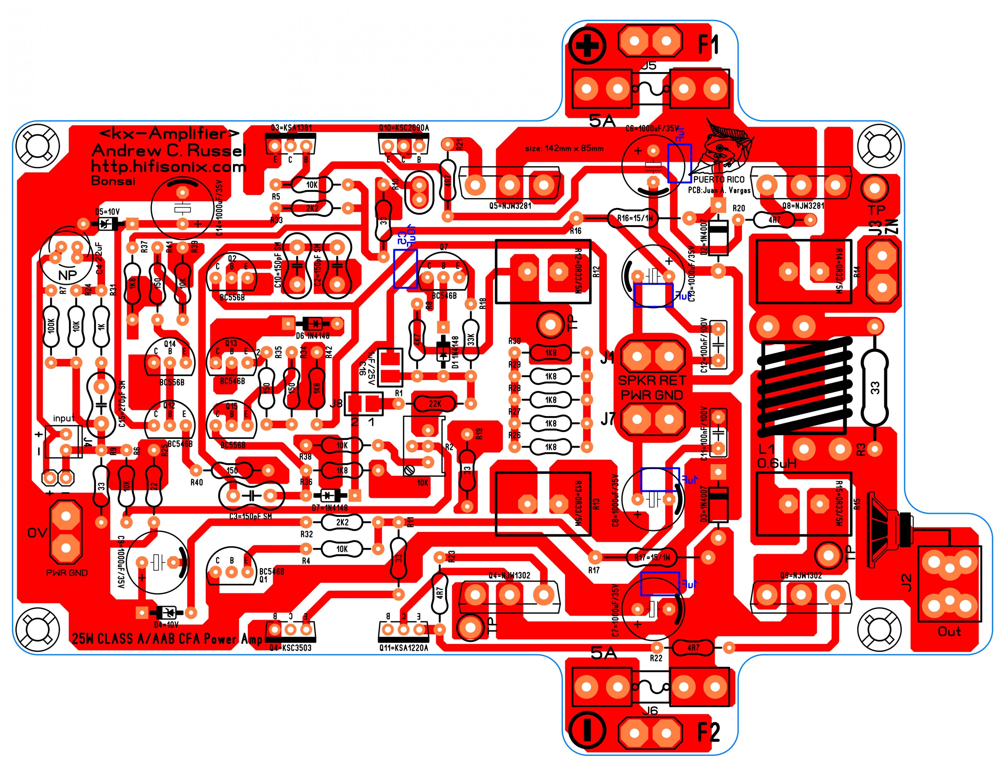

hi Bonsai did you check you messages? anyway here is the link of the Sprint Layout 6 file archive kx-amplifier Sprint Layout 6 file - Google Drive
let me know if you got the file 🙂
I add the SMD caps 1uF 50V to all electrolytic caps, also I add the 1K to the collectors of Q1 and Q2, about R4,R5 I don't remember if the values were changed 😕
oh I forgot the 10R and the 100uF 100V caps is on the board now 🙂

I'm on hold with my build, waiting for parts. I decided to order a pair of Toroidy 250VA 2x22VAC transformers for it. After I get the transformers I can continue building the chassis for it. I'm also waiting to get the heat sinks painted by a friend.
Have done some other stray projects while waiting, but now I'm stuck again, waiting for parts to fix a high power mono block I bought in non working condition (other one works though).
I got a de-soldering station as x-mas present for myself, and that one failed the second time I used it and had to be returned too, so more waiting..
Seems deliveries take more time now with the holidays, and then there is the corona too of course.
