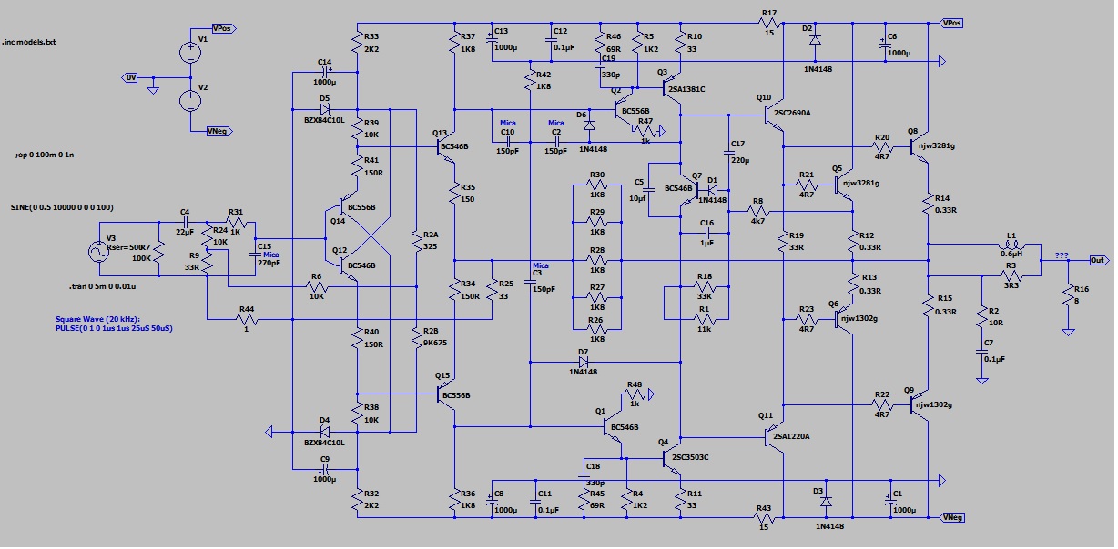

Here's a quick and dirty model to demonstrate HF noise coupling from a SMPSU like a wall wart. In this example, the burst ringing is at 11 MHz at c. 15us intervals - if the leakage inductance L1 is reduced or the diode capacitance is reduced, the ringing frequency will go up.

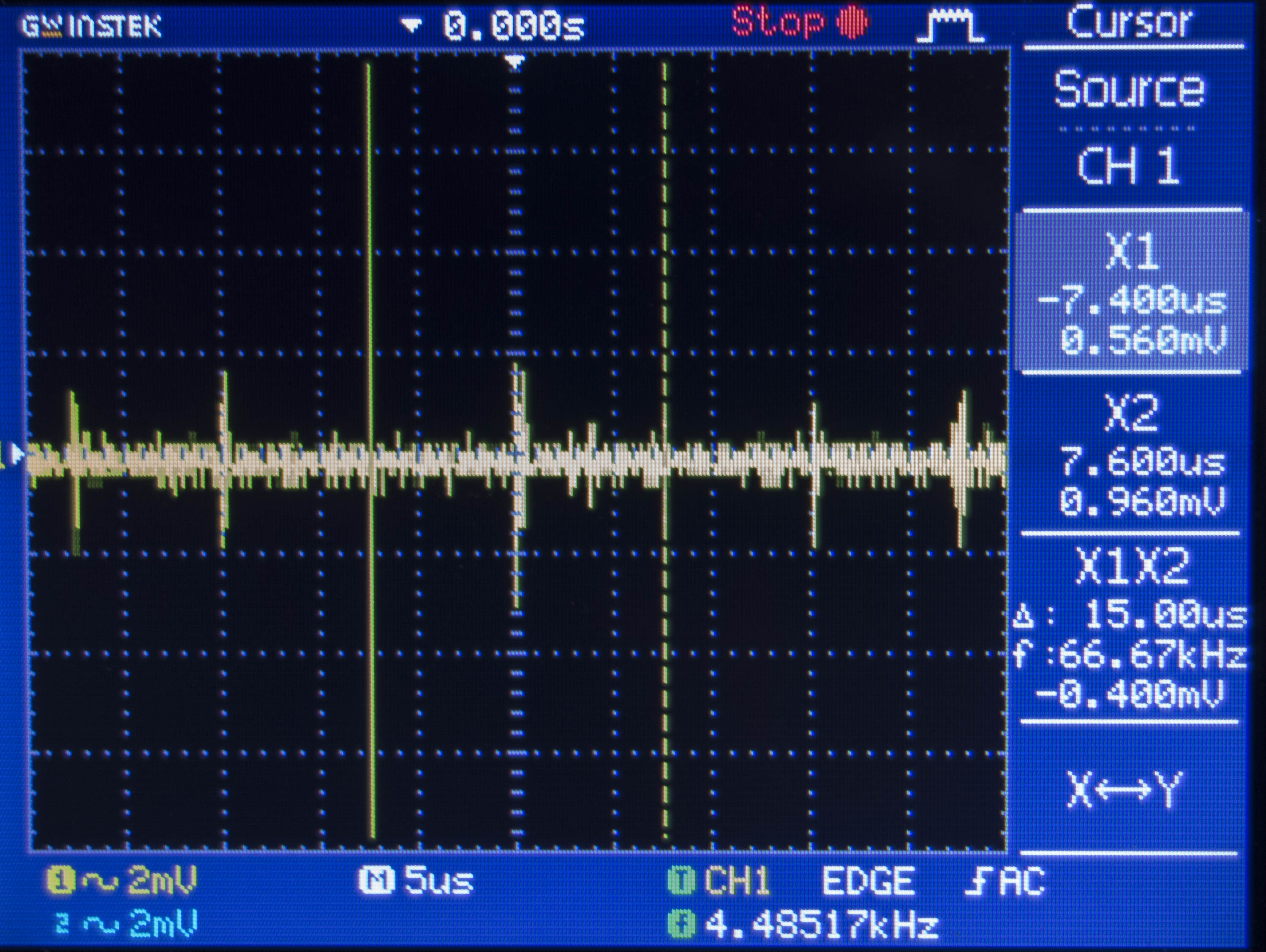

Hi Bonsai,
Is the attached Pic what you're looking for?
Time between 3 pulses is 15 uS ergo 7.5 uS between two (as per cursor positions)
Not easy to capture as they peak and fall quite a bit - averaging doesn't work so I had to use 'single shot' a few times to get something half decent.
If it's a 'wall wart' going to be fun to find as we have plenty plugged in all over the house 🙁
Cheers and thanks for all the help.

Looks like SMPSU noise. The frequency is in the ball park as well (might be a standard push pull forward converter with CT transformer so you’re getting the pulses 7.5 us apart. The different magnitude of the pulses tho seems to support this conclusion - seems to toe in with the UPS thing also.

Moved the scope to the dining room (I know the plugs there are on one circuit) and got a different waveform varying form around 2 to 7 MHz.
Bypassed the surge protector bank that the scope is normally plugged into and found no difference in my office/workshop.
Today I'm finding that the main pulses are measuring 10 nS between them rather than 7.5 nS yesterday - but there are now more 'spikes' around at other frequencies than there was yesterday.

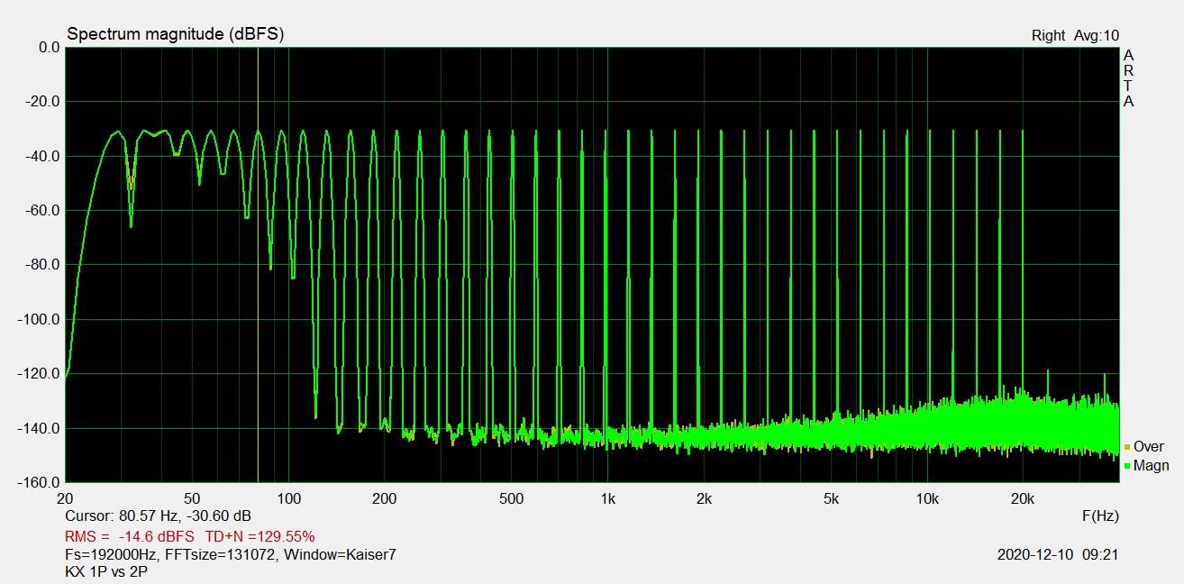

I have the boards complete again, and added 1k resistors, silver mica compensation caps, tried a 1W carbon film resistor for R25, 'audio' input caps.
I tried measuring distortion with and without R42 (1p vs 2P comp), but cant make out any difference using my (slightly worse) Asus sound card, so I guess that could be a choice based on listening preference.
I made the measurements 'worst case' using low bias, 3,5ohms load, and fairly high output level, to be sure it's going out of class A operation. To my thinking, this would make the compensation in the feedback more critical, since there are more distortions to compensate.
Below is an example of the multitone test.
Feeding it square wave I see no signs of instability with or without the R42 resistor. Only a very small and rounded overshoot without load with the R42 resistor connected. This slight overshoot goes away with load connected. Overshoot is not present without it (1P comp).

That’s great Sam.
Mine is still on the bench - unfortunately I don’t have the problem so I’m still digging and modeling to try to get to the root cause of this.
Anyway, enjoy your amp and sorry for the hassle.
When I have a break through, I’ll post the details up here.
(Nice plot BTW)
