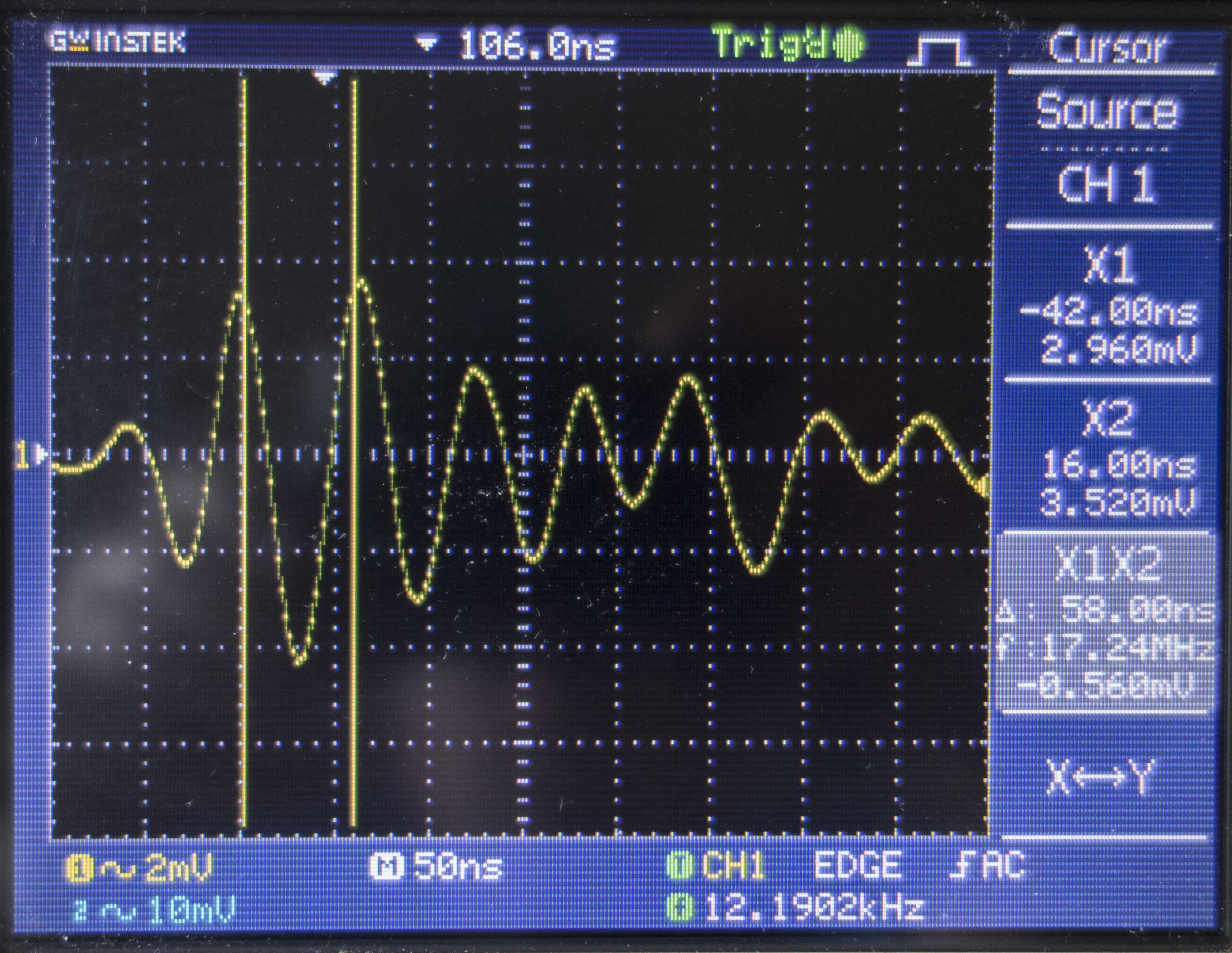

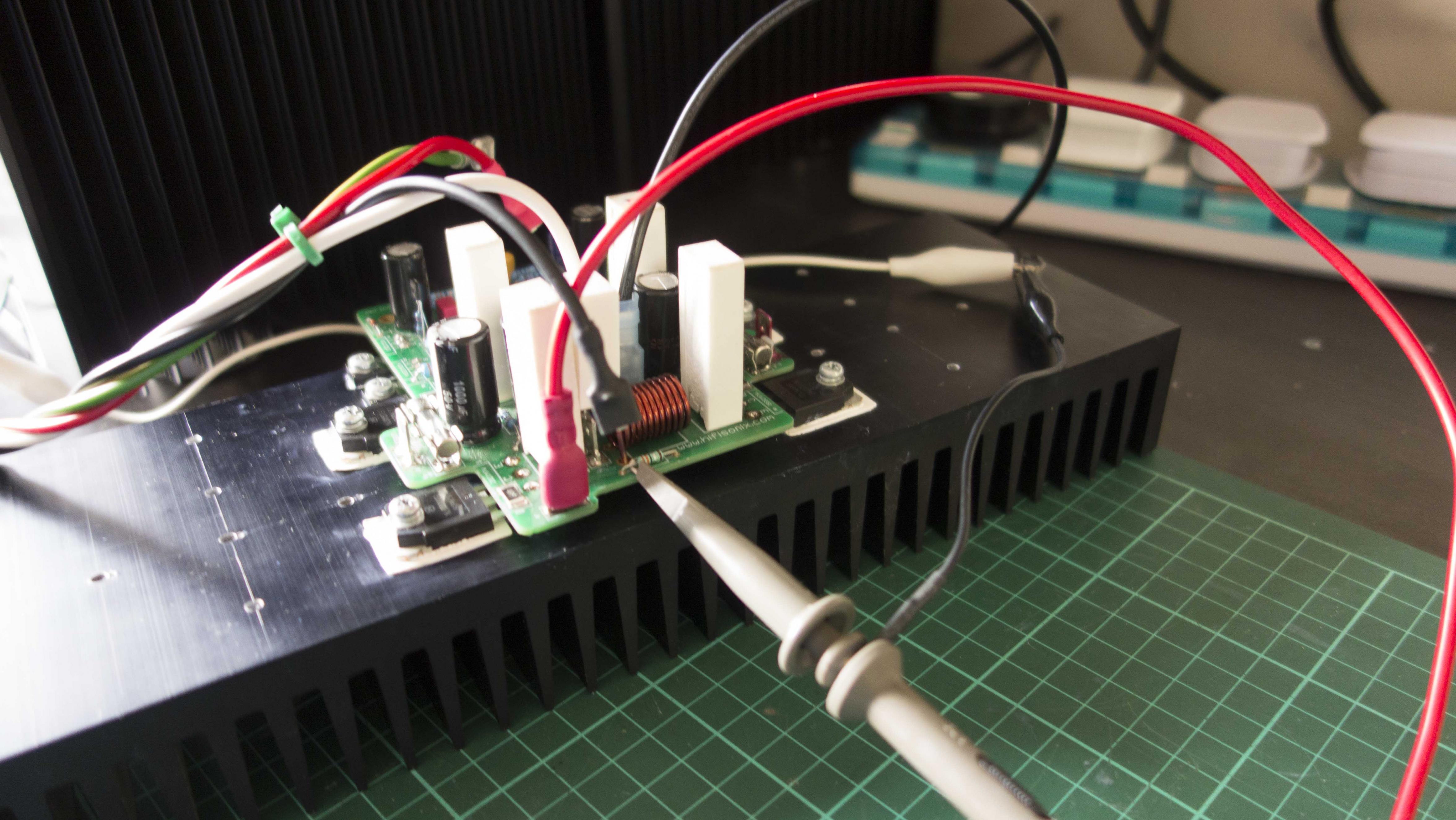

I've done some checks of and 'gunge' that might be floating around in my electronic work environment.

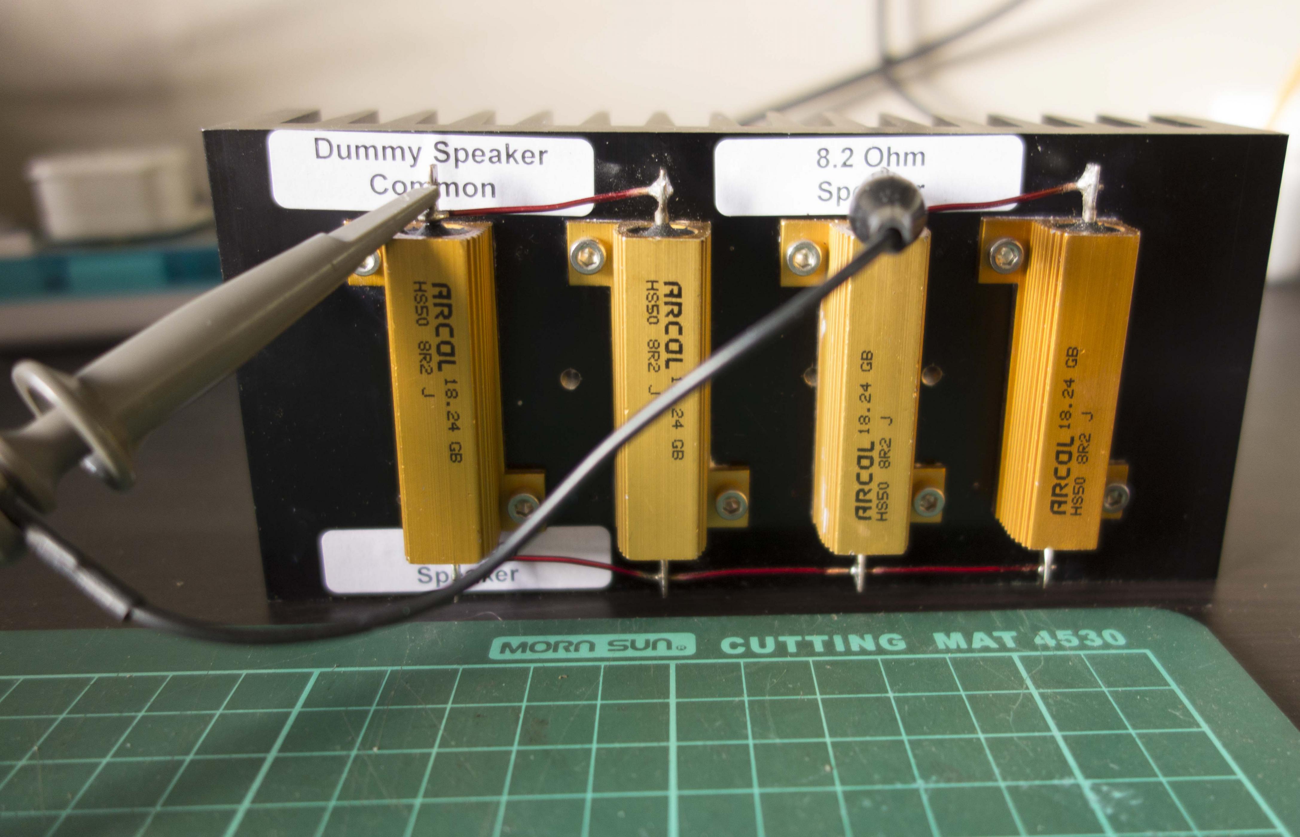

To this end I attached the scope probe to the amp output and the earth to the heatsink. the power leads (±) were disconnected but the xK amp ground (i.e. 0V) left in place.
The pictures below show the set-up of the probe to kX amp and resulting 50 nS waveform.

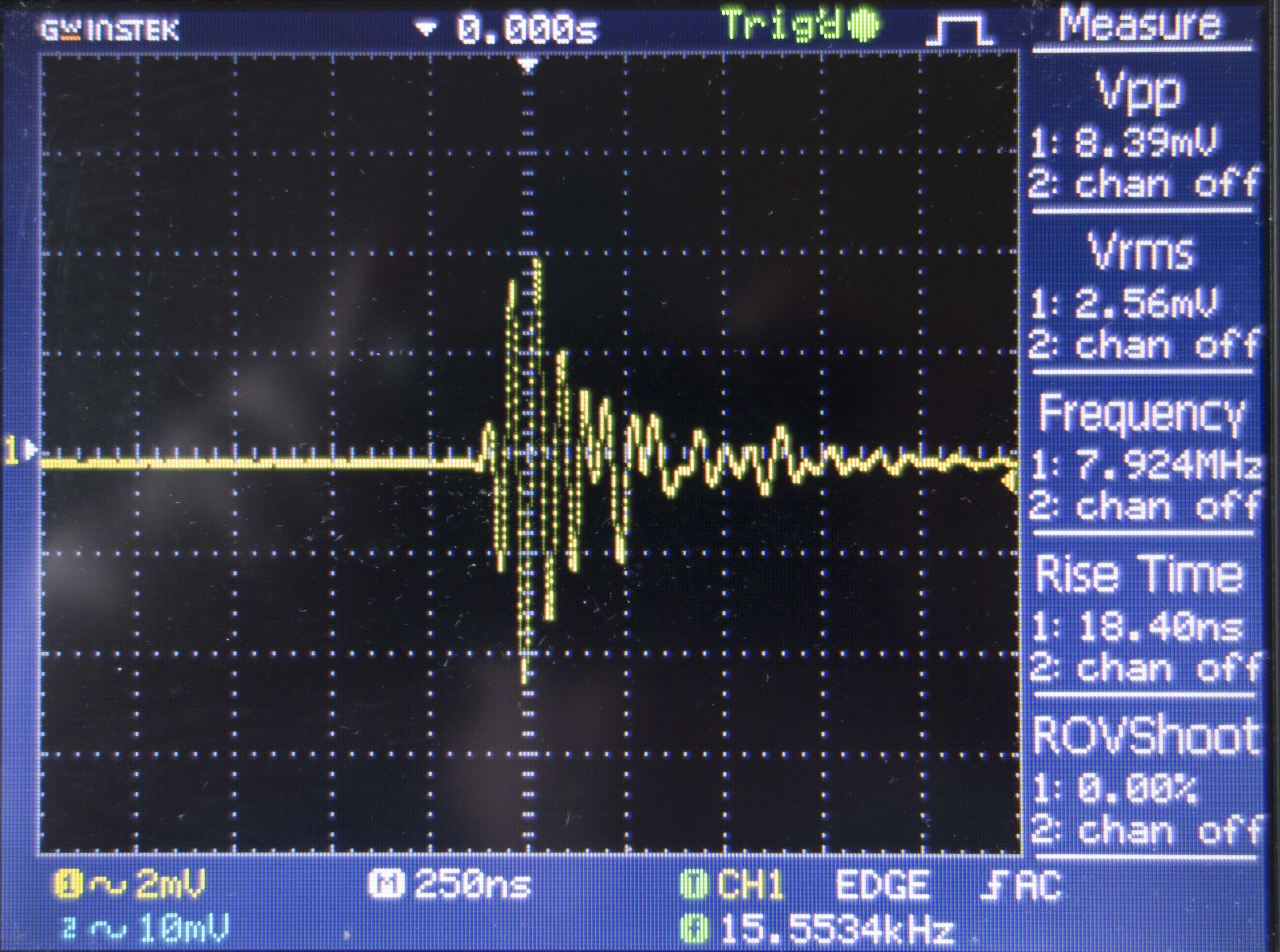

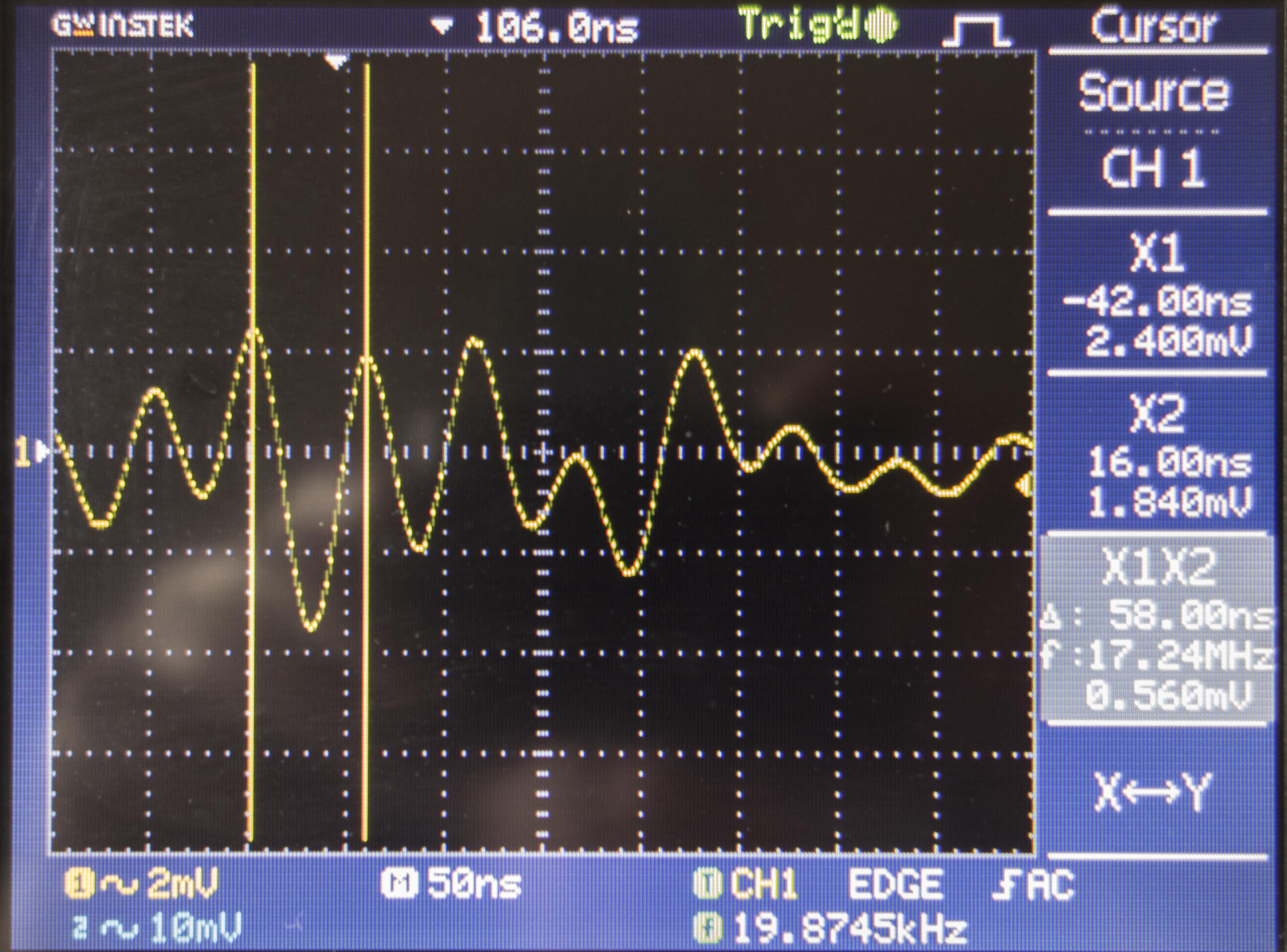

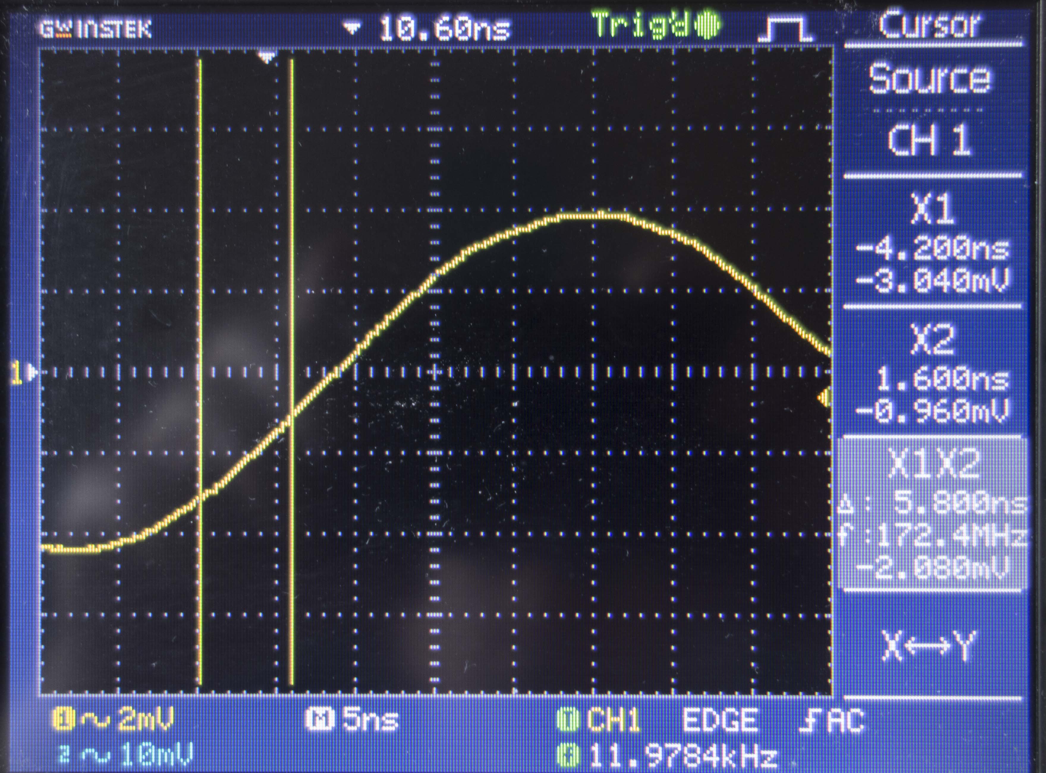

Based on this I simply attached the scope probe to the dummy load and get a very similar waveform which I've recorded at 5, 50 and 250 nS to get a better idea of the 'pulse' shape.
All the equipment (amp plus scope, frequency generator et all) is plugged into the same 'multiplug' which has a protection system. Other than the scope and amp all other equipment is off (including the amp PSU) except for the TV above this setup (I tried turning off the TV previously but it made no difference).
Any idea where this pulse might come from? i.e. what's generating it?
Could this waveform be creating/initiating the amp oscillation because it is almost identical frequency?
The probe itself was set at 1:1 and shorted was simply a 'flat line'.
Scope acquisition was set at 256 averaging

I had some similar 'oscillating pulses' at work. I'm not sure, but I think the scope has a switched supply that was somehow generating this, or there was some other switched supplies nearby for computers etc around (it's a a bit messy). Very low level, but disturbing when looking for those mV oscillations in the amp.

This doesn't look like the same problem Rocksteady has - yours is burst oscillation Tony, while his is continuous.
The only thing I can think of in your case is its rectifier turn off ringing with the wiring inductance and transformer leakage inductance, although its a bit high freq for that. You should see those HF bursts coming through every 10 milliseconds (100 Hz rectifier pulses). If they are, you can try a quick and dirty trick of a 0.05 to 0.1 uF cap right across the rectified AC terminals - its important to keep the leads short and right on the rectifier. If it is rectifier ringing, then you can put a proper snubber across the AC pins on the rectifier and that should cure it.
Might also be from your scope PSU as already suggested. Are you using a sign gen anywhere on your bench or any other mains powered stuff? LED lamp?
Rocksteady - you have a different problem. If you short the inputs, do you still have the problem?

Tony, if you turn the amp OFF do you still get the noise? I don’t understand the bit where you said you removed the +- leads - is this from your PSU?
Can you zoom out some more so I can see the time between the pulse bursts ie from one burst to the next? I’m getting the feeling your amp is not the problem here.
If you are getting these bursts from something external, or it’s line conducted, it will come right through the PSU - the filter caps, rectifiers etc will not block it due to circuit inductances and board capacitances as the frequency is very high at 17MHz.
If you unplug the PSU, but keep the scope connected what do you see?
I'll try and get some more components (SMD resistors + mica insulators) and do some more work today if I have time.
There is no waveform visible on the scope when the probe is shorted.
The scope for the amp was with PSU off and only the earth wire connected.
The waveform was also noted with just the scope connected across the dummy load as per the picture (amp PSU et al off)
In the first instance (amp) it might have pointed to earth 'garbage'
However the second instance (dummy load) would suggest it is a 'radiated' problem - although I guess this could be radiated from the earth wires.
When I first encountered this problem some months back I plugged in my JLH 15W amp within the same environment but there was no oscillation visible.
So I'll take the dummy load and scope to another room and see if the waveform is still visible.

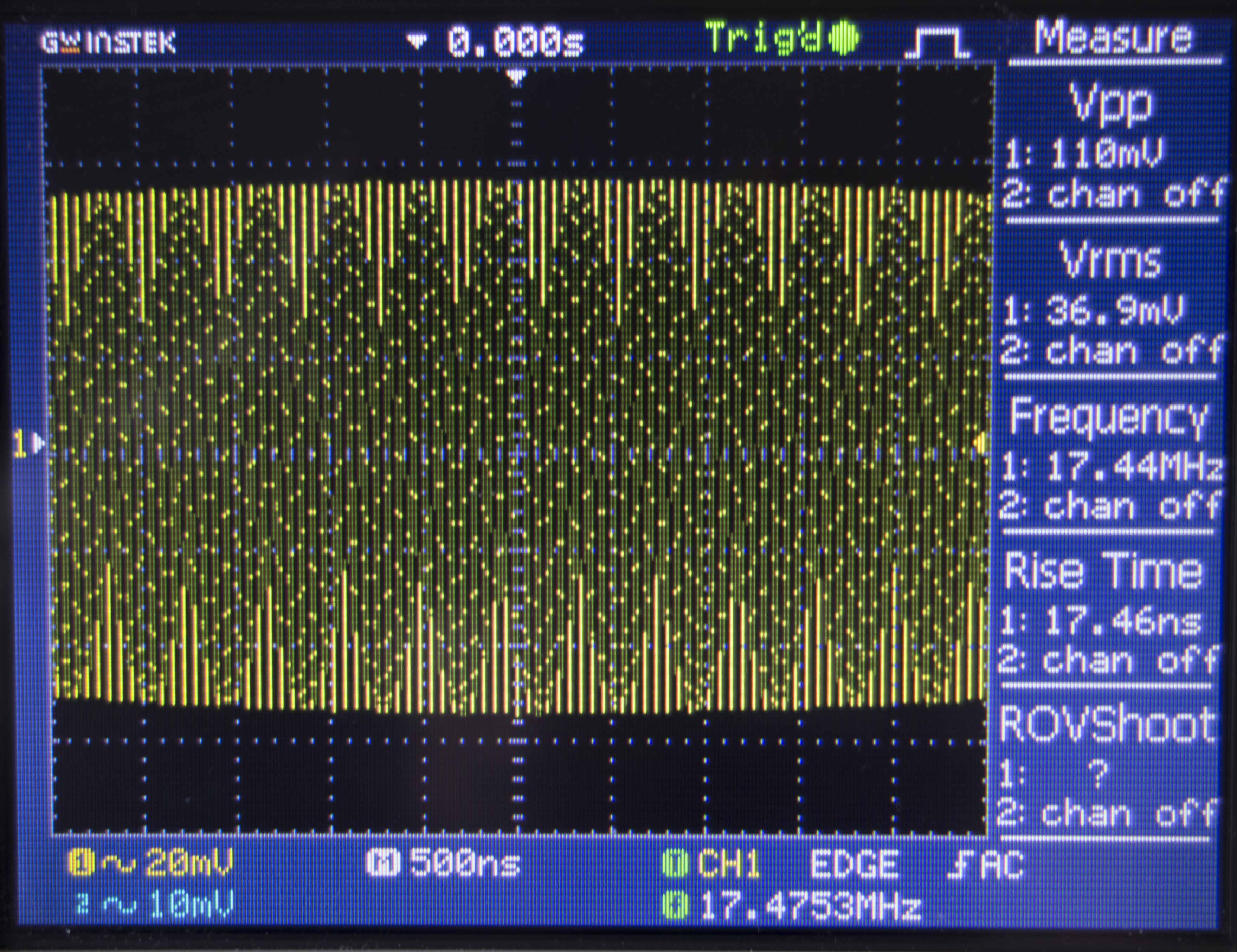

Meanwhile, attached is a 500 nS, time averaged screen capture from the kX with 'all systems running' for your comments

Problem is you have huge half wave pulses and that burst ringing is a few tens of mV at very high F and very short duration.
If you put a small resistor - say 50-100 ohms - in series with a 0.05uF cap across the rectifier terminals, you can pick up just the HF signal across the resistor.
But first let’s see what the noise source is in Tony’s case (then back to Rocksteady’s problem)
