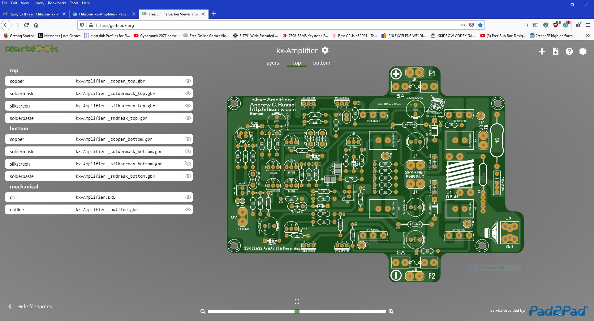

Bonsai you don't have the software Sprint Layout 6? ok ok, what I can do generate gerbers and use a gerber viewer software, give me a moment I'm gonna do that right now
ok here is the gerber files also I made a 3D image if you want to check all sides

hi Bonsai did you check you messages? anyway here is the link of the Sprint Layout 6 file archive kx-amplifier Sprint Layout 6 file - Google Drive
let me know if you got the file 🙂
I add the SMD caps 1uF 50V to all electrolytic caps, also I add the 1K to the collectors of Q1 and Q2, about R4,R5 I don't remember if the values were changed 😕
oh I forgot the 10R and the 100uF 100V caps is on the board now 🙂

Otherwise nothing else comes to mind with the original build although a purely 'rectangular' board might be beneficial without the 'wings' (Fuse/Line and the 'speaker out) connection(s)) extending beyond the basic rectangle.
polsol that can be changed of course I always try to give the PCB the best options possible example parts that can be accommodate better yes caps size fuse and other things the PCB that I'm doing is only for me to diy a similar design from the original is not to replace or to use of purpose of monetary gain "no way Jose!" is only for me to try out, if Bonsai check and is about fine or okay then I can tested and inform later in my time, like I said is not a replacement of the original design more like a modification update we can say I guess? 🙂
C4 on the PCB have already 5mm PD and 2.54mm

I think that a square shaped board would be easier too. I like to clamp the outputs to the heat sink, and without the 'wings' a single bar and screw in between each pair of outputs could have been used.
For soldering the fuse holders, I just put a fuse in them to line them up before soldering.
Providing better 'anchoring' of the output transistors is a good point that I hadn't thought of. I was more concerned about possible structural problems as 'fiberglass' does not have good shear strength and the 'wings' might be more subject to damage if too much force is applied (e.g. by pushing on or pulling off the 'fast-on' connectors).
I used the fuse inplace to solder on the SMD fuse holders. Works quite well but a little 'fiddly'.

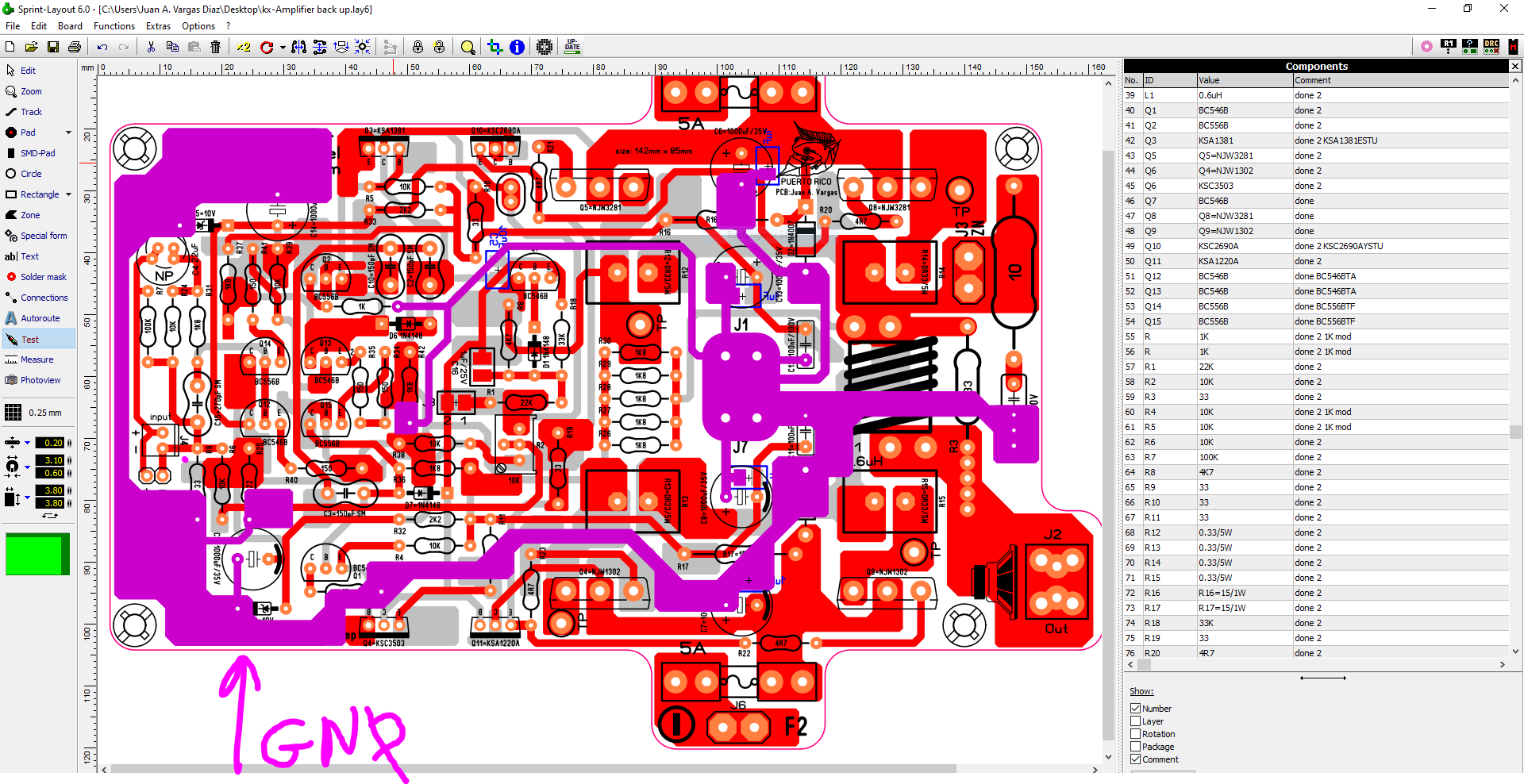

Hi vargasmongo
I took a look and here is my feedback
1.Try to move the 4 input transistor closer together - they should be almost touching. with good thermal coupling, DC offset drift will be minimized.
2.For the 33 Ohm HBR, I'd run a separate 0V track back to the speaker Return/Power ground connectors. Any mV ripple between it and the 0V will be injected into the input signal as it is now. Tun this track close to the existing 0V tracks to keep the loop areas small
3.Put top and bottom copper on the 1.8k feedback resistors to hep dissipate power - at full continuous power these dissipate 0.5W each - the copper will help remove heat
4.ALL connections to the Power ground must go to the power ground and NOT to the side where the speaker return is. The power ground is the star ground of the PCB. Even fractions of a milli-Ohm will degrade distortion performance.
5. The ground connection by the input side must be removed. If you use it, you will create common impedance coupling problems and possible ground loops
6. C13 and C8 connections must be made thicker
Otherwise, looks like a neat layout!
I will see if I can do those changes, thank you Bonsai
1. I might be able to do it sure
2. 33Ω I didn't understand what to do there "so it should be separate to GND?"
3. 1.8K feedback so copper top and bottom right? I'm not 100% sure here
4. is a bit confusing for me 😕
5. easy fix got it 🙂
6. C13 and C8 thick traces? ok ok
the traces for R9 33
here is the image of the top layout I remove the the GND connection
the pink highlighted traces is all GND star so it needs an additional separate GND?
is ok I'm gonna post after changes are done check and continue no problem thank Bonsai for checking the layout I'll keep posting as I go 🙂
2. Where the 33 Ohm HBR connects to ground - don't do it like this. You are mixing a power ground because you have large 1000uF decoupling capacitors on the power ground with 100/120 Hz decoupling currents flowing through the PCB trace resistance. This makes the heavy ground track a 'dirty ground'. Run a dedicated track from the 33 Ohm back to the power GND. Keep it close to the existing heavy ground. You only need a thin track -maybe 0.5-1mm
3. Yes - pour some copper top and bottom to help remove the heat from the resistors
4. You placed the spkr ret and power ground next to each other. Then you have 0V tracks returning that are joining on the spkr return and some on the power gnd return. Like this you are mix up high current and low current return tracks. Bring ALL the tracks to the power gnd side only. this creates a proper star gnd on the PCB.
