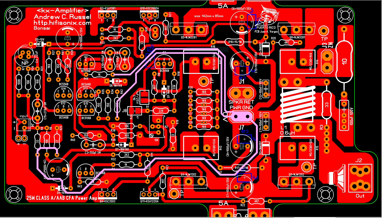

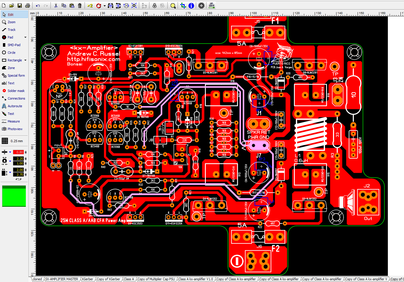

Hi Bonsai I made the changes on the PCB R9 33Ω now have it own GND trace to 0V right?
input transistors are closer from each other
R4,5 are now 1K
C13 and C8 have thicker traces
if you want I can post the gerbers later for one last check if need it
R4,5 are now 1K
R4,5 are now 1K
You've got it correct.
Only thing I would change is C13 - you still have the GND track going to the spkr return. Move the spkr return to the right and take the cap - track straight to the pwr GND. run the speaker return track then onto the pwr ground.
ok I'll do that I'm back later thanks Bonsai

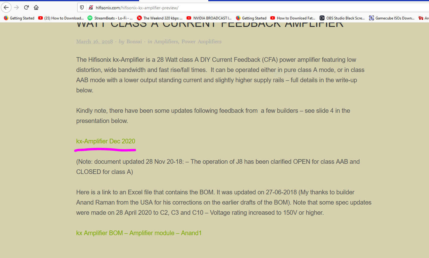

thimios did you check the updates on December 2020? I already check PDF page 4
