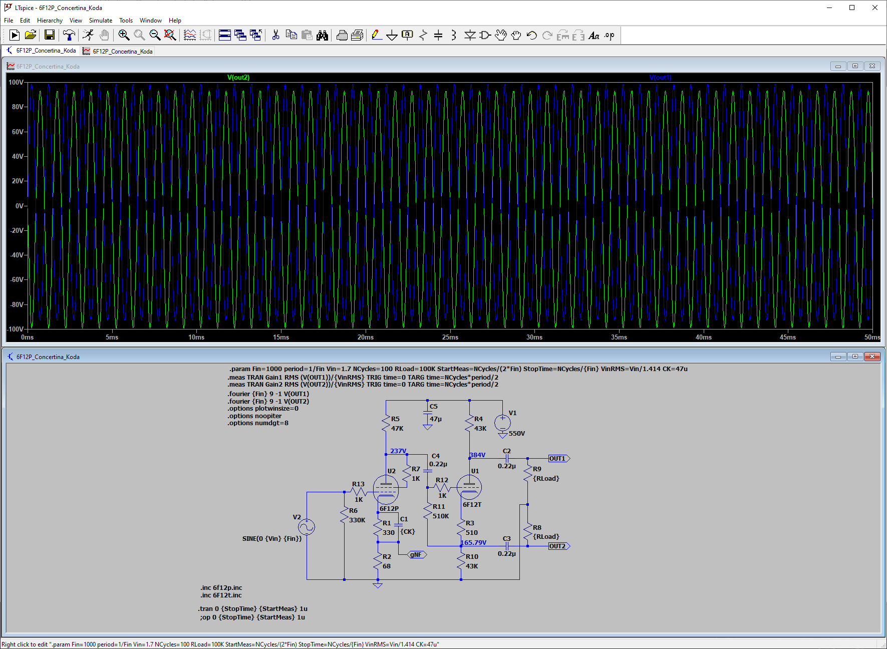

The swing problem is not resolved even using 500V supply . A cathodyne can't give you 200Vpp swing , or more , for 6AS7 cathode biased .
And of course you can't push it to the max with high distortion , or what is this , a contest for stinginess ?
One thing to remember is that for a cathodyne to supply ~200Vpp the first stage needs to supply 200Vpp.

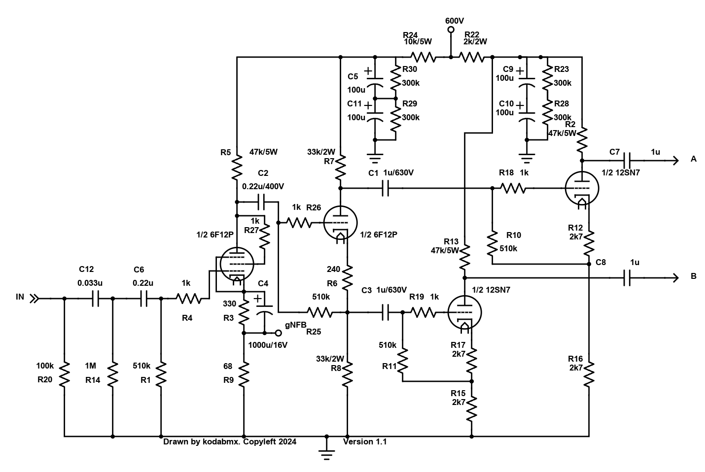

This is the typical setup used by @kodabmx in his triode-strapped TV tubes amps:
You can get there, but you need a ton of voltage.

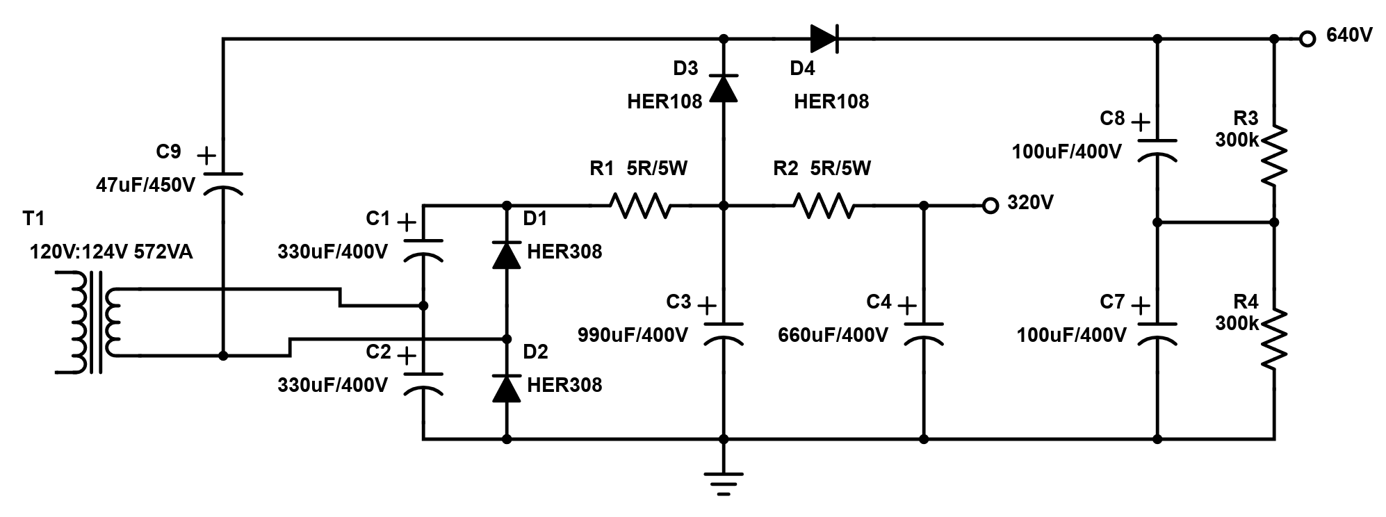

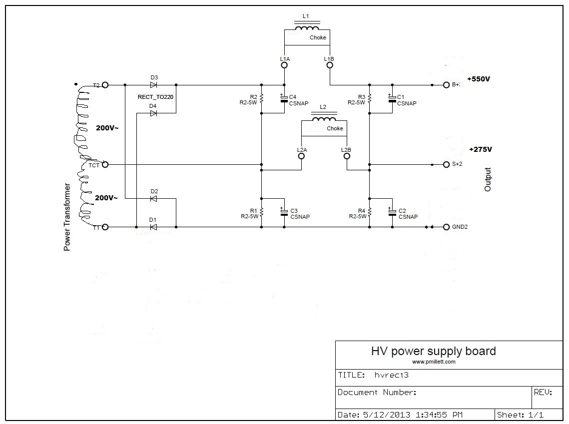

I love the cathodyne and prefer it in every instance where I can use it- but this is not the place for it. Unless you go for a Williamson front end and follow up with higher voltage gain stages it doesn't make sense to use it here. 90% of my amps have used the cathodyne- and of the dozen or so finished push-pull amps on hand that I held onto- all use a cathodyne.
Personally, if this were my project that for whatever reason I was required to make happen- I would grab a filament transformer- run it backwards off of the filament supply, and stack that on the plate supply for the differential and front end. Another ~120-150 volts rectified of headroom will make a huge difference here.

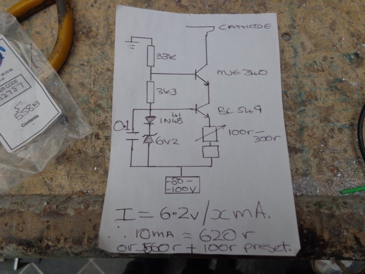

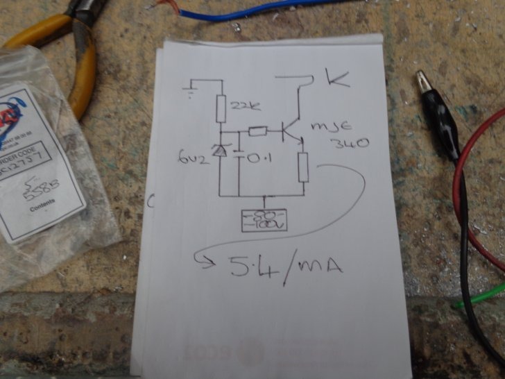

Think so, having trouble visualising that. A lot of amps use a tap off the secondary to power a bias supply, see - http://www.valvewizard.co.uk/bias.html I prefer a separate tfmr & bridge rectified supply, mainly because the negative V supply is ripple free & I get more Vout.
Re the CCS, I use the attached. I prefer using a MJE340 or BD139 with or without another transistor. The extra tranny gives a higher impedance but there's not much in it. I use Piher 500r presets with a fixed R for the emitter R and use 6V2 zeners. A 6V2 zener gives more adjustment than a LED. With a 6V2 zener Er is found by dividing 5.4 by what Ik you want. Remember for an LTP thats Ik x 2.
Hope that helps, Andy.
