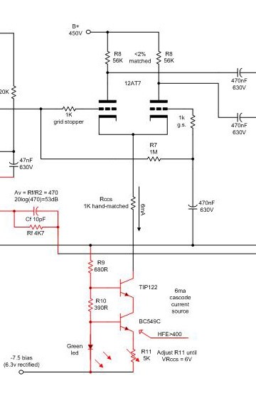

Yes, using the LM334 is possible to avoid the negative supply, but (as usual, there is a but):
1) It is borderline, the minimum voltage required by the LM334 is 1V, and with an input signal bigger than 0.5v it goes out of the working zone in the peaks.
2) I had to use a low current for the LTP in order to have a bias voltage of 4.5V to make the CCS work. I'd use a different tube with higher gm for the LTP, to have a bigger driving current while still having enough bias voltage. Maybe ECC88/6H23P.
Adding a small negative supply will make it easier to tune, and also use a simple bipolar CCS instead of the LM334.

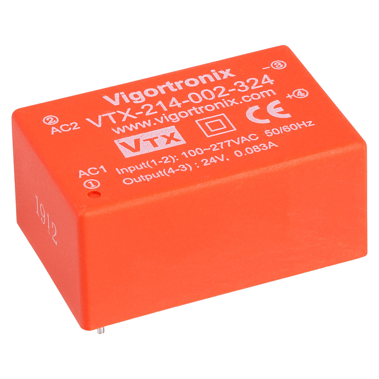

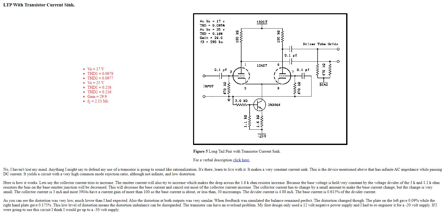

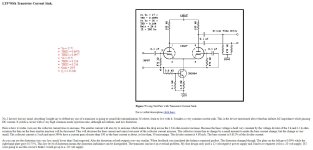

This is an interesting CCS for an LTP. Just uses a single transistor and produces a very low distortion level. It requires a negative voltage of -20v in the attached diagram, however the author suggests that -30v would yield a better design/result. Looks like I've only got -16vdc to play with if I have 25vac from the power Tx. So, that Vigortronix at 24vdc is looking attractive (there's a 48vdc version too....)
Credit for attachment: https://www.angelfire.com/electronic/funwithtubes/Amp-DB_Heart.html

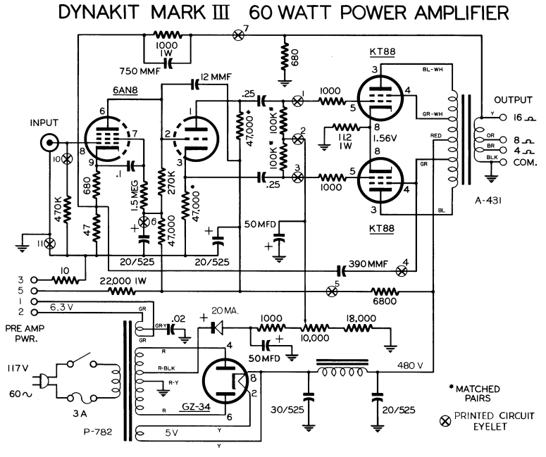

Here is a simple, well-known, efficient phase splitter design principle : 1st stage in direct coupling to a second stage in cathodyne phase splitter,
This principle was used in a number of amps, notably by Dynaco :
I used this very simple principle on many of my DIY amps with success... Stable and reliable, no time-constant, easy to NFB , not really tube-critical, low distortion due to the direct coupling of the 1st stage to the second (no extra-load to the plate, no phase shift, maximum gain available for the plate load) , and the distributed loads of the phase splitter (gain circa 1).

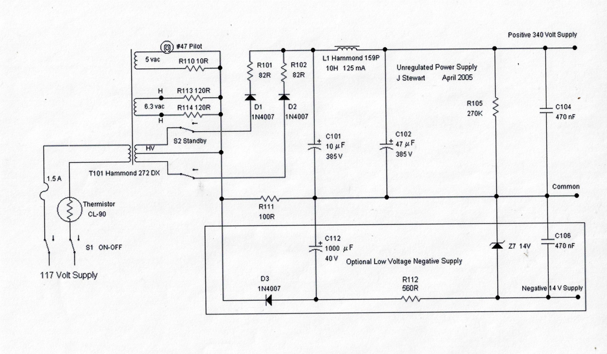

Here is a trick negative PS for an NPN drain on a diff amp I used a while back.
Current pulses across R11 the HV supply return lead cause pulses of voltage rectified by D3.
Those stored in C112, filtered by R112 & applied to the zener Z7.
Further smoothed by C105. 👍
