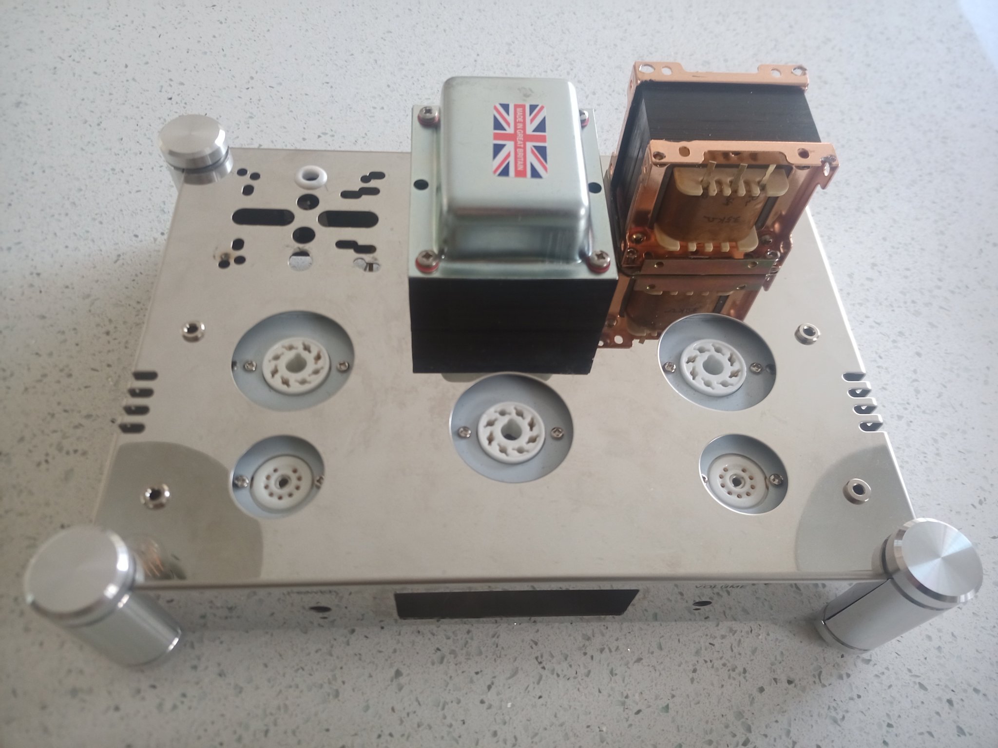

Hi - thanks for the suggestion. There is a limitation associated with my "pile" of 6N1P-EVs and that is the existing chassis. Photo below. Its a lovely chassis with mirror stainless steel finish. It's used in an EL34 SET usually, but I thought why not try a 6AS7G in there.Since he needs comparable high voltage swing he will need more than 290V Ub, thats a fact, so, in any case Ub has to be increased .

The Power TX is made by Primary Windings in UK, specifically without 5v winding as the intention was always to use SS rectification.
The OPT is a 15w PP at 3.5k. It's deliberately fitted "upside down" since it will have a cover over it (base carrier also fitted) and that gives me more space at the top to connect and route wires back underneath.
The chassis has had a letterbox cut out at the front to take a bluetooth/FM tuner/SD card/USB/Aux connection module to add versatility. I have already used one and I must say I was greatly impressed! Comes with remote control too.
So, I have 3 octal sockets and 2 noval sockets. Hence, one 6SL7 to provide pre-amp for each channel, a 6N1P-EV either side as phase splitter and finally 6AS7G for PP power stage.
PS - that chassis is nearly impossible to work on. I had to drill two new holes for the OPT cover base and you can see how even a cobalt drill bit just work-hardened the chassis on the vacant side. I got there is the end...

Ok, than there really are not many options left, use a LPT and prop up the Ub with the fullwave doubler/zener arrangement I descriped earlier. If you need some more swing (headroom) than the 6N1P can deliver, a E182CC can.Hi - thanks for the suggestion. There is a limitation associated with my "pile" of 6N1P-EVs and that is the existing chassis. Photo below. Its a lovely chassis with mirror stainless steel finish. It's used in an EL34 SET usually, but I thought why not try a 6AS7G in there.

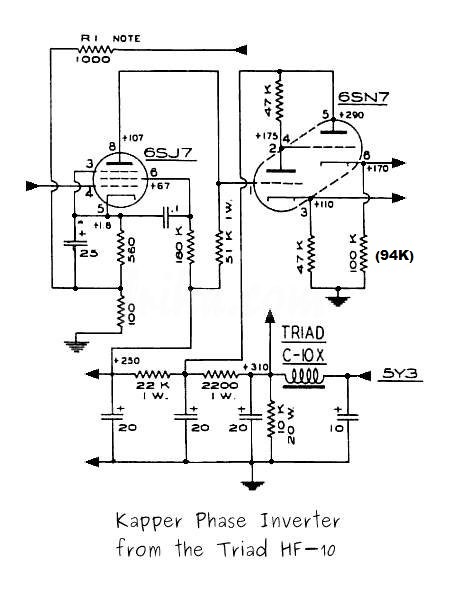

Why not to try with Kappler PI ? , it is one variant of Concertina PI where both output is low impedance , good to drive 6AS7 triode grids in A1 class where of course this posted schematic need B+ to be scaled up to around 400V- 450V , so that the values of the other passive elements must also be changed in accordance with the higher B+ and eventually with other tube types used.
Not enough swing, and horrible overload effects.Why not to try with Kappler PI ? , it is one variant of Concertina PI where both output is low impedance

Will there be an improvement in the Kappler circuit's characteristics if let`s say, only the phase inverter part (6SN7) is powered with bipolar +/- 250V ? , while input 6SJ7 only with +250V ? .
That would solve the swing problem, but not the overload concerns. It's just not good practice to load a cathodyne PI with unequal loads. It already has very low output impedance provided it is equal loaded (2/gm for both outputs).Will there be an improvement in the Kappler circuit's characteristics if let`s say, only the phase inverter part (6SN7) is powered with bipolar +/- 250V ? , while input 6SJ7 only with +250V ? .
