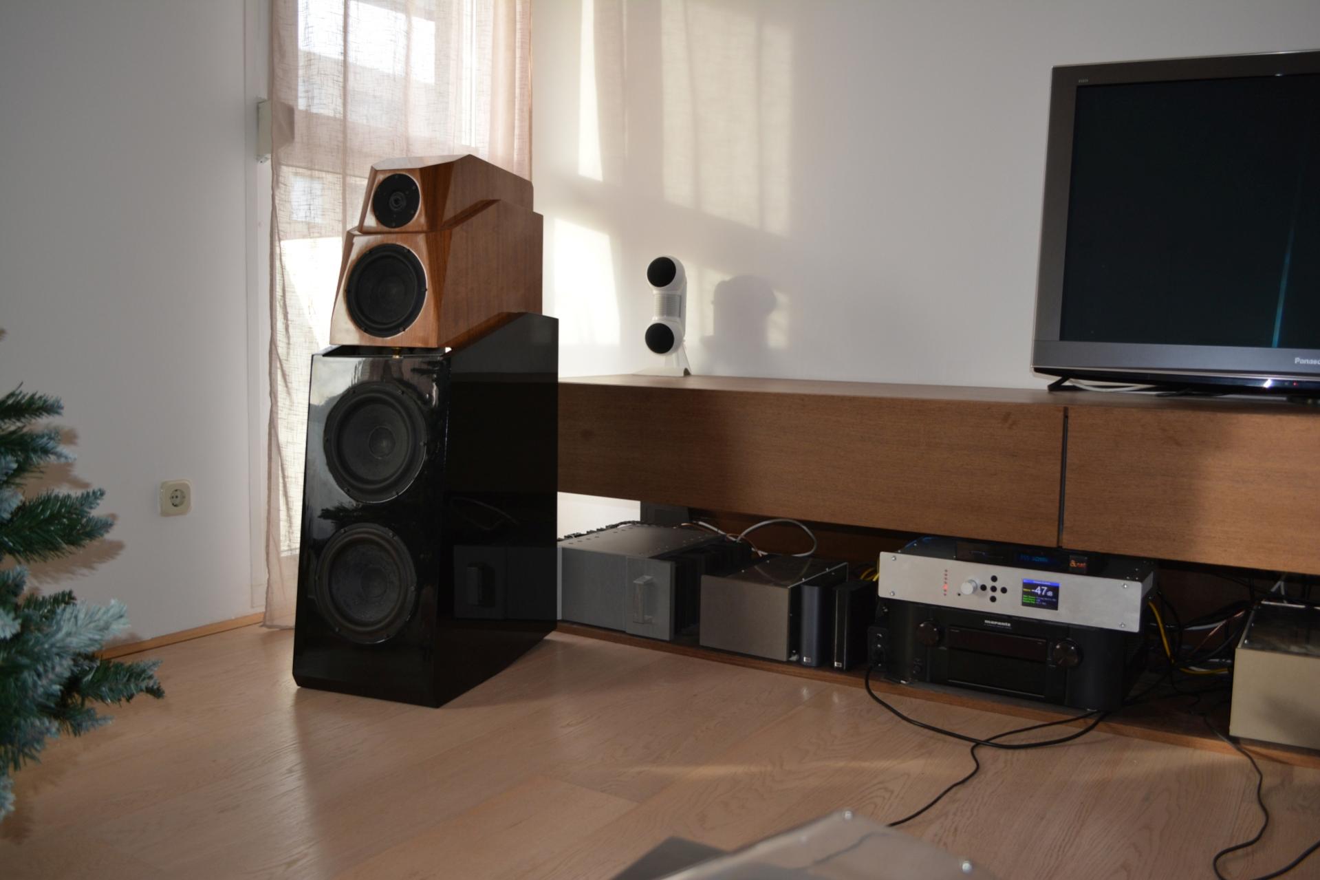

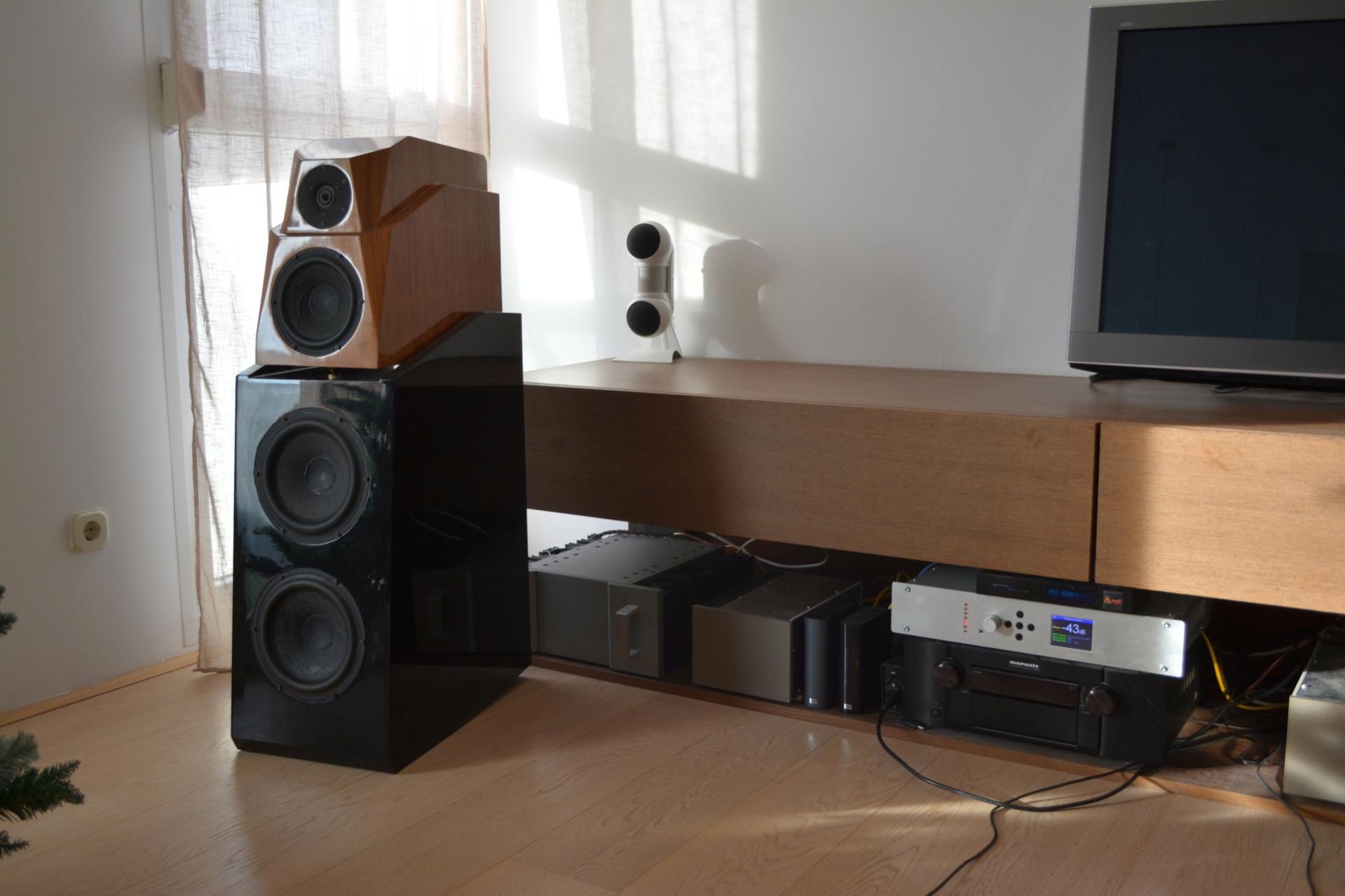

and finally I put DSP in use
I'm still trying to figure out audio weaver
for start I used tree way template from analog precision web page and change slope from 4 order to 2 order LR.
What I would like to know, if I chose 2 order LR, do I need to reverse polarity on one driver manually or is it made automatically via software ?
If I have to make it manuall is it done like on the picture ?
thanks

@yoke what drivers have you used? Is the bass sealed or vented?
Hi, I'm using;
scan speak 2904/7000 - Aleph mini
scan speak 18W8545 (closed) - AlephX (around 60W - 8 mosfet per amp)
scan speak 2 X 21W8555 (closed around 46L - stuffed with sonofil) - right now amplifier is LJM L30D (D class) until I finish CFA amplifier from dadod
source is rPi 2 (music from NAS) connected via usb to David's DSP
Hi, I'm using;
That will sound pretty sweet when its all dialed in. Nice work.
