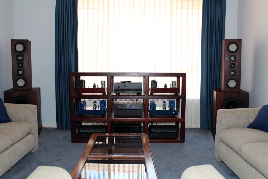

I received my unit less than a week ago.
Straightforward to download the preconfigured 3-way script, adjust the lower Xover point to 100Hz (the upper one was already 1000Hz which was what I required) and save it to the on-board flash memory.
I haven't done exhaustive listening tests yet but I'm very happy after a few hours of casual listening.
I've attached a picture of the unit taking pride of place at the center of my rack.

Really nice setup mate.
