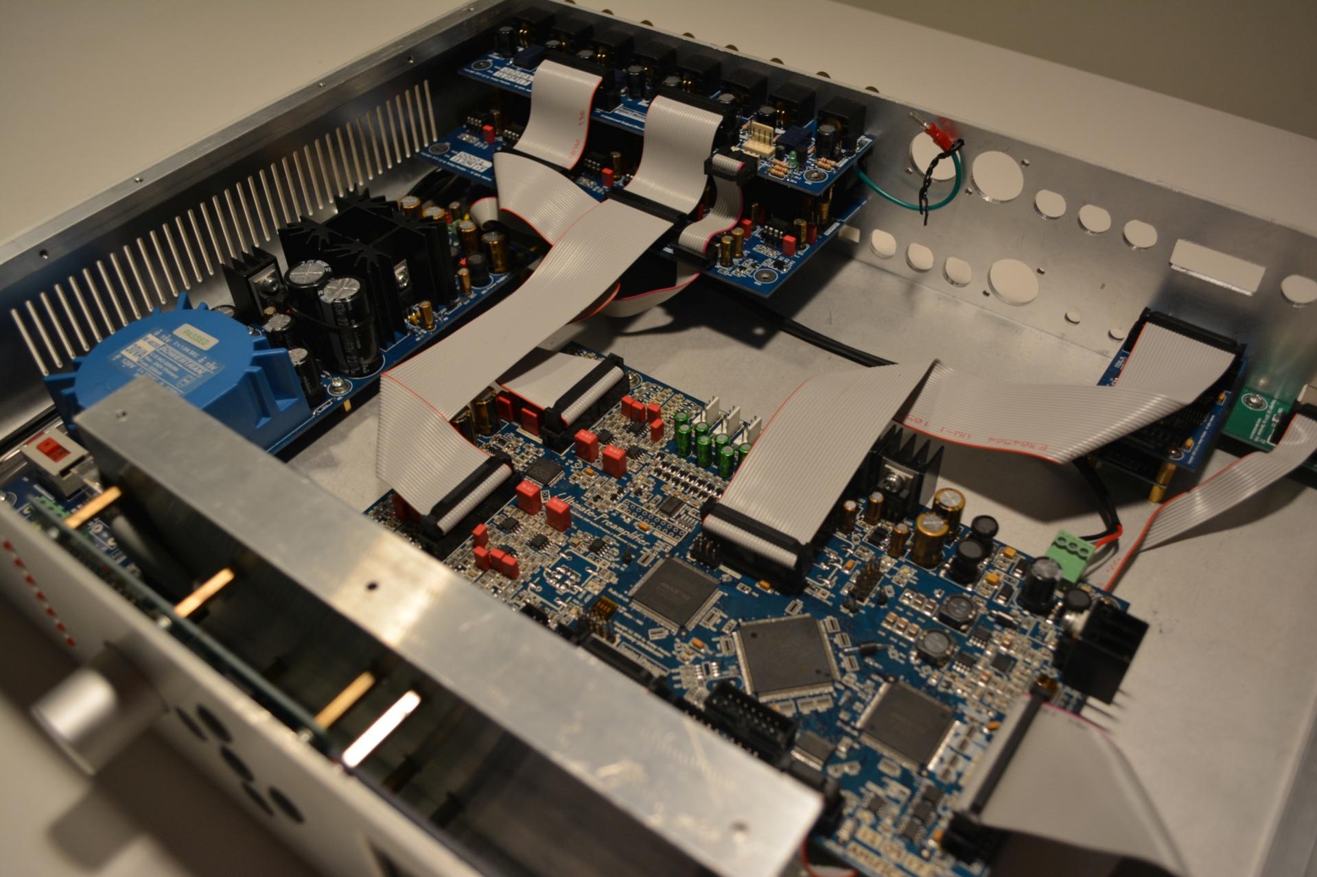

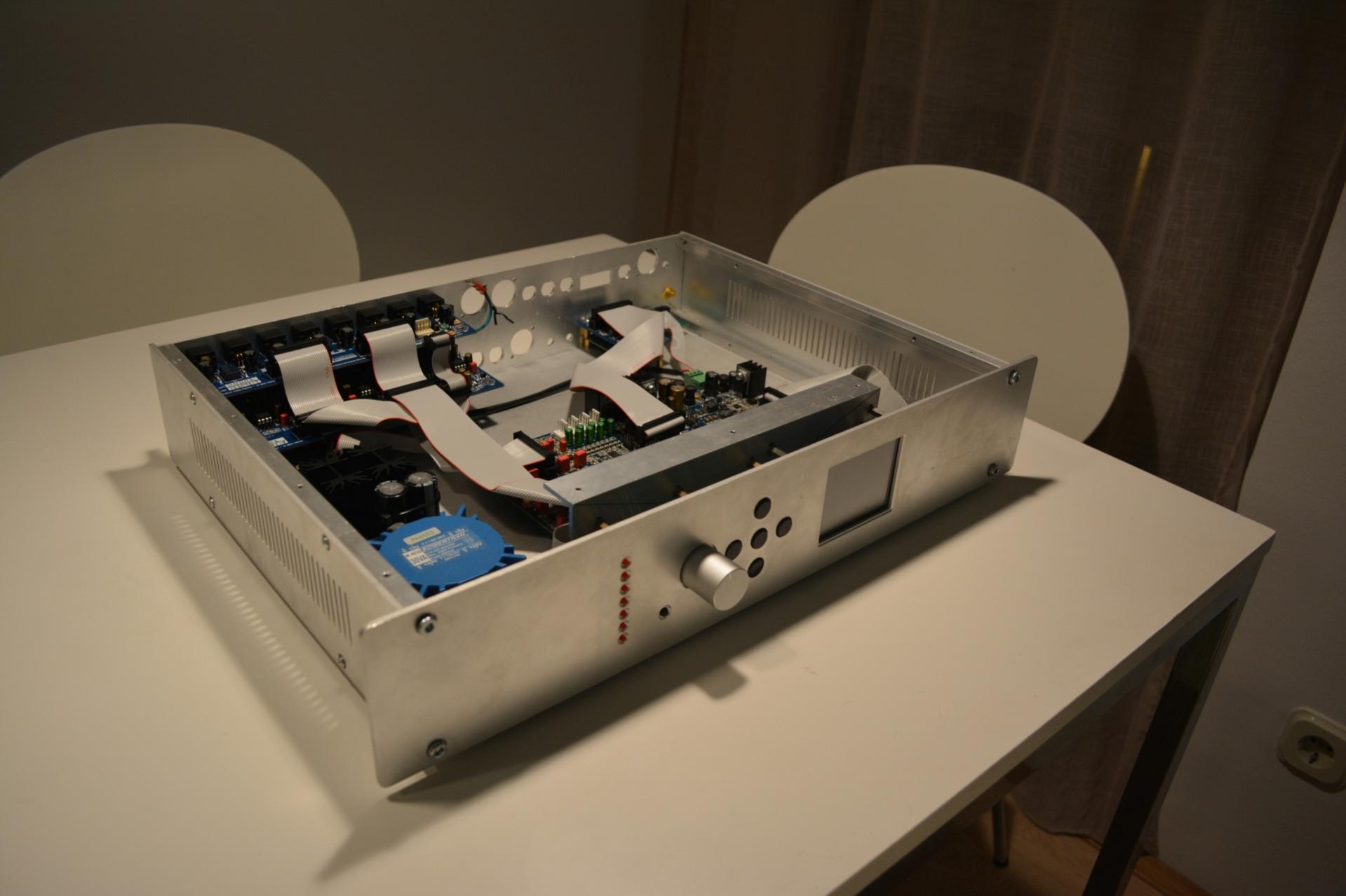

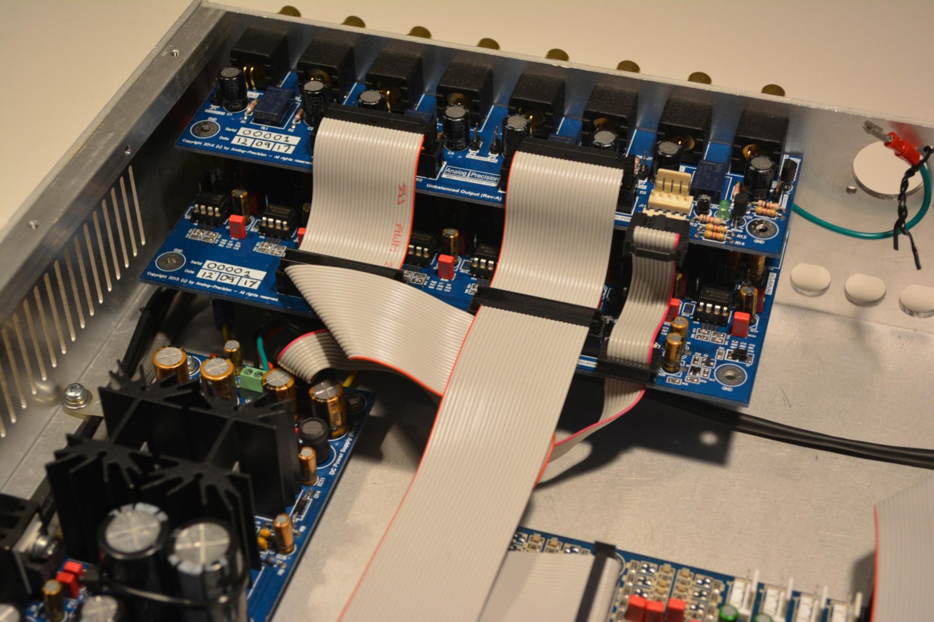

Sorry for those that are patiently awaiting their Preamps but here are three Preamps currently on test almost ready to be sent out ! Still another three in the works to be built !
Cheers.

I like your stainless steel, plain casing and the type of knob you've used.. Did you make it yourself?

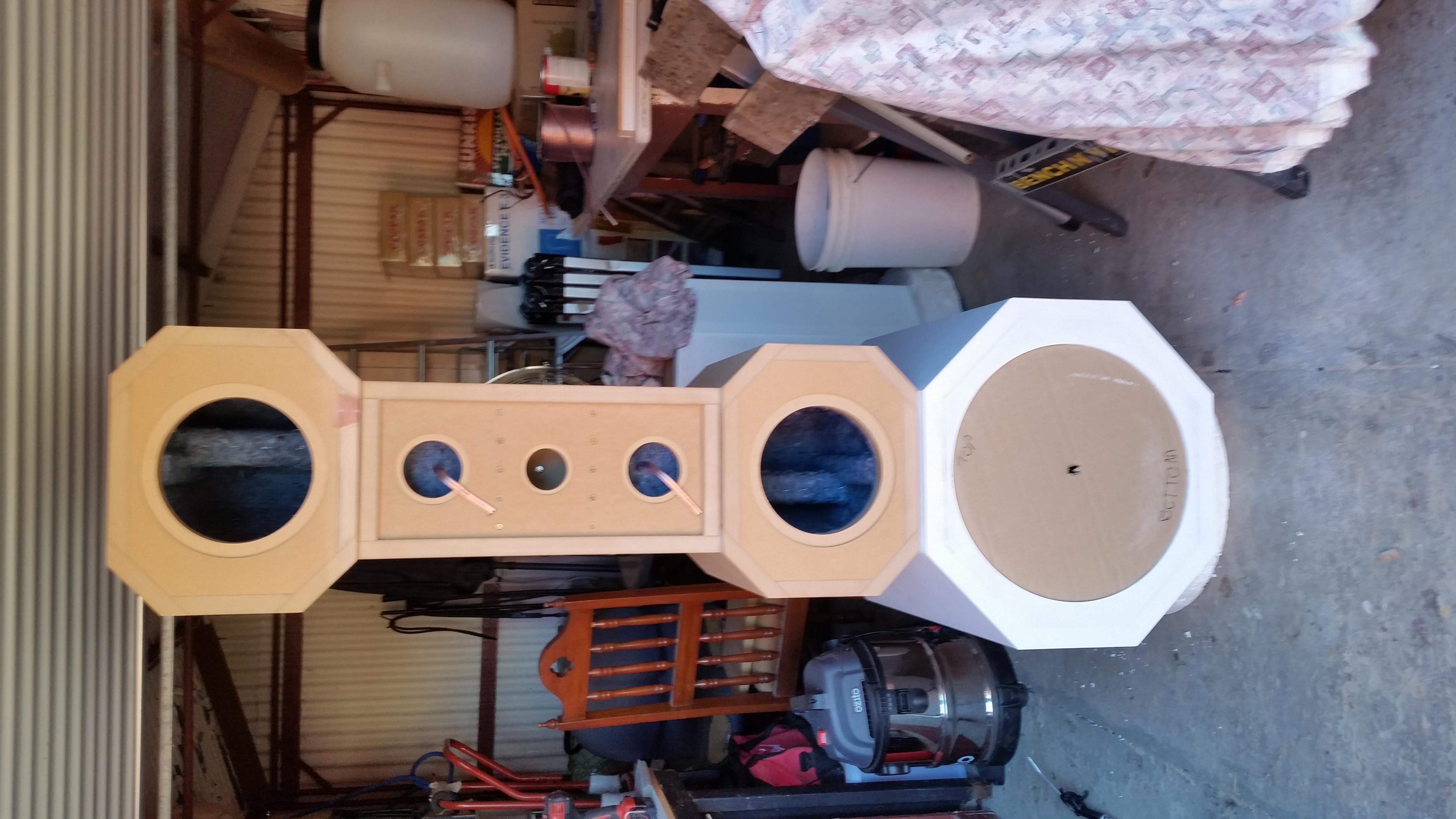

This is what my Ultimate Preamp will be used on
Hmm... Nice set of boxes but I think the ultimate preamp will need to work in conjuction with some drivers too 😛
