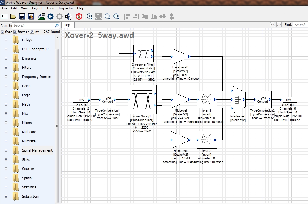

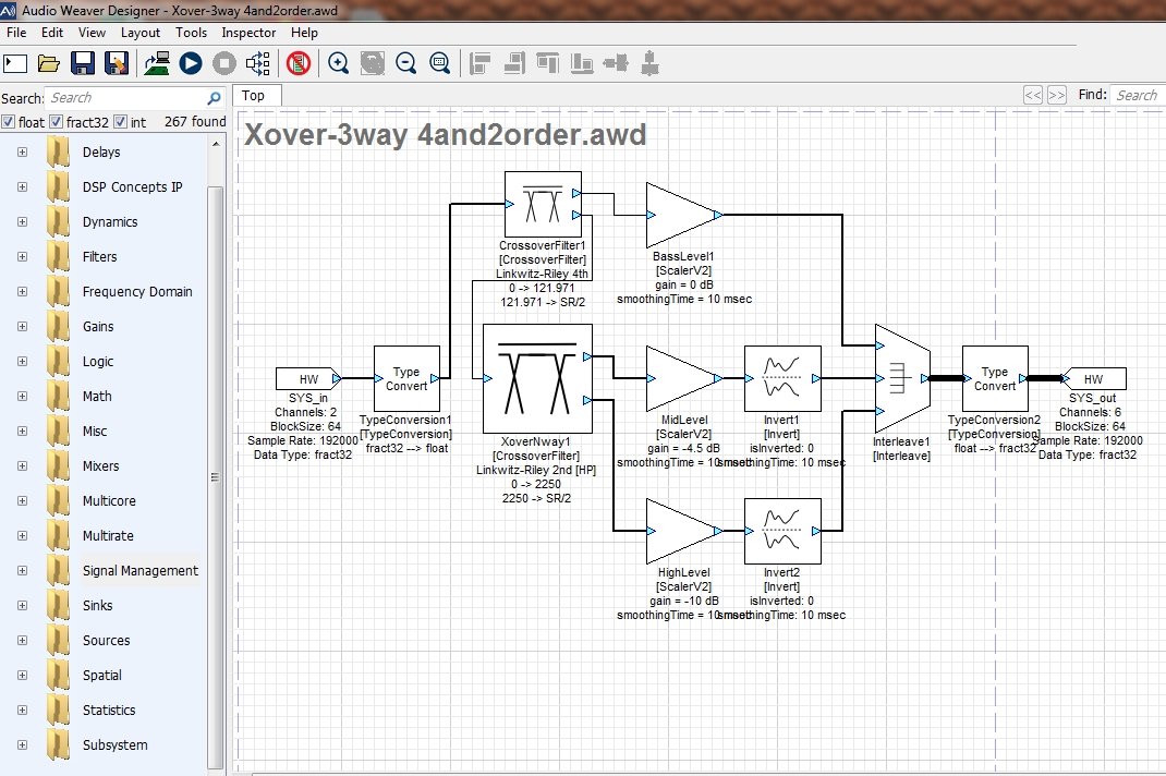

Could someone please check the wiring diagram for those two option;
- one is 2.5way , I mide try to play midbass to go as low as possible and add bass
- the other is 3way with 4th order on bass and second order on mid/hight

Regards using one crossover block for a 3 way, is it possible in Audioweaver to use different crossover types/orders for the different frequencies, but still have one crossover block for the benefits mentioned above (more efficient use of the DSP)?
rgs
rgs
No you can only select one slope within the filter block that applies to all of the different bands. So if you wanted different slopes you would have to use multiple crossover blocks.

but this layout doesn't work for 2.5way
it report error as one output of the upper block is not connected.

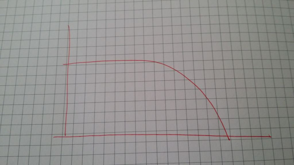

Is there any other block on which I can change upper cut off frequency and slope from LR2 to 4th order for bass unit ?
so that graph would look like on second picture

Seems to me in the upper block giving the error you don't want a crossover; you just want a low pass filter; is that not right?
There are lots of filters to chose from; if a native Linkwitz-Riley is not available you should be able to cascade two identical Butterworths for the same response.
Hope this helps.
thanks
I think you need to place a NULL sink on the unused output. In the component pane do a search for NULL and it should show up.

I have used Butterworths, but only one block (as you suggest)...didn't go for cascade to get LR...(for 2.5)...just to see how it will sound
Or 3way with 4th order on bass.
I cut bass cabinet very low, at 95-140Hz ...I'm still playing around 😀
will try what David suggest in a post above 🙂
