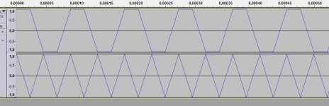

It's at the output of the DAC. If the signal is clipped before the SRC then it will be clipped after the SRC because the S/PDIF cannot handle anything above FS. I noticed that if I force the output of the sound-blaster to re-sample at 96kHz then neither signal is clipped.
cheers
Strange, didn't think the resampled signal could be sent over S/PDIF without attunating so that all samples are at or under 0dbFS.
When I scale down the inputs to the SRC by half the clipping goes away as you would expect.
But to restore the level I then scale up the output of the SRC and then I get the same clipping phenomena in the DSP but the right channel is ok with correct amplitude as it is not been driven into overload.
But when I inject the 44.1K signal directly into the DAC there is no clipping because it does not upsample to another sampling rate. Upsampling from 44.1K to 192K is producing samples that overdrive the SRC or proceeding signal chain. It's purely a mathematical phenomena and the solution is to pre-attenuate the signal to the SRC to account for the worst case signal.
regards

According to that AES article you provided the link for a 6dB buffer will allow for a worst case scenario so 6dB it is It's funny but what do DAC's that don't have any DSP to attenuate the signal into the SRC do to avoid this issue ?
Guess they don't avoid the issue.....
Might be wrong, but i think SACD has -6dB volum to avoid the problem.

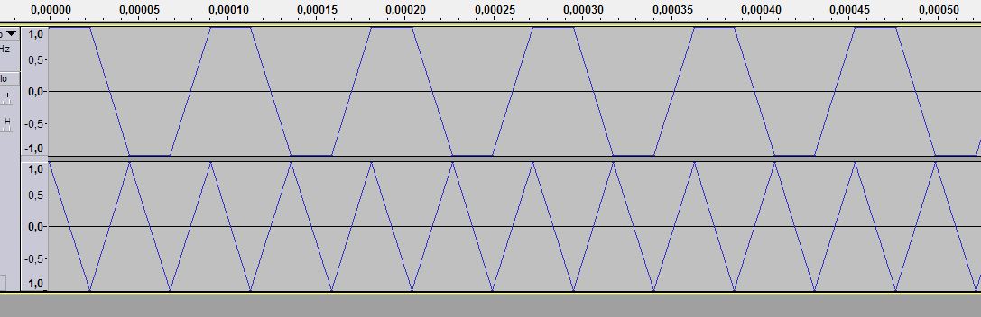

Just for fun if someone like to try, a file is enclosed with right channel
Dim Freq As Double = 22050
Dim SF As Double = 44100
Dim Phase As Double = 22.5
Dim Ampl As Double = 2.6 , 8.3dBFS
and left channel:
'Dim Freq As Double = 11025
'Dim SF As Double = 44100
'Dim Phase As Double = 45
'Dim Ampl As Double = 1.41, 3.0 dBFS
Mind the volume so that no tweeters are harmed!!!

Without the 6dB attenuation the left channel clips and the right channel is OK. With 6dB attenuation there is no clipping
I am making this option switchable from a menu so you can easily do a comparison between the two settings although the 6dB attenuation reduces the volume
cheers

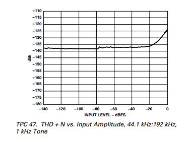

That is great. Should not be any penalty THD/N wise.
Enclosed a picture from the:
http://www.analog.com/media/en/techn...ets/AD1896.pdf
The signal can be attunated more than 6 dB before THD/N get worse.
I guess +6dB can be insertes on start of the DSP filters without the same risk of overload in the case of 2 (or more) way speaker.
In normal music the +0dBFS signal is a compound of different frequencies. Frequncy deviding gives very high probabillity for to sub 0dbFS signals.
As of the +8.6dB, SF/2 signal: Maybe a antialliasing filter attunates it enough to get under 6 dB? I dont know.
Thanks for again.
Regards Torgeir

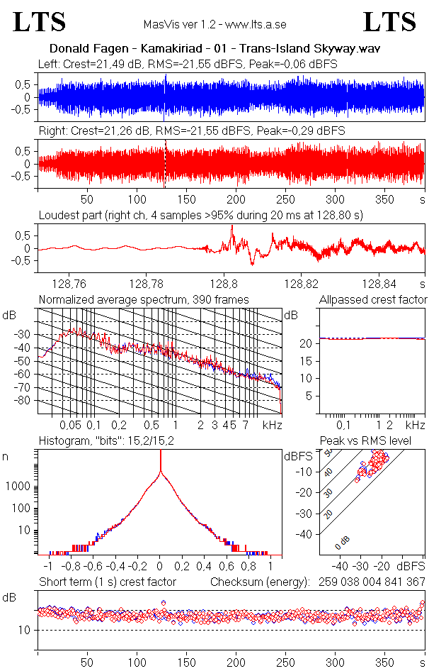

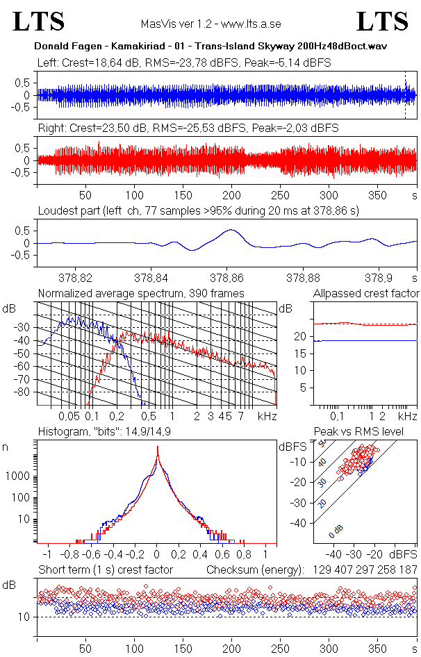

To illustrate the splitting of spectum point, I enclose two gifs.
It is the accumulated spectrum of Donald Fagen - Kamakiriad - Trans-Island Skyway done with MasVis
1st gif is both channels undevided. (No +0dbFS by the way)
2nd gif is left channel devided at 200Hz, 48dB/oct.
Low frequency channel: crest goes up. Has -5dB peak.
High frequency channel: crest goes down. Has -2dB peak.
And often the problematic portions of the songs is when the dynamics prosessor has pushed a HF signal modulated on a LF (bass) signal too close to 1 (0 dbFS sample value).
Remove the bass and it is OK.

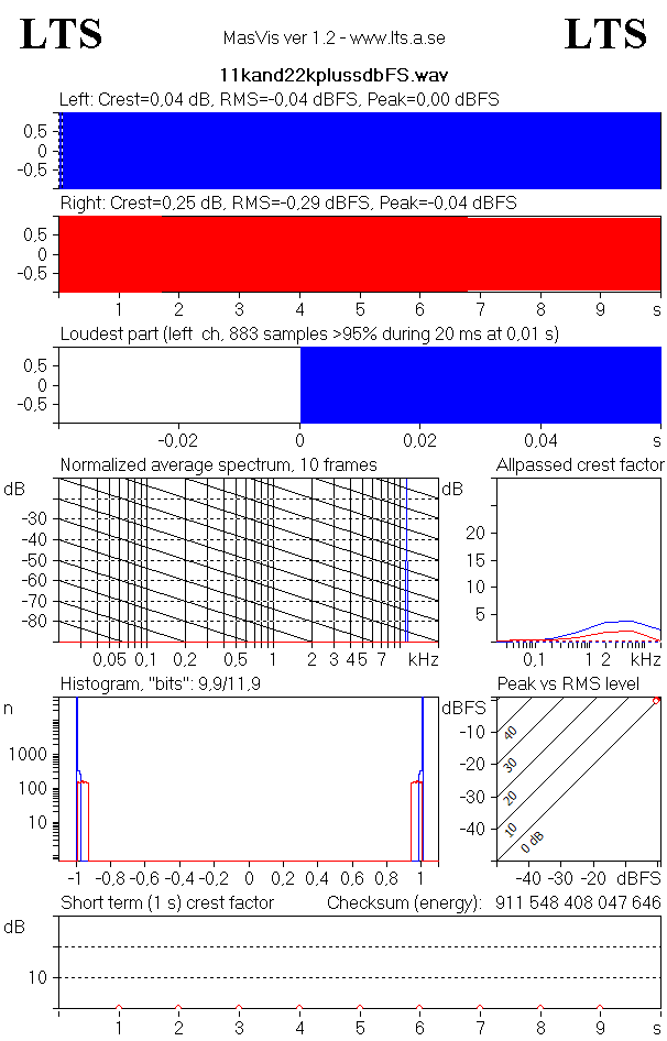

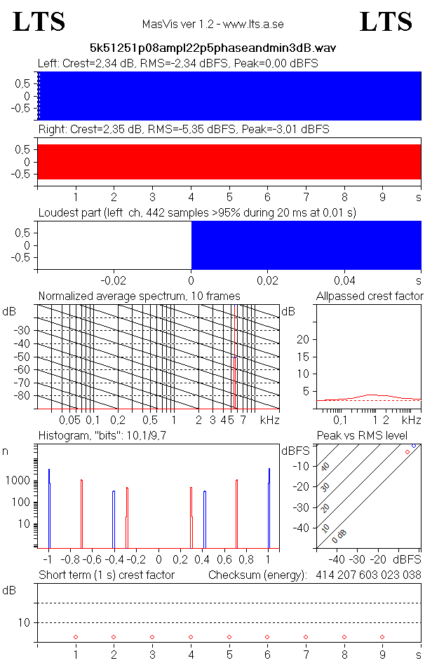

I see MasVis dont show +0dBFS signals.
But the crestfactor and RMS values is "unnatural" on the 11k and 22k +0dbFS signals posted earlier
The same with the 5k +0dbFS as the ordinary RMS value of a sine is -3dB.
