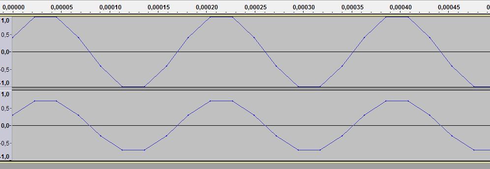

I made a zipped 44.1 fs, 5512.5 Hz sin stereo wav file that has 22.5 degree phase change and 1.08 (linear) amplitude in left channel. The right channel is normalised to -2dBFS and should be under 1 (linear) in amplitude. The output should be clean but in a audacity the left channel looks clipped.
This can be used to check if such overload is taken care of.

I made the file again this time left 1.08 and right -3dB or 1.08 / sqr(2) = about 0.76 linear. 1.08 linear is about +0.67dBFS so the rigth is about -2.33dBFS.
Asumes that +/-1 top linear corresponds to 0dBFS

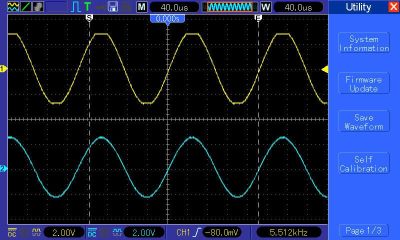

OK this is the output I get when I feed this waveform via a direct S/PDIF stream from the output of my soundblaster into the SRC/DSP. Top waveform is left channel and bottom waveform is the right channel. Output from S/PDIF is at FS.

And this is the output I get when I feed this waveform via a direct S/PDIF stream from the output of my soundblaster into the SRC/DSP. Top waveform is left channel and bottom waveform is the right channel. Output from S/PDIF is at FS.

Is it the analog output or the digital output?
For analog it should be two clean sinuses.
Or will the 44.1 -> 192 convertion interpolate the +0dbFS sinus to a clipped signal instead of a clean sinus?
Thank you for the testresults.
