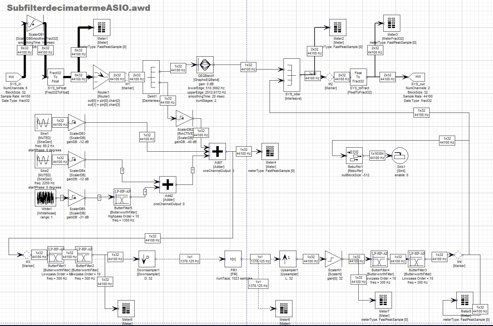

A little error in downsampling post. Should be "about 150dB down at 400Hz"
Tried to filter LP 2x60dB/oct -> Downsample 32x -> 1024 FIR filter (impulse only) -> Upsample 32X -> scale 32x -> filter LP 2x60dB/oct.
Inserts sin and HP filtered whitenoise and it looks OK.
Not code efficient. Chose some shortcuts with filters samplefrequencies and decimation factors.
Audioweaver AWD and MASM files enclosed in .zip
The filter runs on my Corei5 CPU.
Regards Torgeir

Guess the sampling frequency question boils down to if you are willing to use sharp filters or not.
It would be interesting if people started to use low samplefrequency for lower mid 300-600Hz. Then we have SF at about 2000 Hz and one could start discussing if you can hear slow/sharp LP antialiasing filters etc.
I think one issue of romcorrection bassfiltering is often overlooked. This applies to applications where more than 1 sub is used.
Under the room boundary the bass is added as to or more signals with a phasedifference that is lower than one period at room boundary frequency.
This means that phase change in one speaker will give a amplitude change in the sum of the signals.
When using IIR filters to correct a room resonance you risk to change the phase so much that the other woofers are cancelled out in the correction frequency area, in worst case. Using FIR it is possible to adjust the amplitude only (or phase only) so it is much easyer to adjust one wofer for linearity in the room without cancelling ut the other woofers.
