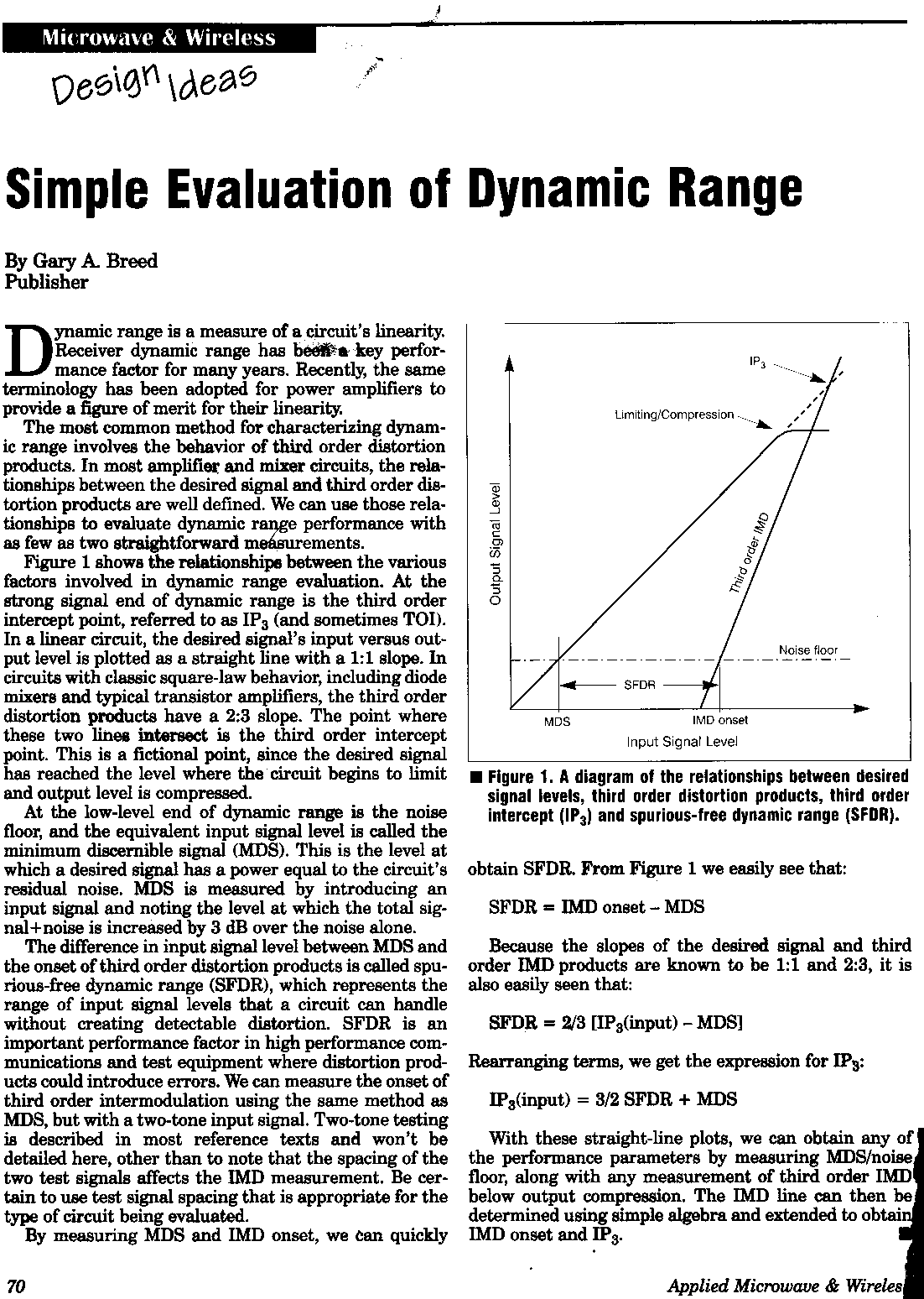

Dynamic range is not S/N ratio. Please do not make that mistake. Please see this attached article for some explanation.
