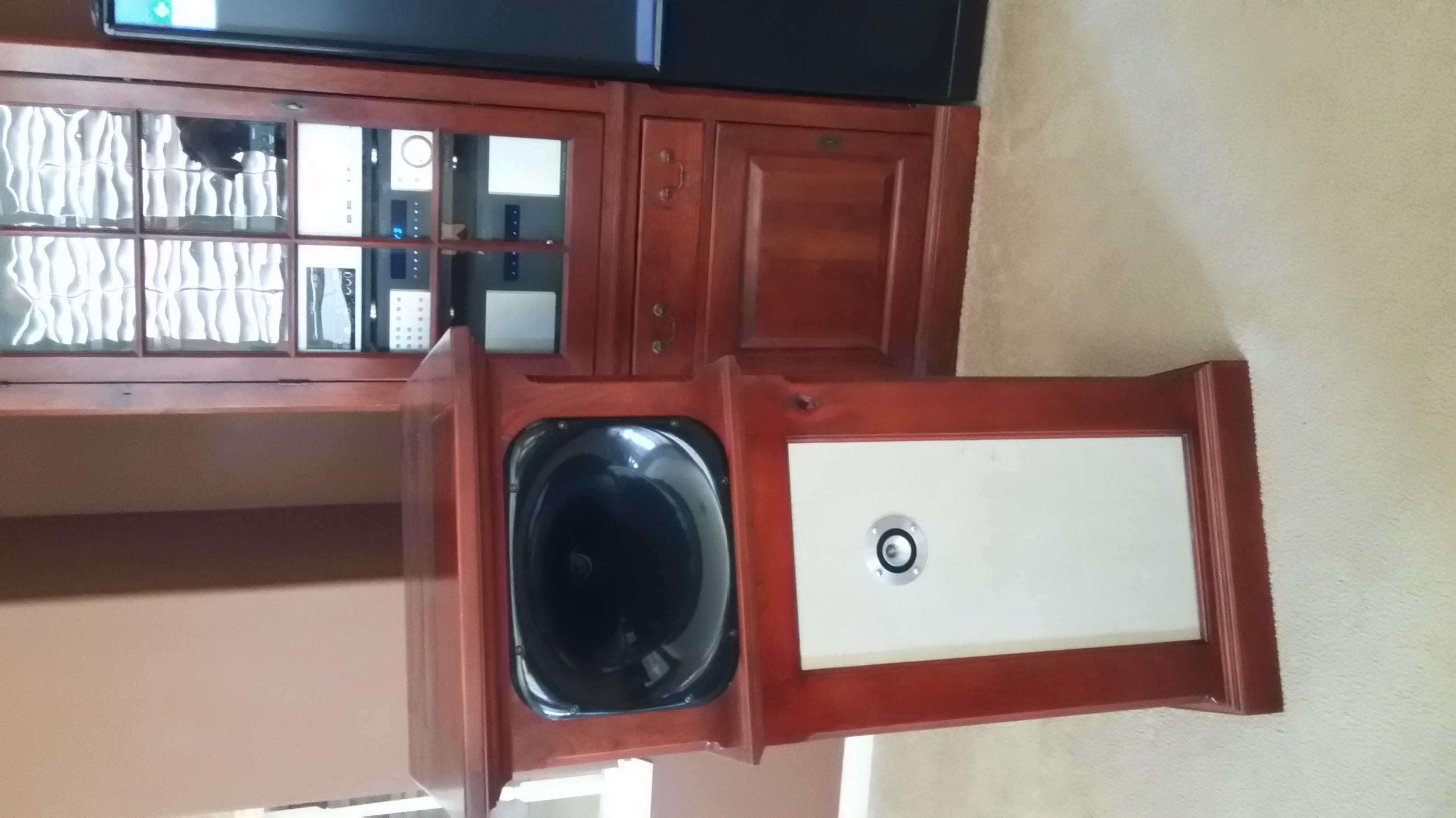

Thanks for the links, I have had for a while The Scientist and Engineer's Guide to Digital Signal Processing's Table of Content
great resource, just glancing at the same from Analog Devices looks to be interesting as they tie the book to their product. I'm a bit of an old guy so my taste tend a little more to the vintage side of life. It is a fun hobby.
See why you need a low noise crossover🙂
My 4 way suggestion is meant for non horn....
I have been suprised how loud and clean conventional elements can play when used with sharp filters enough volume displacement and small bandwith eg 4 way.
But, the beauty of a nice horn is somthing to else.
