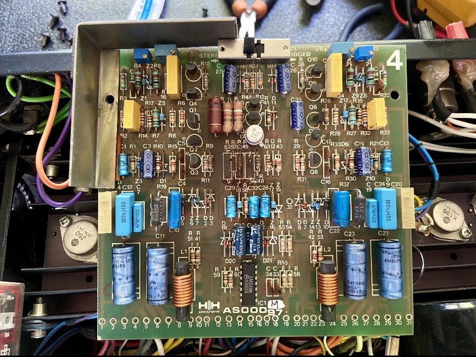

i found the problem with the dc offset R24 whas open and R25 showing 21K . But when i replaced them i got in to another problem now i have over -40VDC on the speaker terminals and bias is 0V . i have try to adjust the pots with same value like channel one and some other positions bot they are nor responding,
neither on bias or offset.
any idea what can cause this ?

Hi mate,you have a totally different type of M900 there,i have 6 of them and all the same...your one is missing parts badly,check my PCB in the photo,the strange fact is that the pcb serial is the same... HH AS00097....never had any issues with mine,checked on scoope as well,also you should never got -40vdc on outputs as the dc detect should disconnect the outputs,this amplifiers use the protect relays opposite the normal operation like the rest of amplifiers.
