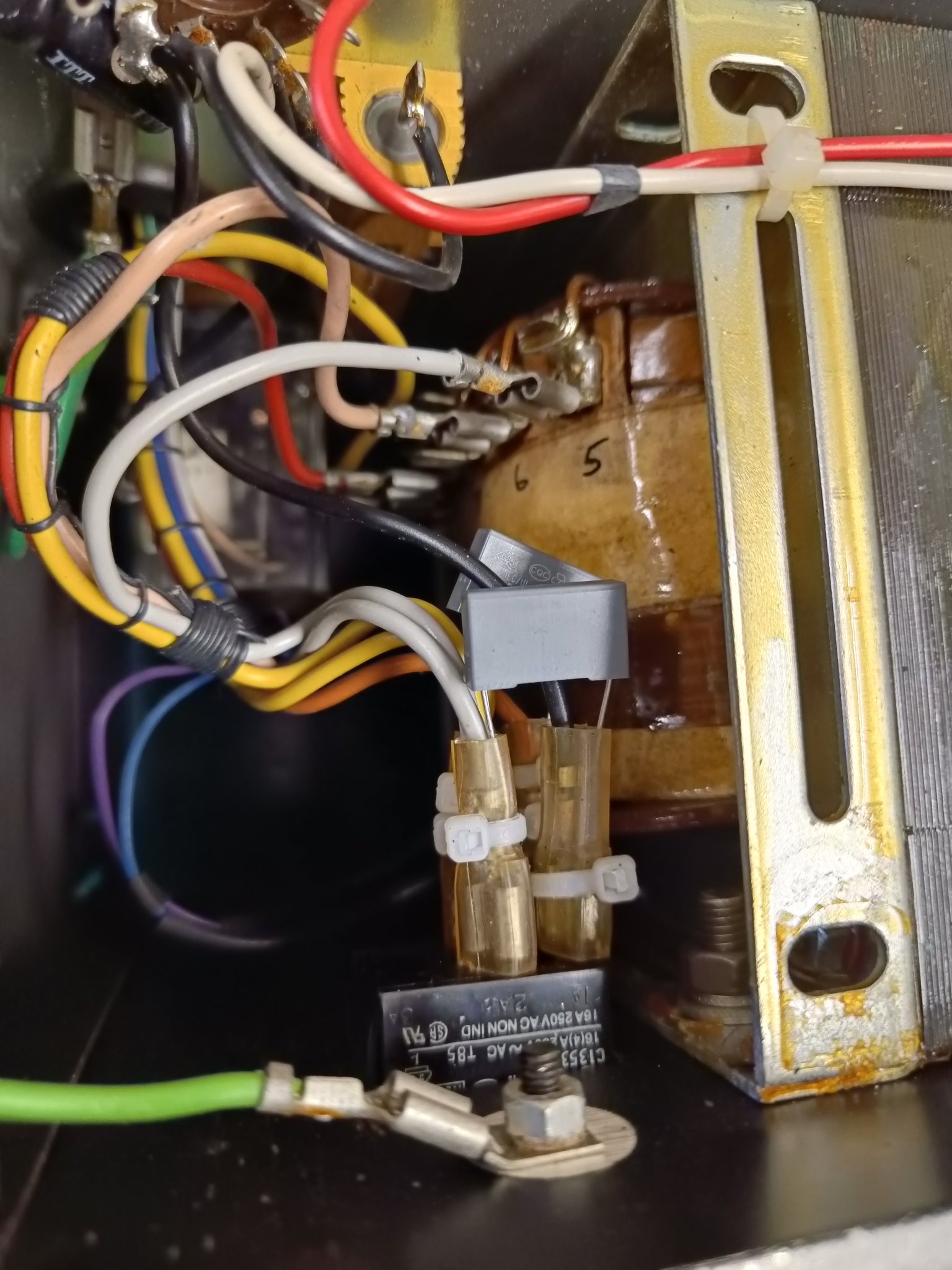

Hi mate,you have a totally different type of M900 there,i have 6 of them and all the same...your one is missing parts badly,check my PCB in the photo,the strange fact is that the pcb serial is the same... HH AS00097....never had any issues with mine,checked on scoope as well,also you should never got -40vdc on outputs as the dc detect should disconnect the outputs,this amplifiers use the protect relays opposite the normal operation like the rest of amplifiers.
