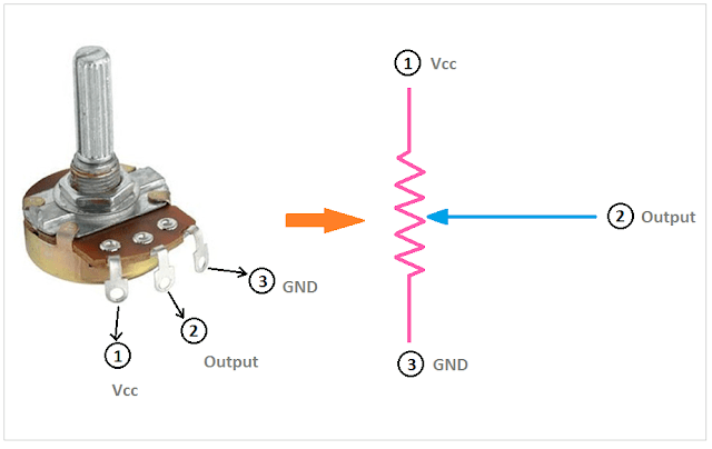

I assume you tried to adjust offset with VR3 and you can make offset even worse, but 590mV is lowest you can attain?
Z8/Z9 Is of...they conducting from cathode to anode Z8 1.4mohm and Z9 1.7mohm (out of circuit )
The easiest way to check Z8/Z9 is to leave them in-circuit. They appear to be 2.7V Zener diodes. Monitor the wiper terminal of VR3. Its voltage should move smoothly from +2.7V to -2.7V as you adjust the pot.

where on the pot shall i measure ?
yes it responds

And do you observe about +/- 2.7V variation at the wiper as you vary position end to end?
