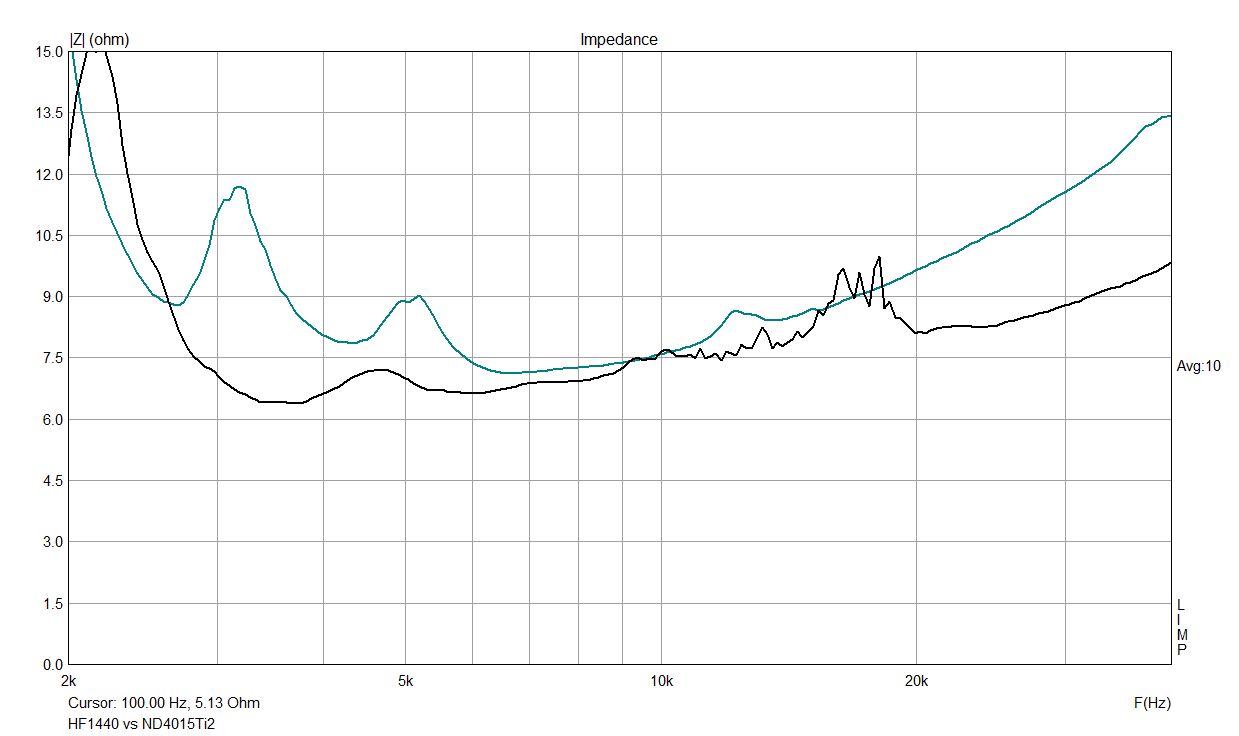

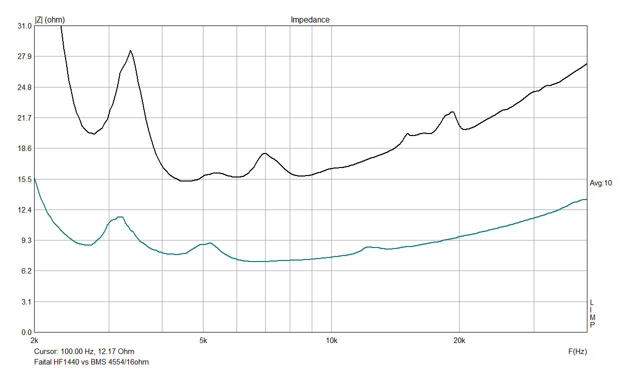

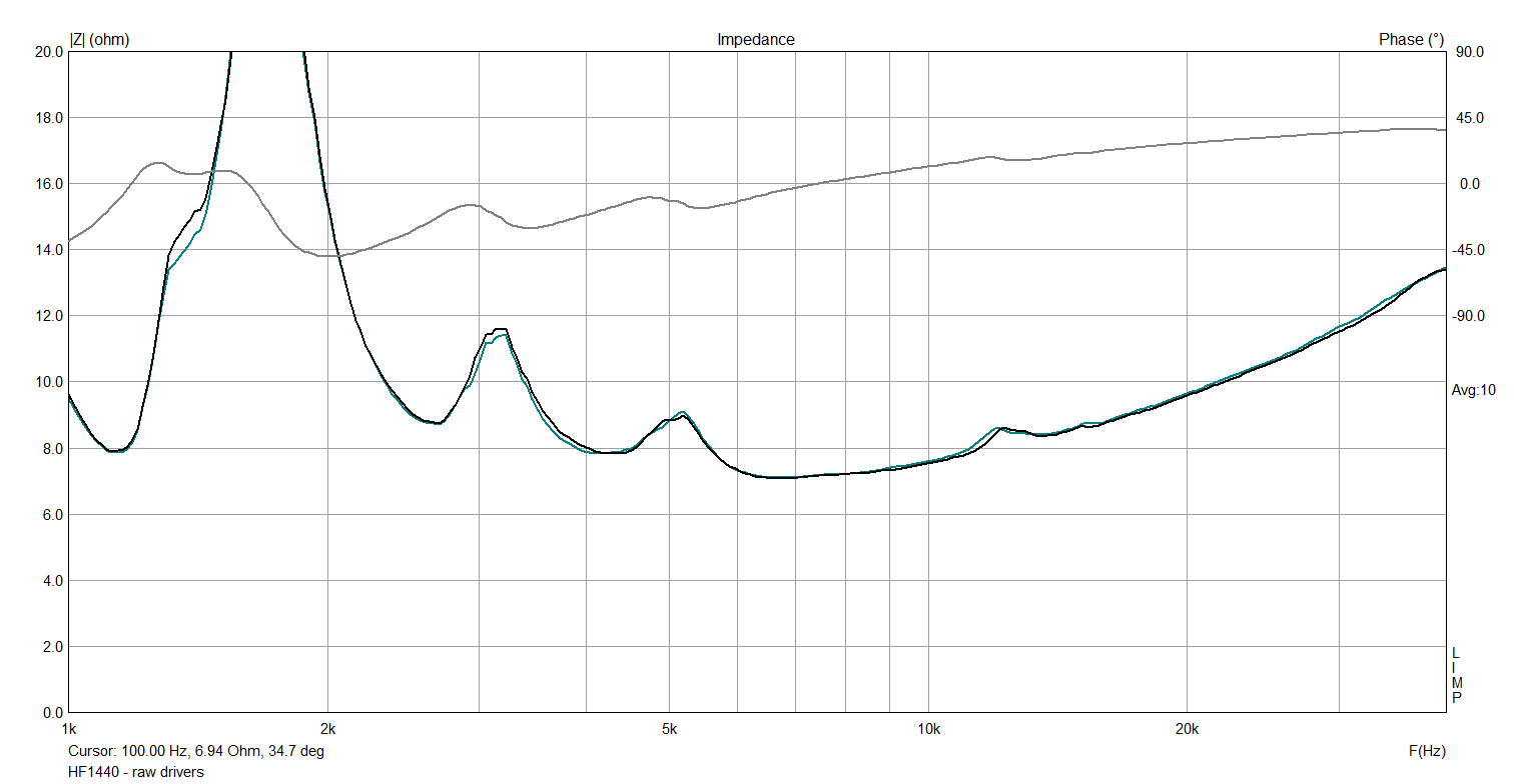

Also Mabat, when you measure the impedance of hf1440, please post a graph with a small scale (like 0-30ohm) up until 40khz. In faital's graph there seems to be no evidence of breakup in impedance below 20khz, or it's so small it's not visible after smoothing. Curious to see what happens after 20khz, does the response fall asap or is there a break-up mode up in the uhf and how high does the response go before falling like a rock.

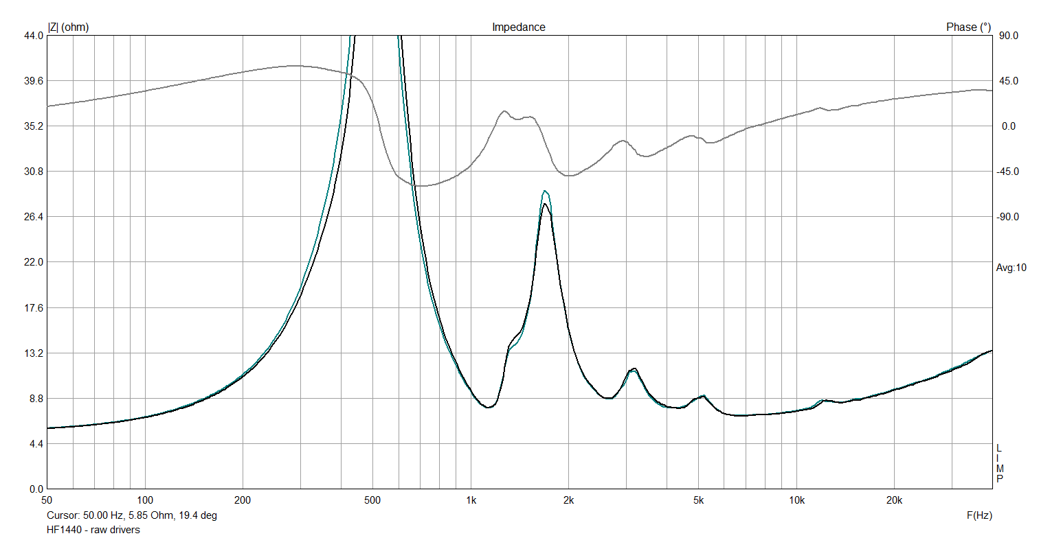

The impedance - as I said, I still don't have the horns for them (will make my own), so this is the best what I can provide at the moment - raw drivers just sitting on the table (tried various damping over the exit but it makes a negligible diffference above 10 kHz).

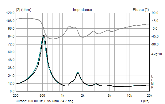

The low end bandwidth and the point where the H3 starts to rise is another question mark, I hope it's good to around 600-800hz. The high ohmic value low impedance peak around 500-600hz scares me a little, telling that the driver is not mechanically very damped. Don't get me wrong, it's basically a good thing, but it turns to a bad thing if this also accentuates the H3 rise near the Fs and there might be a nasty H3 peak if the driver does not get much electrical damping (ie. low loopback impedance from positive to negative binding post of the driver). This only harasses in passive xo systems, in active systems and voltage source amps the electrical damping is always there (if not hindered on purpose by current driving the driver etc) .
For example Truextent beryllium diaphragms had nasty H3 peak near the Fs (passive, low xo point) unless you offered them electrical damping through the crossover, ie put a short circuiting coil as the last xo component, not series cap as the last. Tad TD-4001 does not suffer from high loopback nor high source impedance, H3 is controlled. HF1440 might suffer from it.
