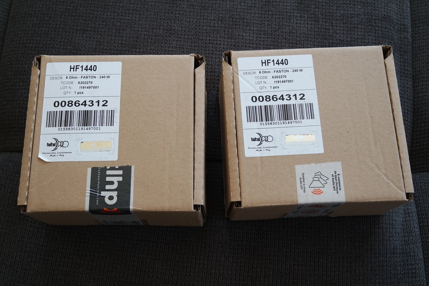

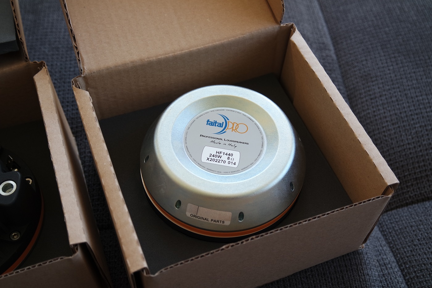

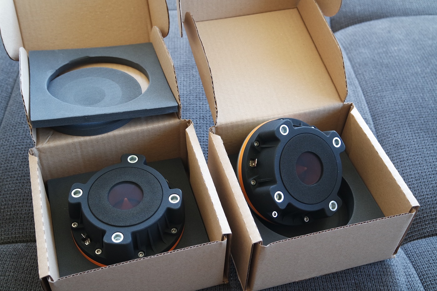

It was around 50 days when I ordered them. They were delivered in less than half of that time - you may be lucky as well 🙂
That is one of the worst cases of driver-porn so far ! I am going to report you to moderation ….. 😉
Fun aside: Could it be that there is also a version with push terminals because faston is explitely mentioned on the package of your's.

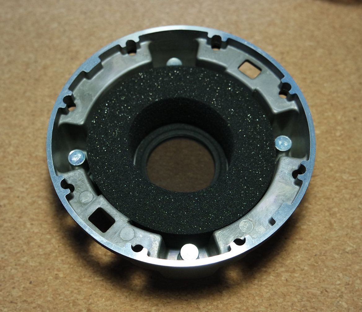

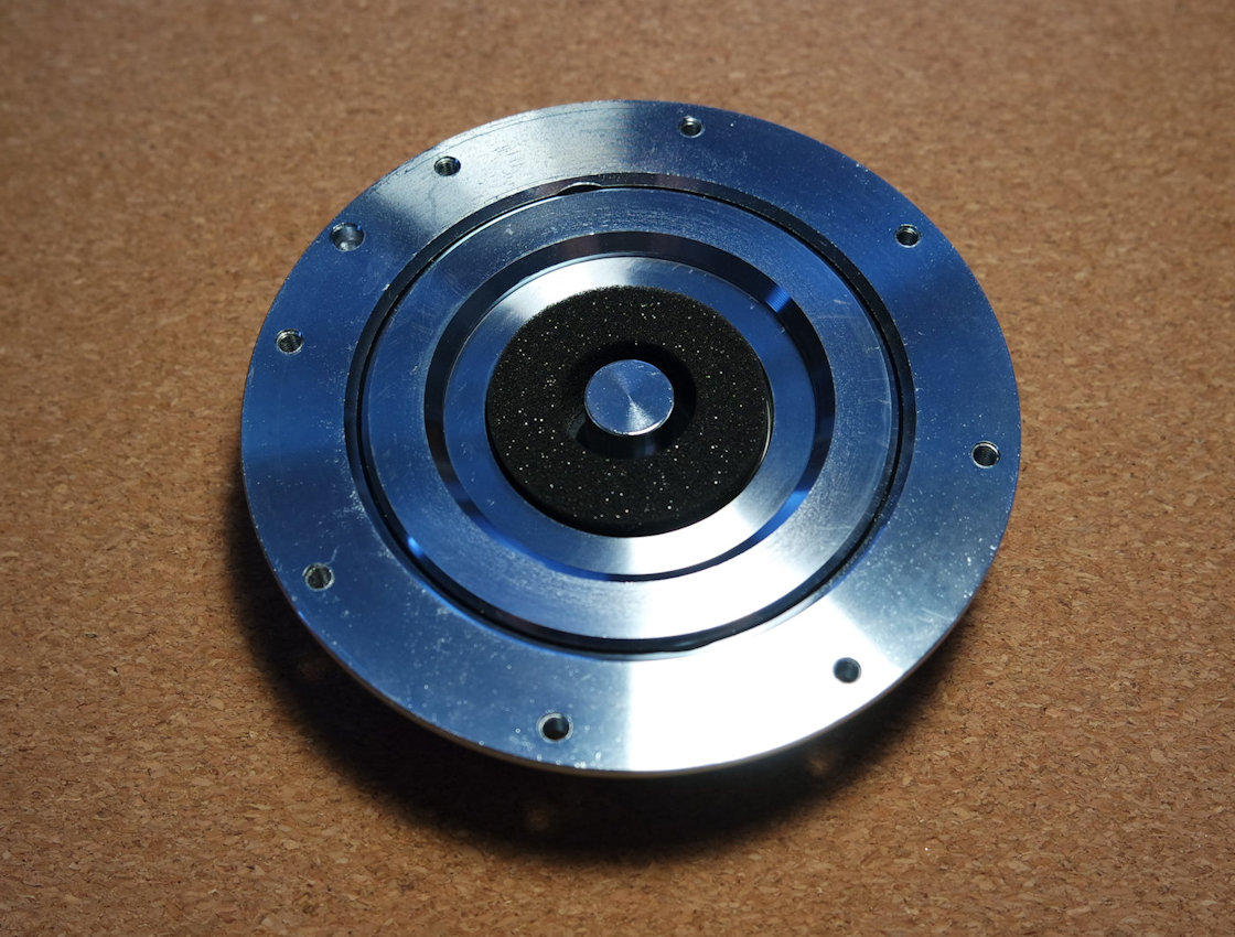

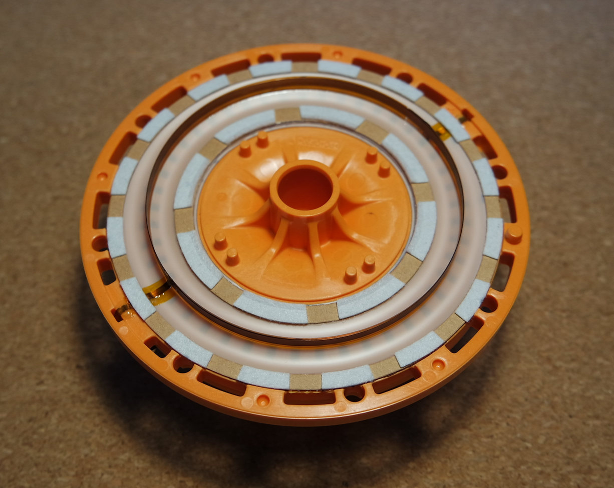

HF1440 disassembled - basically three parts. The outer diameter of the diaphragm is 100 mm, the inner 72 m (86 mm voice coil).

What caught my attention is how they connected the back side of the diaphragm with the internal volume of air under the front cover, apparently to increase the compliance (I can't imagine any other function - these are quite narrow channels).
Interesting! Thanks for sharing.
The area of the ring is about half of a 4" dome. JBL specs 0.5mm xmax for their most recent drivers.
Looks like they aimed to roughly match the output of large format drivers without breakup in the upper octave while avoiding the cost of Beryllium.
