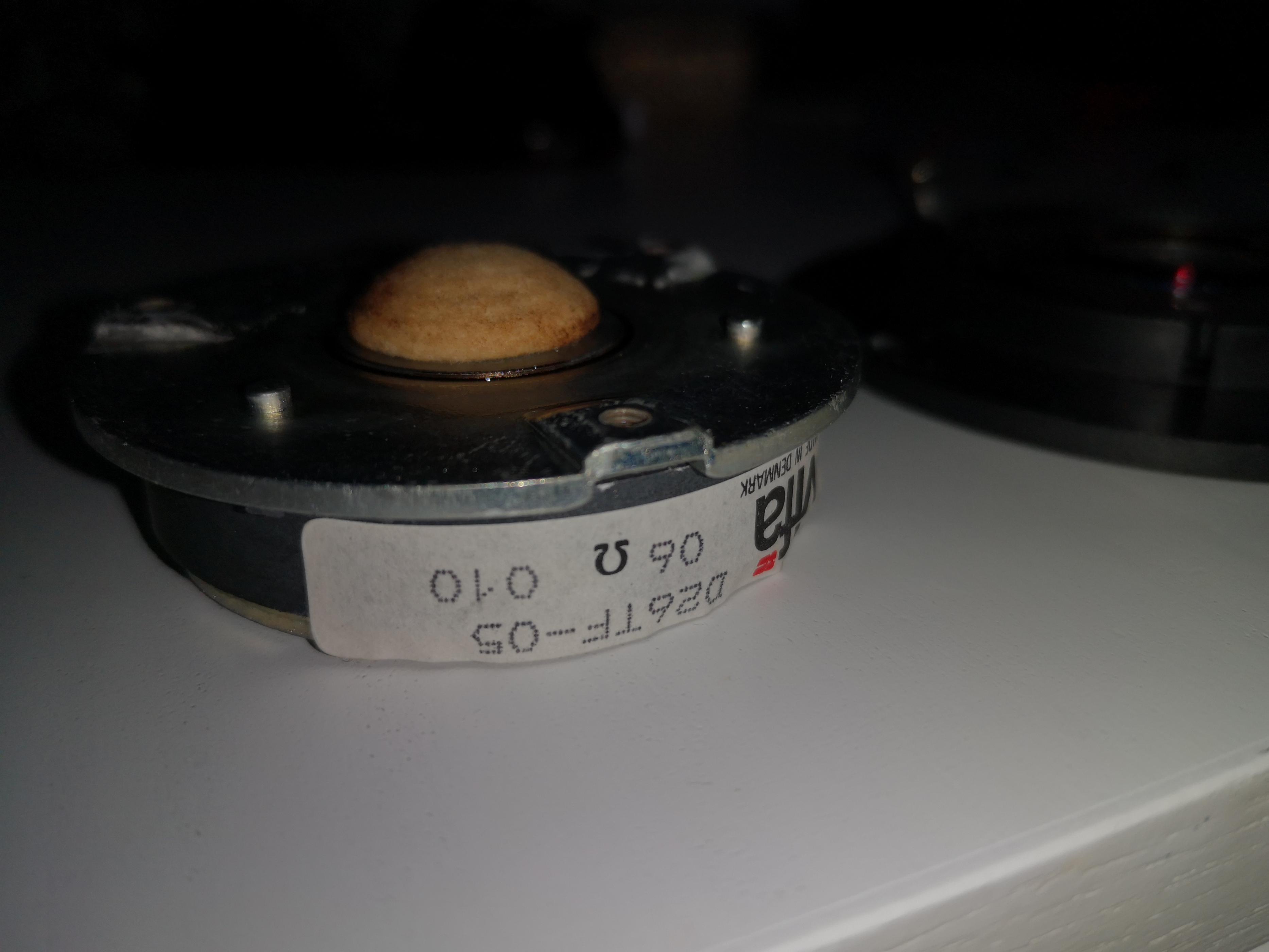

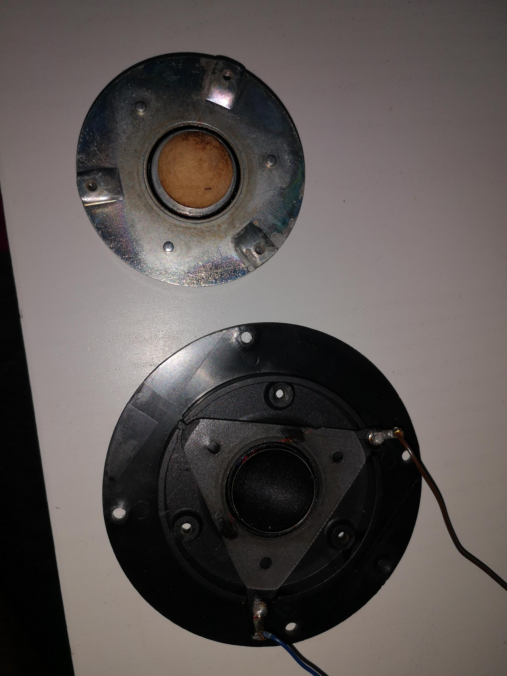

Heybrook HB1 problem with tweeter
Hi. Ferrofluid its still liquid.

Hi. Everything with tweeter its ok. They dont touch.

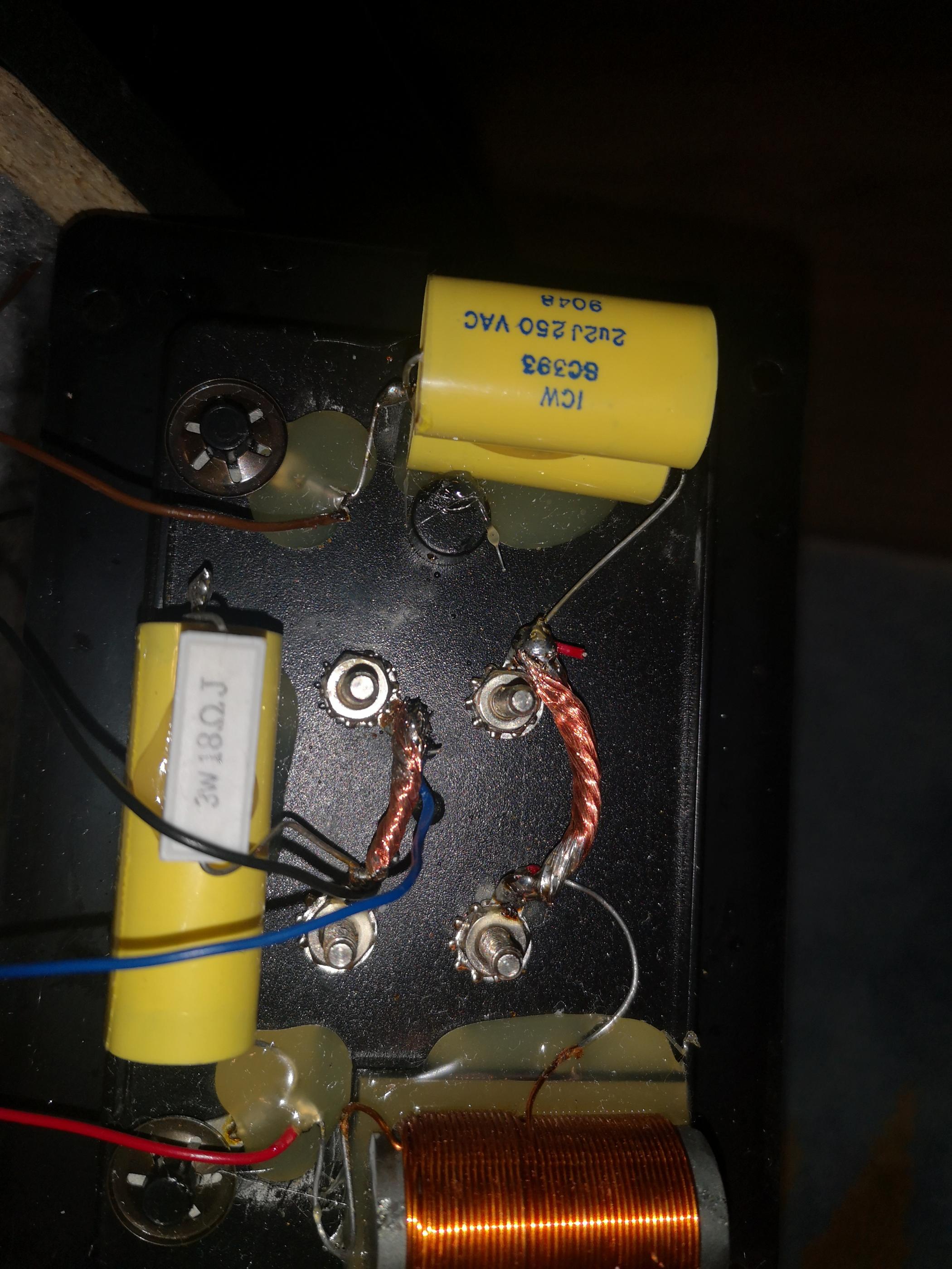

Your Gainclone amplifier may have been damaged when you connected it to your newly obtained Heybrook HB1 speakers.
One of the crossovers originally had that stranded copper wire soldered in place - apparently to convert the bi-wire terminals to single wire connection.
Connecting to the wrong terminals on that speaker would have short circuited that channel of your amp.

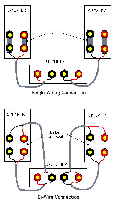

The attached diagrams show the difference between bi-wiring and single wiring.
The 'links' shown in the single wiring diagram can simply be short lengths of copper wire.
It is best to link the terminals outside the cabinet as shown. Linking them inside, as appears to have been done with one of your speakers, can lead to disaster!

The copper wire links I referred to in post #31 are already in place on your terminal board.
So, you just have to plug the loudspeaker cable from the amp into one of the pairs of red and black terminals, as shown in the single wiring connection in post #32.
I can't help but think there is some room for confusion here! 😕
Compare the two attachments.
Note that the left hand board is wired correctly and that the right hand board is wired incorrectly (those thick copper wire links should not placed on this side of the board).

I think I now see what's been going!
The board on the left had its links installed externally and the board on the right had its links installed internally - correct?
Both boards should have external links only which will allow them be single wired as shown in post #32.
