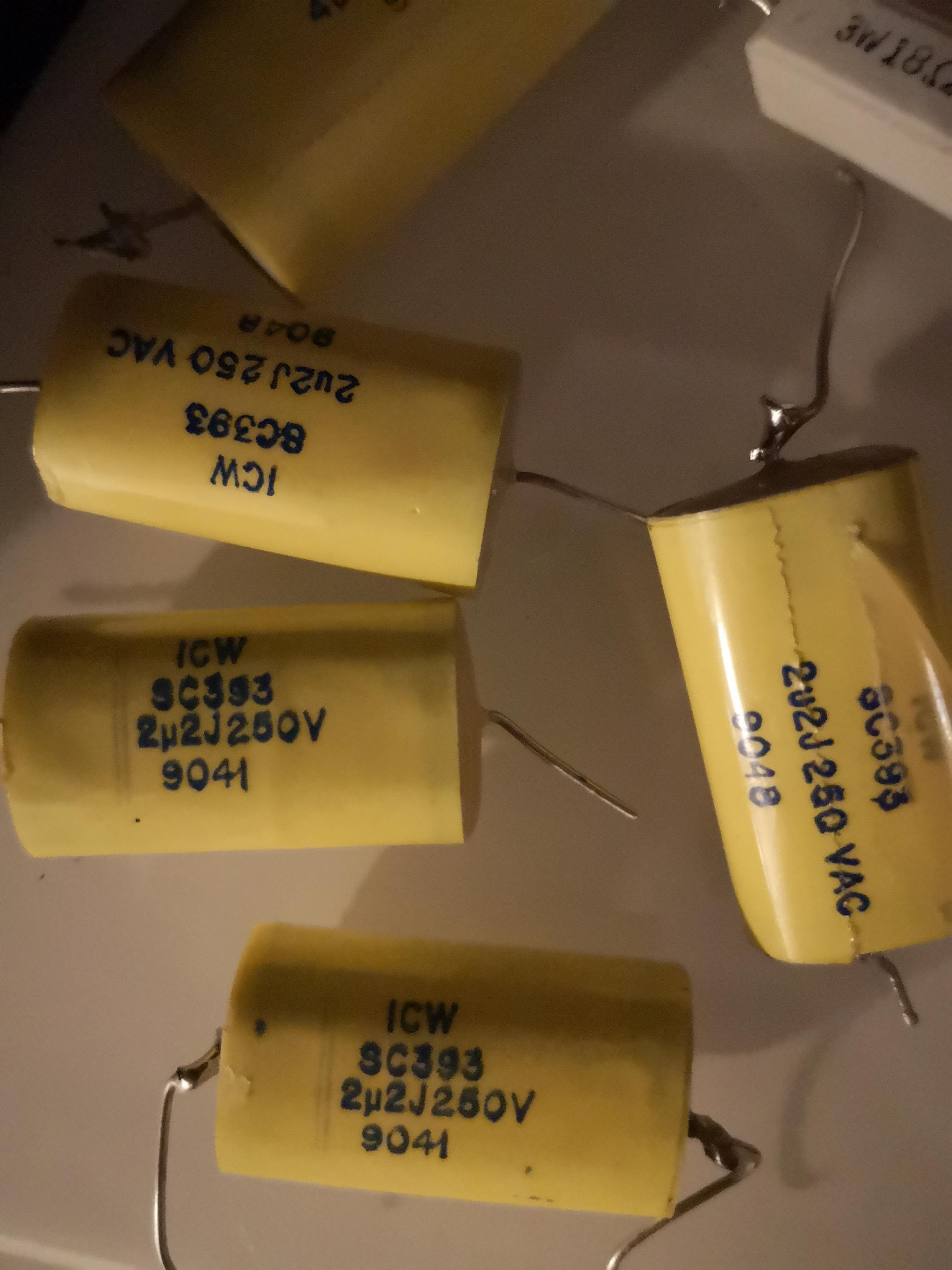

There will be nothing wrong with these film capacitors.
The fault is obviously in the tweeters themselves.
I can't get the YouTube video to open just now, but, as fatmarley has suggested, the problem sounds like dried up magnetic fluid in the tweeters.
If you have a spare tweeter, or even a small loudspeaker driver, you can try connecting it up to the crossover in place of a Vifa tweeter. If the spare tweeter works you will know that the crossover is OK.

I send a photo a capicitor from my tweeter. This is two pairs. They have 2.2 uf all for? This mean its 4.4uF for tweeter. I HAVE RIGHT?

Could you supply photos of one of your crossover boards so that we can see the components that are fitted on your particular board?
In general, it is best to leave crossover components as they are because changing them can change the crossover function and hence the way the manufacturer intended the speaker to sound.
An exception is if the crossover contains old electrolytic capacitors that measurement has shown to have drifted off value. These should be replaced by fresh, new ones.
