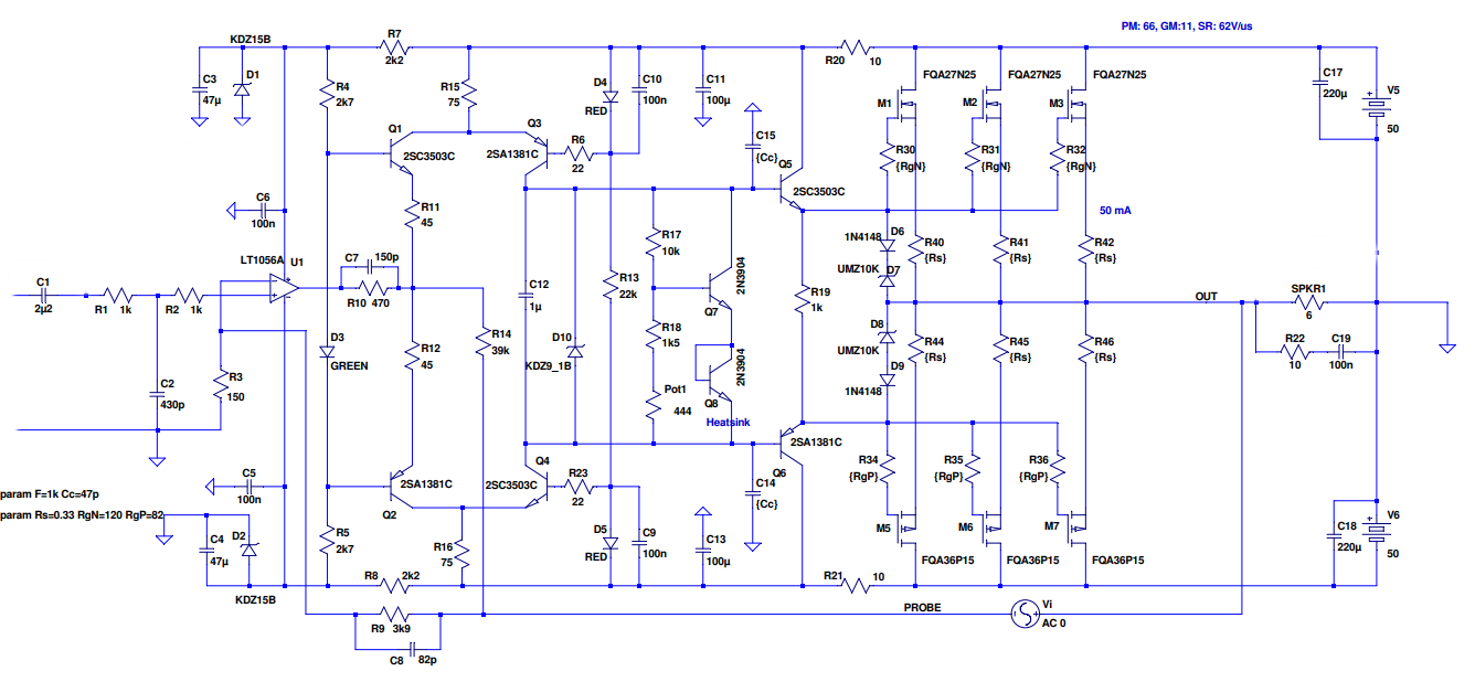

LMK&PHILIPS MINI BEAST WORK IN PROGRESS
LMK&PHILIPS mini beast by egra.

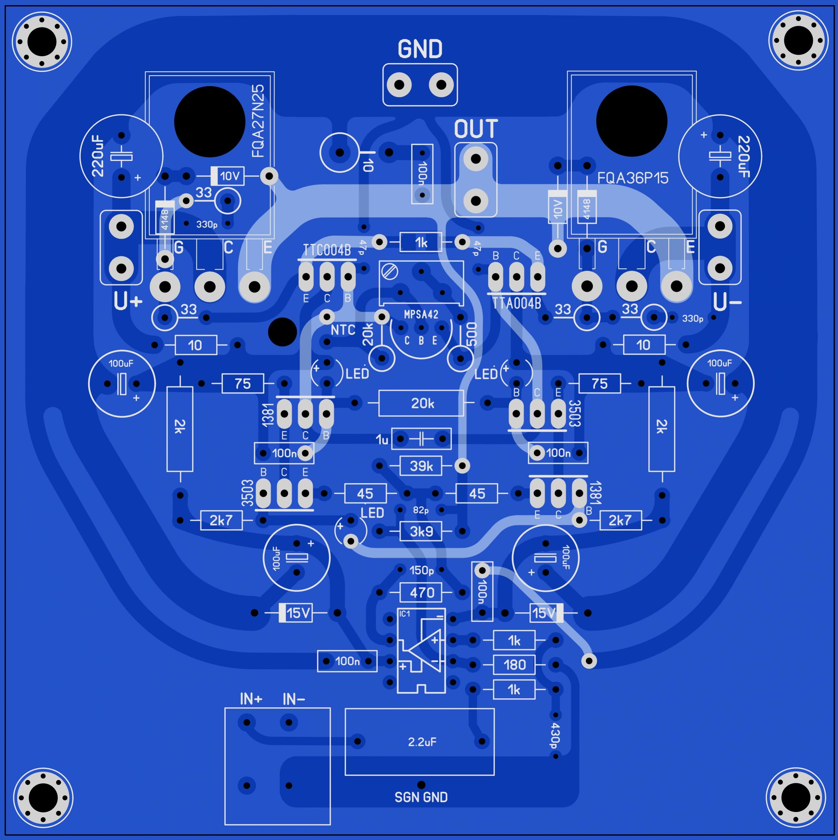

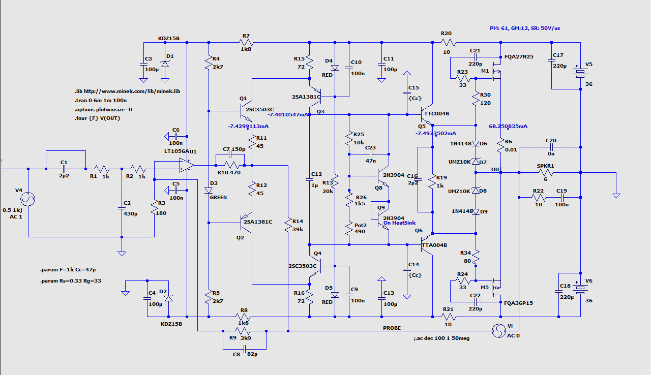

>Thank you. You mean this?
Yes. You were faster than me.
C23 is only needed if you planning to connect temperature sensor by wires.
If sensor is on the board soldered directly, you can skip C23.
Also speed-up cap C16 has been removed.
There is no consensus if it's needed, and at what value. Most likely smaller than 1uF..
You can try with it and without it...

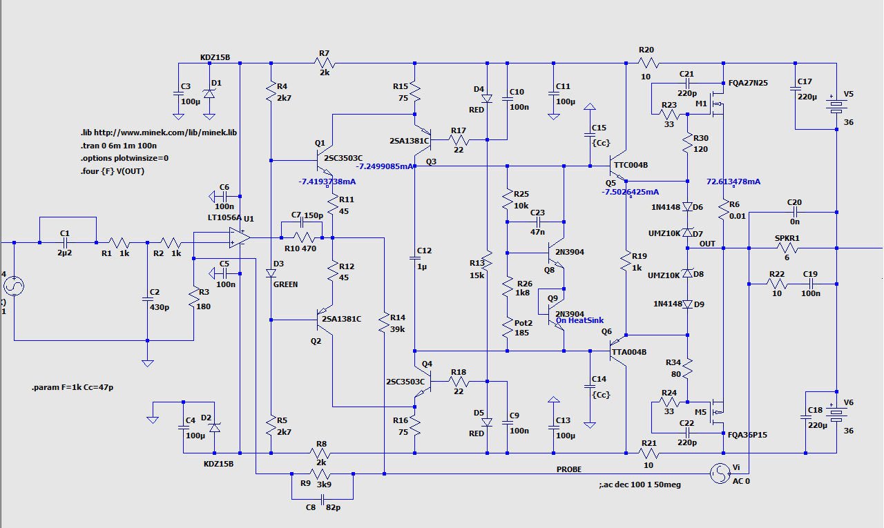

Thanks for the infos. I'm going to modify the PCB.

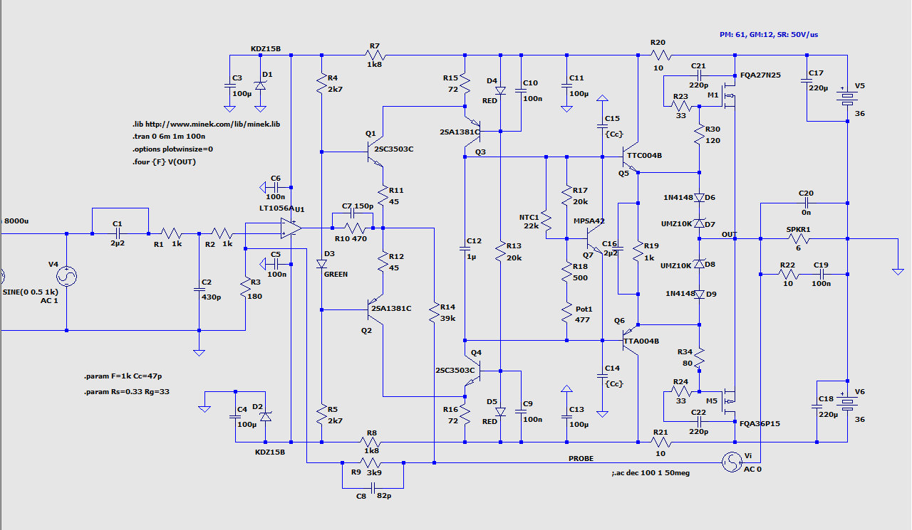

The current sources Q3 and Q4 provide the voltage gain in this circuit. They are controlled at the emitter so that the largest possible bandwidth is attained. Together with the transistors Q1 and Q2, each forms a complementary cascode circuit. One of the simplest and most effective method to eliminating Miller effect.
PS: I have to correct myself. It was jkuetemann not borys
I switched here to 2SA/2SC drivers, but I'm not sure yet what I'm going to use (TTC/TTA or 2SA/2SC)....
According to my latest motto (anything that causes the signal to have a variable delay is an enemy to beat) 2SK/SAs are better (at least theoretically), they have 4x lower Cob than TTC/TTAs.

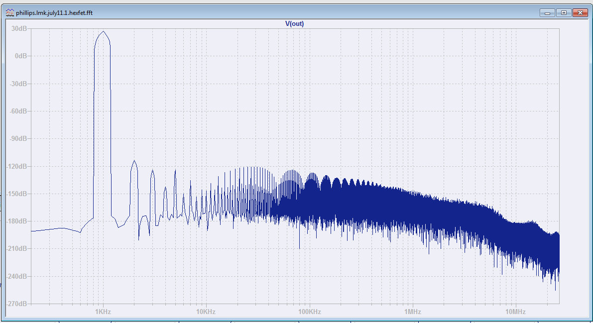

What are those periodically repeating humps over 10kHz in fft spectrum? I have not yet found a way to moderate them. Perhaps the FQAs themselves are the source of this?

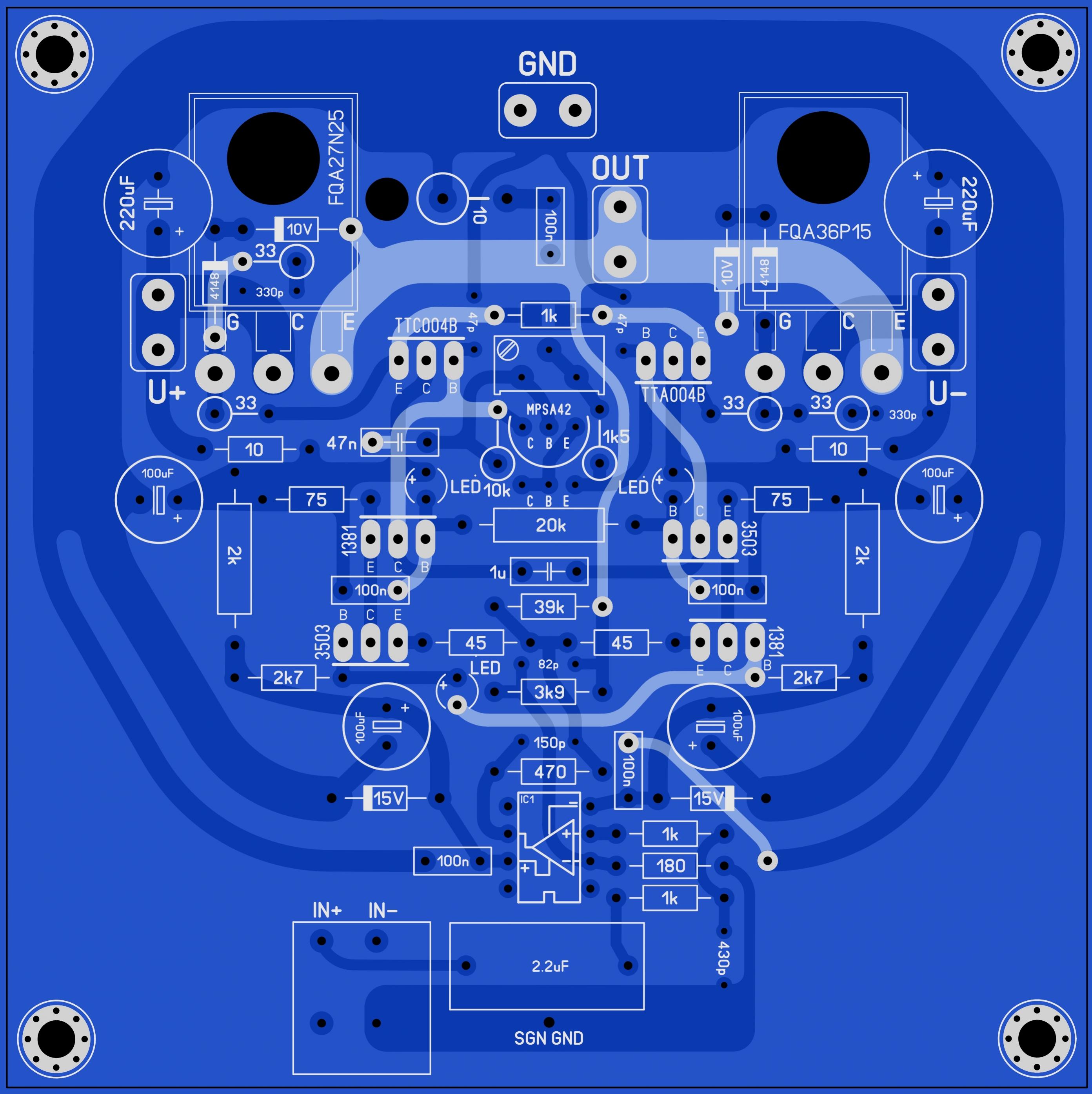

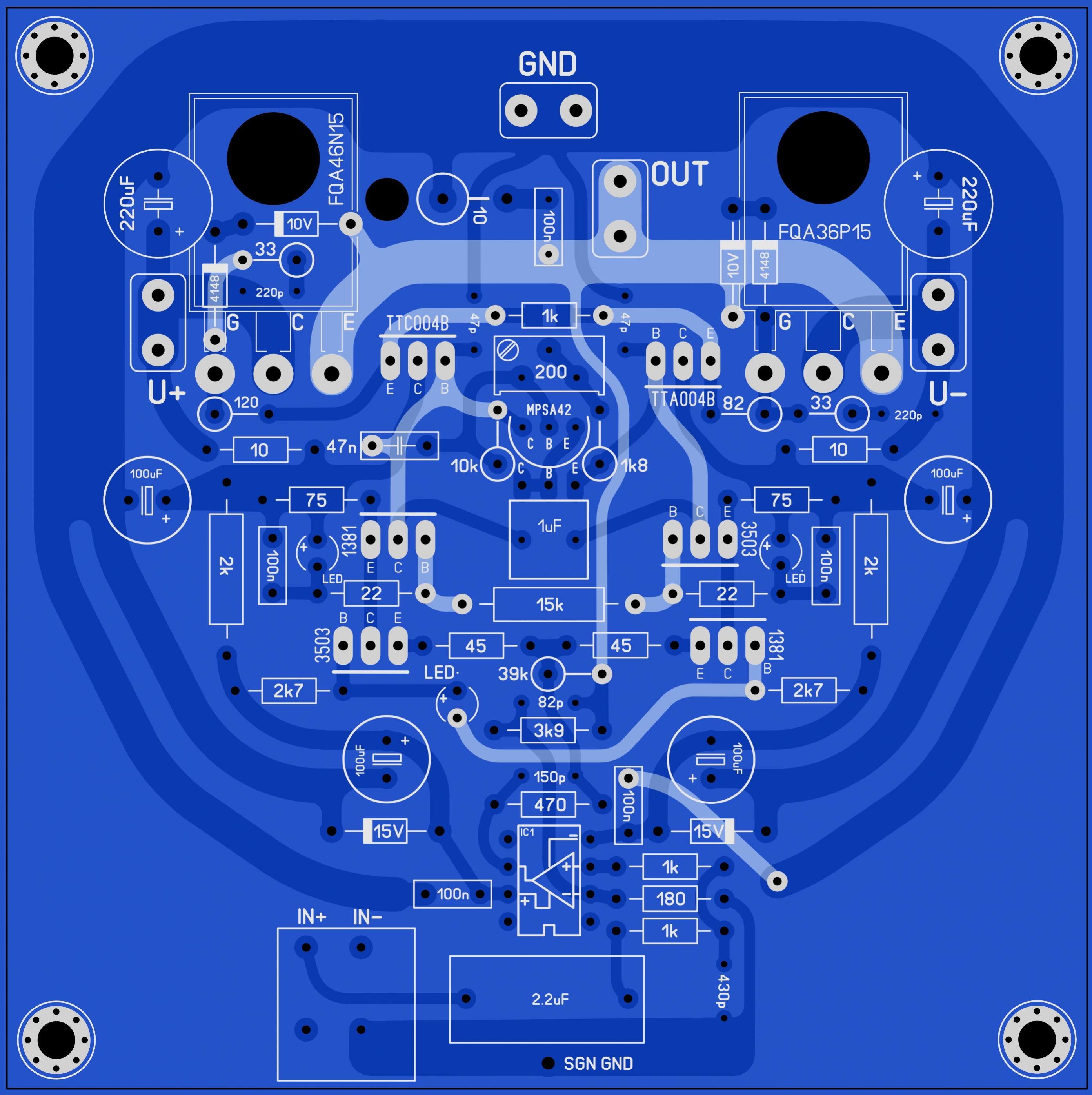

@minek. Today I want to send the PCB to the factory, before that I share the final version of 36V "mini beast".
1. VFETs are FQA46N15/FQA36P15
2. 33Ohm + 220pF snubbers are applied for better safety
3. 500 Ohm trimmer pot decreased to 200 Ohm for easier setting
4. R13 decreased to 15kOhm for better current symmetry of Q1/Q2 and Q3/Q4
5. In bias spreader 2x2n5551 will be used instead of MPSA42s.
Any comments will be appreciated

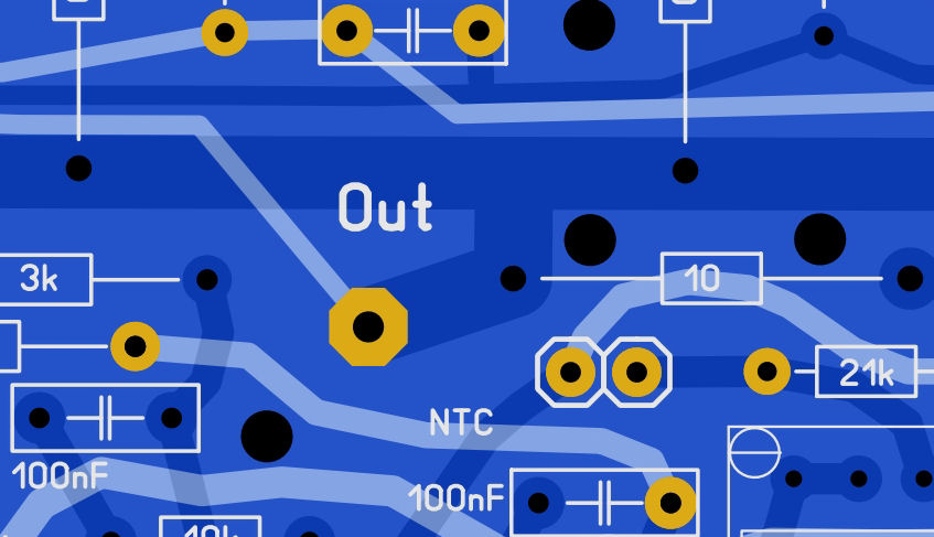

I only have 3 remarks:
1) 100nF capacitor in Zobel, usually should be bigger (X2 rated) - see this one B32921X2104M000 (that's what I used).
But I guess that's not really critical..
2) the output post, and FB takeout, should NOT be taken from the main fat track between emitters. Currents are not settled on that track.
See image attached.
Feedback track should originate exactly at the output post, not from the fat track between emitters.
This is more important than 1).
3) These 45 Ohm resistors, in real build most likely gonna be 47 Ohm
