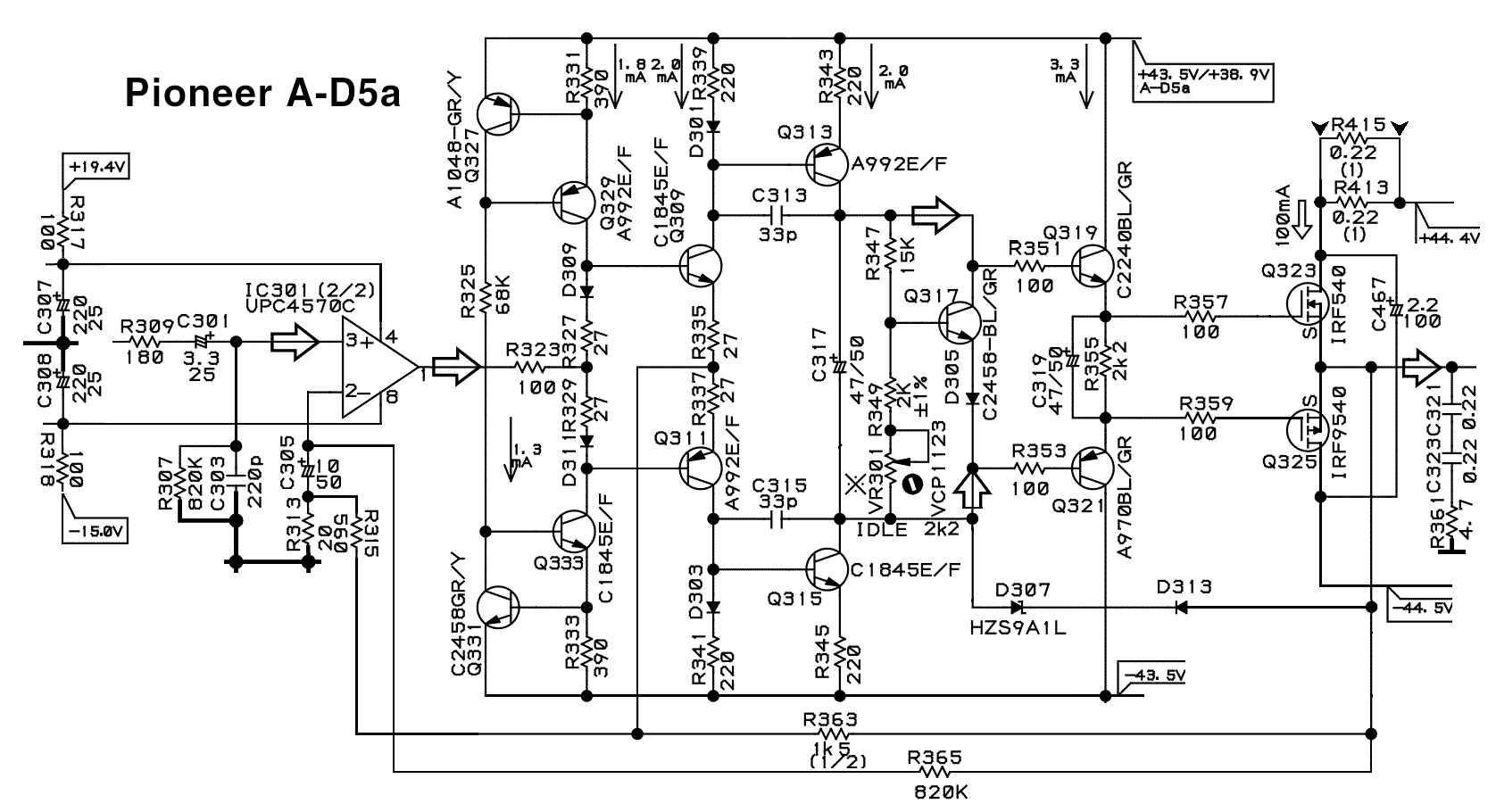

I have always really liked this design. It may have been designed to minimise costs by reducing parts count, but it has some wonderful tricks in it and the masterful connection of the IC is something I have not seen before.
HD
Agree. The unrivaled virtue of this topology is the rich tube-like sound and the complete lack of the usual solid state roughness and dryness.

Check this out. Similar to your LMK+Philips578 hybrid
Saw this. I did sim Bose (DAUB) amps.
They (except Bose 1800-III, which doesn't sim that great) use traditional VAS (like Philips), and Bose 1801 comes up really good. Better than Philips. Still working on it, but this could be worth building.. But my amp-building-pipeline is kind of full now (3 amps waiting to be built), and soon will have to go back to the office (no more remote work), so this will perhaps wait a little...

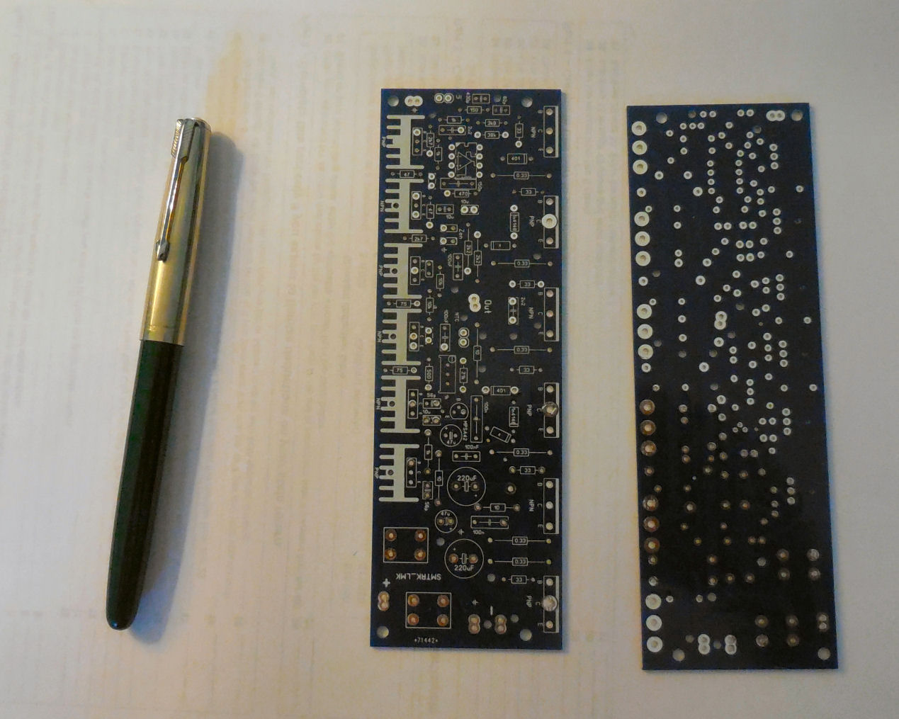

PCBs for the amp from post#2 arrived.
Looks like it's gonna be busy August...
Great! This amp what I really care about. I'm looking forward to the result. Starting to design my PCB for 36V.
- HexFet Amp Based on Philips AH578 and LMK
