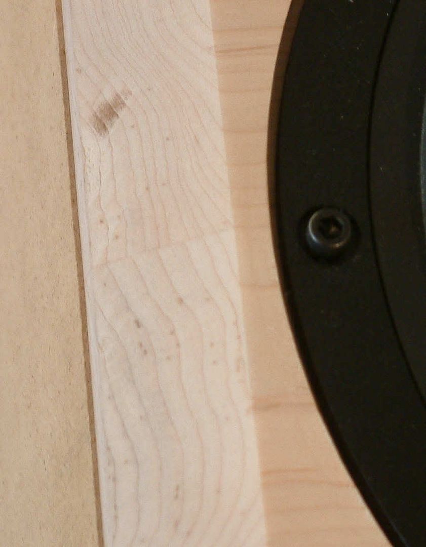

I had meant to report on my second class in wood lathe instruction, in which I started into shaping the diffraction lenses, but things did not work out all that well. I was a little discouraged over it, and just didn't report my progress, because I was not in the mood. But here I am.
Last Tuesday I had made a little foul-up in trimming off the excess Plastic laminate to the top of one of the speaker enclosures. Rather than use my old stand-by trim bit, which is a single solid piece of carbide steel,
I decided to use my other, better known one.
I have not used this bit in years, because the former one works so well, but worried that the solid piece bit would cause a burning of the veneer as it passed along the top of the cabinet, while I trimmed off the P/L. Unfortunately, I forgot to check the tightness of the locking screw at the bottom, and while trimming off the P/L, the ball bearing guide came loose, and the bit cut into the veneer. Now I am forced to either sand down the cabinet about 1/2", or attach a black trim to the outer tops.
And as if that was not enough headache, the blanks I made for the lathe class did not work properly. But I will get to that in a minute.
After my mistake with the router, I took out one of my cabinet grade 'seconds' plywood, and made the four blanks I would need for the lathe class. Wednesday, I took one of the cabinets, and the blanks over to the class, and practiced more on smaller pieces of wood, before beginning on the glued blanks.
I started out with the convex shape, which is the hardest, and then worked on the concave shape once I felt comfortable with the former. As you can see, I managed to get better as I went along.
Here is the instructor teaching the other student how to make spindle candlesticks. He makes it look sooooo easy,...........and fast.
The instructing process actually took about ten minutes, but if he actually did it without showing the student how he went about the process, he could have completed this in perhaps two minutes maximum. He is very skilled.
finally, the time came around for me to start on what I entered the class to do. We took one of the concave blanks and attached it to the "In Line" lathe, and my instructor began to show me how this would be started. As he began, I could see visions of finishing up my first set then and there. This was exciting.
but some things are not to be. In the picture above, the instructor is just about to turn on the lathe, and demonstrated the position I should take when I start out cutting down the excess wood. Unfortunately when he began working the blank, his cutting tool quickly went dull. So he tried another, and the same thing happened. So he tried a third, and the same story.
Then he sharpened all three tools, and tried again, but they quickly went dull. WTF was going on here? He called his friend and partner to ask why this was happening. The two of them publish together, and he had never seen anything like this before. But his partner recognized the issue immediately. The plywood was obviously from the orient, and the type of wood, plus the resins in the glue were of the sort that wrecked havoc on turning tools. The upshot was that the plywood was not economically turnable, because the turning tools were being dulled just as fast as they were applied. What a bummer!
The obvious lesson here is that if you are a wood turner, be very leary what plywood you purchase, should you decide to laminate it and then turn the stuff. Back to the drawing board here.
Friday I went to Lowes and for the sake of arguement compared the costs of using poplar, pine, and MDF for the next blanks. I quickly saw that using poplar and pine would cost me in the range of $100 or more for the blanks, while the MDF is only about $22. And I was assured that MDF would work, so I have decided to go with MDF to start. I consider this to be the most practical, because it is much cheaper, AND if I make any mistakes while I am still learning, the cost will be less for me, money wise.
So that is where I am currently standing. I need to remake a new set of blanks, using MDF, and attend another class where I will again attempt to make a set of diffusion lenses. This is new ground for me, so I should have known better and expected obstacles, such as this.
