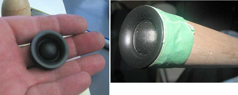

UPS brought my Parts Express order tonight, and one of the things in that order were my two ND20FB-4 tweeters. I took the dowel and cut another 1 1/2" strip from it, and repositioned the openings for the new tweeter, and here is what I came up with.
Then I took out my belt sander and carefully sanded down the outer flange where the screw holes were, and this is the raw look.
That should help improve the sound a bit, I think.
The diameter of the tweeter is exactly the same as that of the PP too. That should streamline things. I'll work on it some more tomorrow.

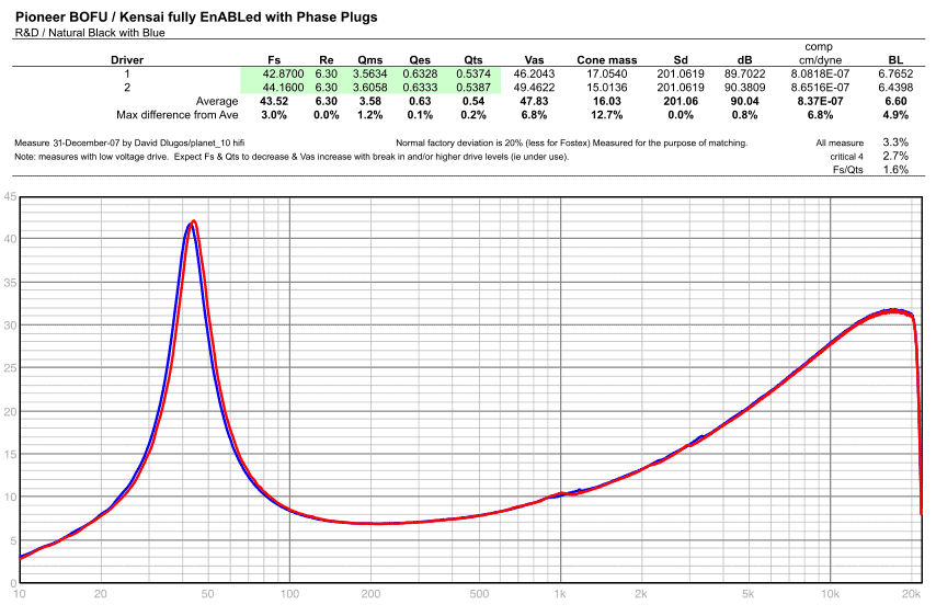

John L said:It states that the B20 has an spl of 94db.
90 seems to be what people are measuring.
http://melhuish.org/audio/parameters.html#pioneer
and attached are what i measured for the Kensai's B20
dave

Dave, the dowel is exactly 1 1/2" long. That puts the front of the tweeter about even with the top of the wheezer cone. Should I make it longer?
And I just thought of something else that should also stick very well, and will spread more evenely.

John L said:
Dave, what program are you using to obtain this graph?
Output from Fuzzmeasure copy & pasted into Adobe Illustrator.
http://www,fuzzmeasure.com/
i am using version 1.3.5 for impedance because 2.0 really concentrated on FR measures and the impedance T/S was a logistic step backwards from a producton POV, i haven't been able to try out 3.0 because it requires Leopard and i'm going to need a new Mac to run Leopard (planned to get an 8 x 2.8 GHz intel tower 🙂) .
Fuzzmeasure output really puts everything else to shame as far as quality output for presentation purposes. I can't tell you how many LAUD/Praxis/SoundEasy/ARTA graphes i've had to trace and then grapft onto a Fuzzmeasure grid fro presentation purposes.
dave
