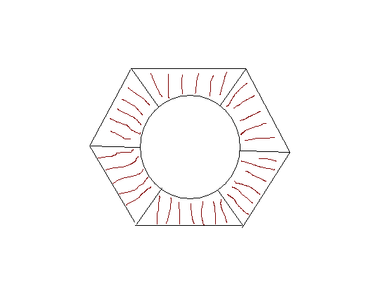

I have now gotten to the point in the project where I need to be thinking about the diffusion lense and the driver setup. Here is where I stand today.
All the preliminary work is complete with the cabinets and the bases. When everything else is finished, I will come back and clean up any over-application of shellac in places, and reapply several more coats. Then I will repaint the bases two or three more coats.
I will also add that I have another class scheduled with the lathe instructor for all day Wednesday. Hopefully I will have the proceedure down pat enough to complete a pair of lenses. If not, I will go back for a third session.
Almost everything is tentively complete on the top cap of the cabinets. Here is what the caps looked like before routing out the hole for the driver.
I had tried to get the fit as snug as possible, but later learned that this is unnecessary, and even not recommended. A seal running around the inside and under the cap will work just as well.
And here is what a cap looks like with the hole routed out and a reinforcement underneath the cap. In this picture you can clearly see my foul-up with the dado cuts, which I talked about earlier. I had filled in the cut with other plywood and applied enough glue to make it completely saturated in the stuff. It shouldn't be going anywhere, but it certainly looks terrible and I Know about my foul-up. I cannot guarantee that I will never do that again either.
Here is the cap turned upside down, with the inner cabinet exposed. I used the OSB because I had plenty of it setting around as scrap, and I needed something to help brace the bolts that would be holding down the driver. it should also add stiffness to the cap.
All the cleats were cut at approximately the correct angle, and were glued and screwed to the lip of the rabbet cut-out of the cabinet. Once my speaker mounting kits arrive, I will drill a hole centered near the edge of each wall, that goes into each cleat, and use it for bolting down the cap to the top of the cabinet. Also, for versatility, it can be unbolted and removed for changing out the driver in the future, if desired.
Here is the other cabinet that does not have the foul-up.
In the cap finishing department I had tried to come up with the most practical and best looking way to finish the cap. Origionally, I thought that some form of black plastic "L" shaped edging would be nice for finishing off the top of the cabinet. By using an Exacto knife and cutting angles, plus scoring the inside of the plastic, I would bend the edging evenly around the cabinet top. Unfortunately that did not work, because the plastic kept breaking on me at the scored areas, so I finally had to give that up. My thoughts of having a nice even trim around the top of the cabinet were dashed there.
However, I finally came up on the idea of just acquiring some black Plastic Laminate, and using contact cement to glue it to the top, and having an overlap, which could then be trimmed off once the lid was placed on top. The P/L would fit perfectly along the top, and I could adjust it to match the edges by shifting the lid around a little bit before tightening the speaker mounting bolts securely.

Thought about veneering the cap?
I'd be tempted to do it like this:
I had indeed. But there is only one little problem with that approach. If you will note, I had made a rabbet cut along the top of the cabinet pieces. this meant that the cap fits down inside the walls. If I veneered the top cap there would still be a 3/16 outer portion that would not be finished. By applying a P/L piece to the top and trimming it all around, the entire top would be finished, and removable. Only if I could come up with a thick enough piece of wood would that work, and the overhanging portion would still be more fragile than the P/L.
Also, the driver is black, as will the diffusion lense too. so keeping it black will probably go with the colour scheme better. It would be nice if I had thought this one through a little better. The next hexagon enclosures will be a bit different, and incorprate all the improvements I have learned with this project.
Here is some really nice stuff I just acquired off E-Bay for a very nice price.
It is "Yew" and it is loaded with cluster burls. It's fairly light and perfectly highlights the burls. Unfortunately the sap at the corners will not be there when trimmed down, but it should prove to be a nice looking veneer should I decide to use it with a hexagon enclosure. I also have another order coming which will also will be good for a follow-up project.

Here is why I want it to be removable. I like to tinker with things, and the B20 may not be the perfect driver for this unit. And perhaps I may wish to upgrade to the Fostex 207. Who knows? Also, I may wish to go to a larger driver, which a 2.75 cu ft enclosure would allow.
I would much rather have a flexible enclosure than be locked in to just one thing. Besides, the pluses of being flexible far outweigh the negatives of rigidity, IMO.

John,
You could simply create a new baffle to sit on top of the one you have already that overlaps your rabit joint. It could mdf that you paint black or even a contrasting solid hardwood, if you are not worried about splitting.
If 3/4", that would allow you to cut some chamfers on that baffle, sort of like Duevel does on theirs and like I did on my first 13" square omni (mine were about 2" x 1/2"). It could easily glued to the other pieces or held with screws or bolts with hurricane nuts imbedded in your original bafle. The original baffle could even be glued into the box that way, since the new baffle would be removable. You could also cut the hole in the original baffle about larger so that you would be able to add a new top baffle anytime you want and grow the driver in size. It would also give the driver a little more breathing room this way, since the combined baffle depth would be pretty thick.

Thanks Dan. If things don't work out for me, I will give it a go, and do something akin to what you and John are recommending.
I feel very comfortable with P/L, have worked with it for several years in commercial construction, and know a lot about it's strengths and weaknesses.
I went to Lowes and checked out the price on several types of Wilson Art and Formica P/L today, and the minimum size requirements are quite a bit. With one, I have to purchase at least a 36" x 96" sheet , and the other the minimum is a 48" x 96" piece. The prices run from $58 to $74. That is far too much for what I am willing to plank out at this time for just two baffle tops.
However, I already have several nice pieces of P/L in other colours and finishes. What I will probably do is make a rough cut, and use contact cememt to adhere it to the cap. Then trim the piece, and lightly sand the surface, to help paint stick better to the plastic. Then spray paint it with the same black I am using on the base.
Keep in mind that the P/L is very stiff, and a 3/8" overlap will be very sturdy, thin, and the edge can match the top, and not overwhelm the veneered sides. I'll give it a try, and if I have problems, I can always fall back on your recommendations. But I can't do anything today, as I still have snow on my back deck, and it is a balmy 32.7F here in Raleigh. Not the best weather to be out working on contact cement, that's for certain.😉 😀
BTY, I also like those chamfers too, but I am worried about the placement of the driver, and mounting the tweeter on the modified phase plug. If I'm not careful, it will stick so far out that the diffusion horn will have to be set too far upward.
What I am really thinking about is perhaps recessing the driver below the baffle. Since the diffuser would be doing the dispersion, would recessing the driver hurt it's performance?

MJL21193 said:Have you considered edge banding? It comes in black. Just iron it on and trim it.
I have John. In fact that is the first thing I went looking for locally. Unfortunately, I could only find the white banding. I had intended to look on the internet and order some, but came up with this P/L idea first.
The problem with the trim banding would be that I would need to trim off at least half of it, because the black just doesn't look all that nice if it is wide.
