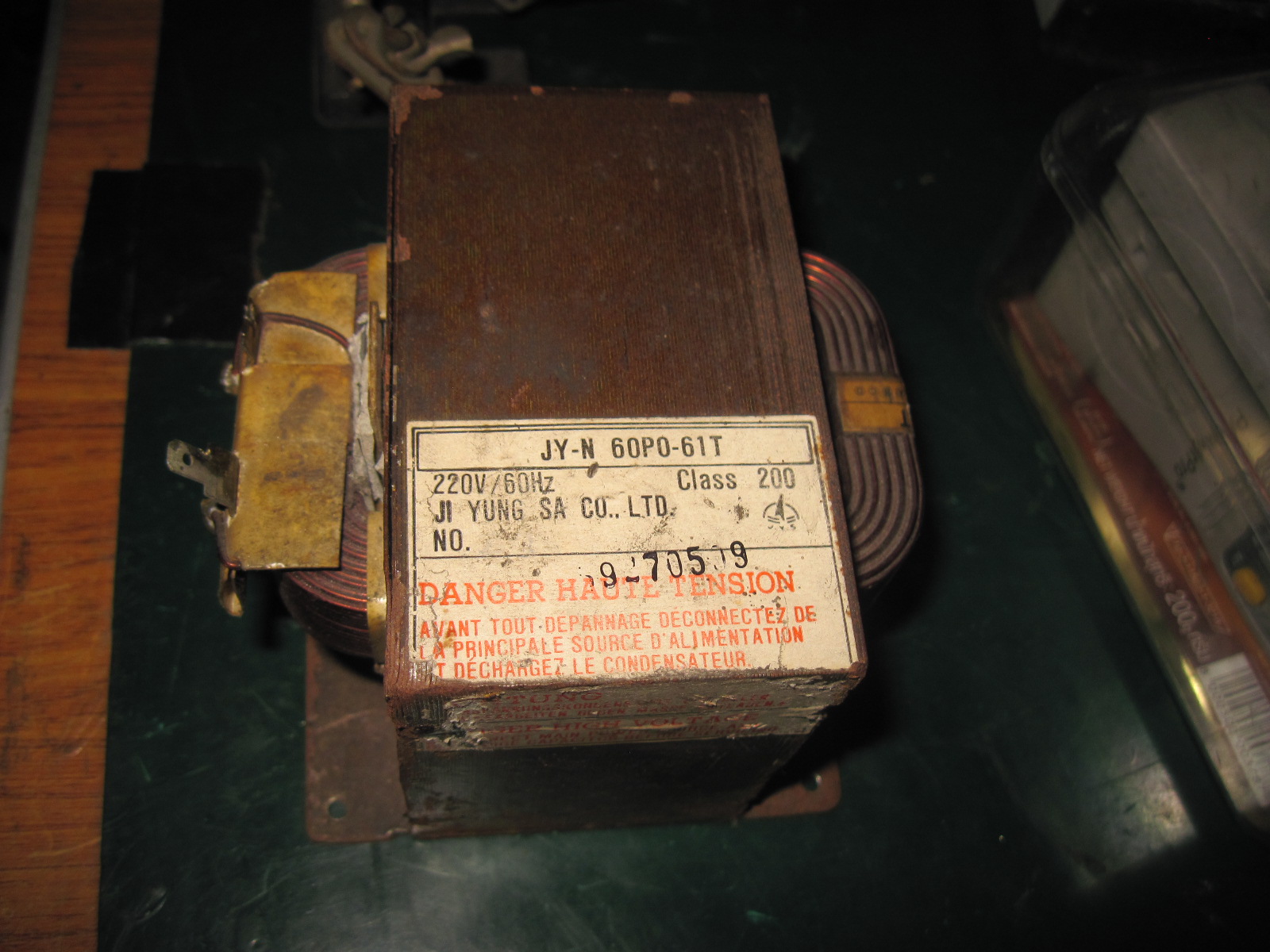

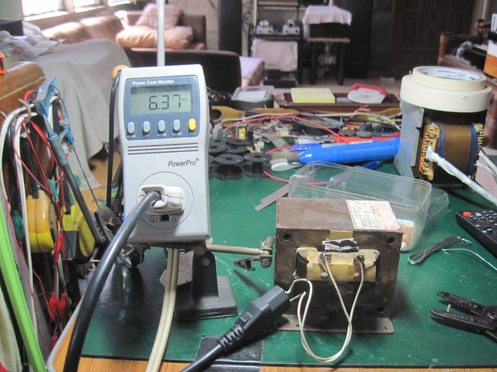

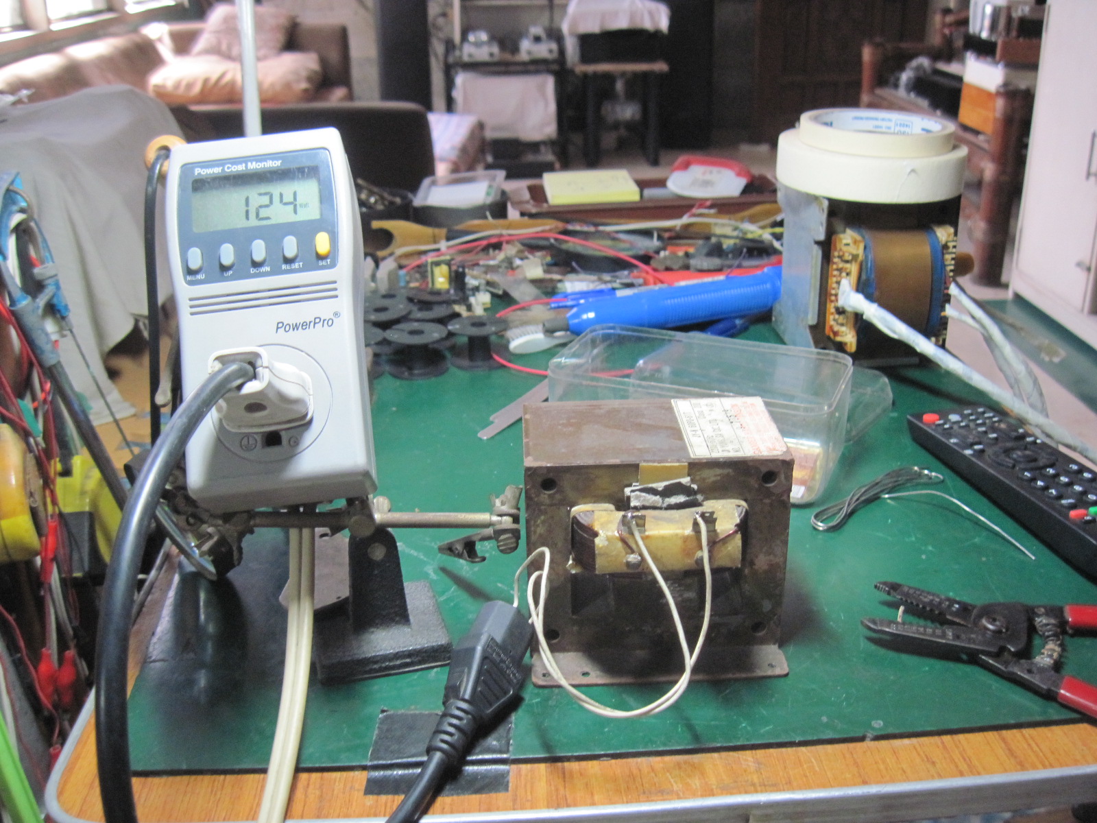

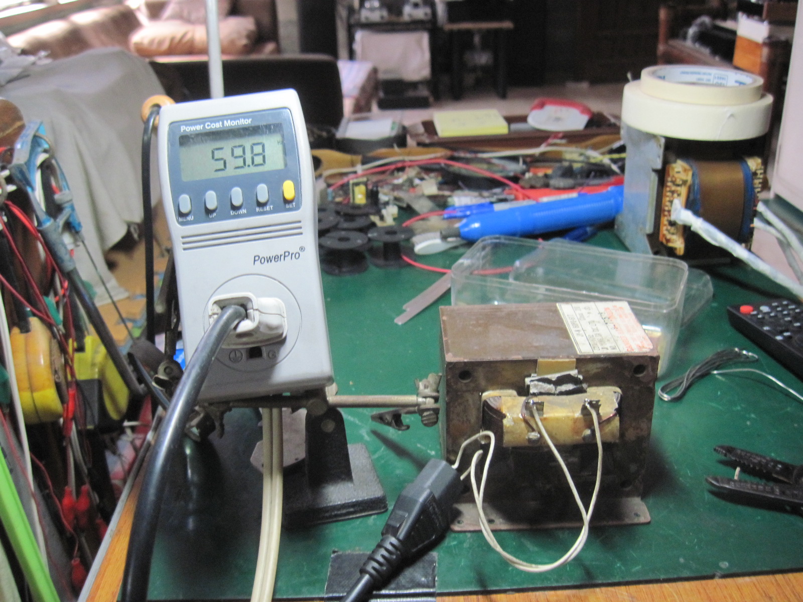

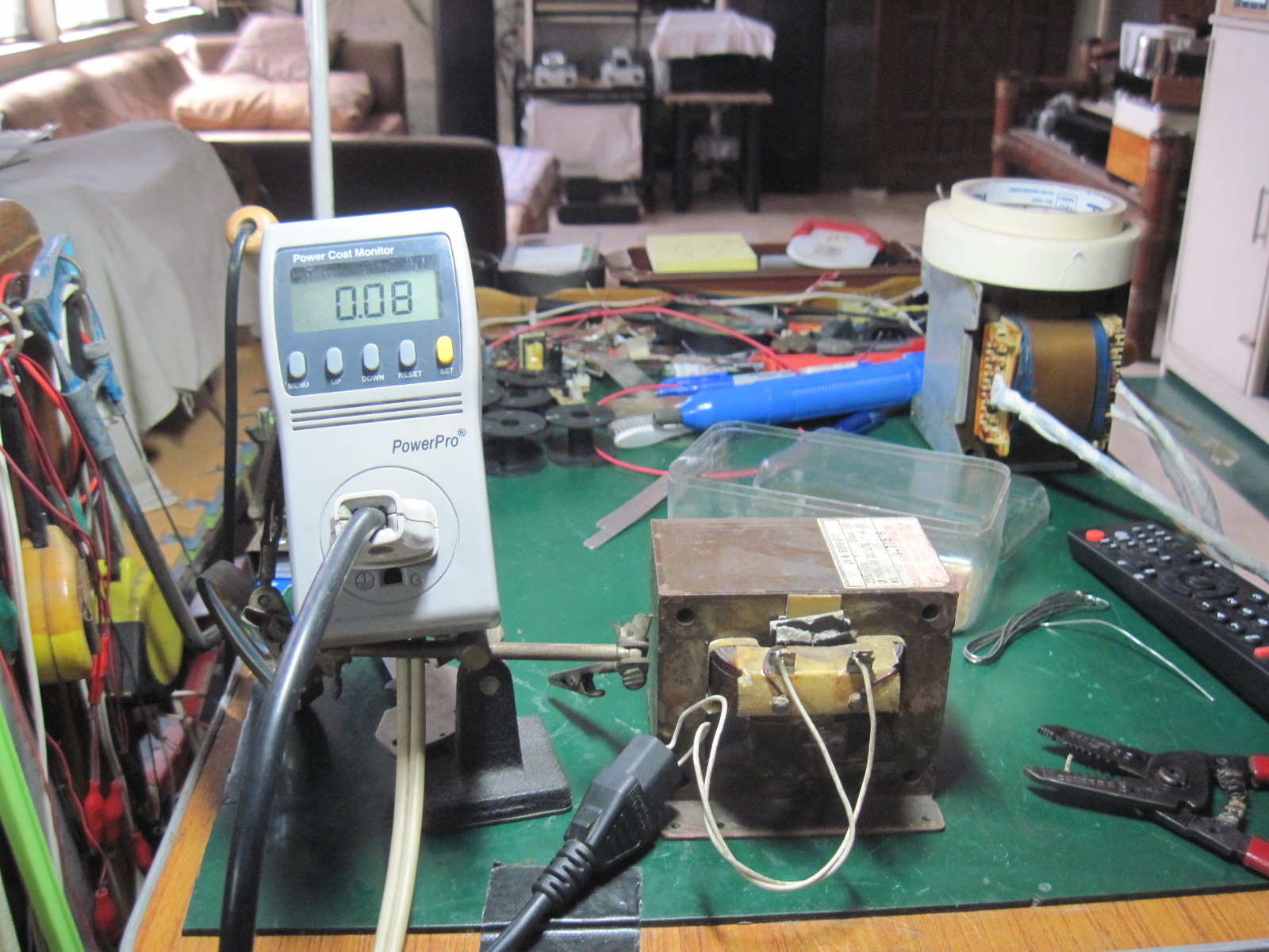

i did a quick testing of MOT salvaged from a junked microwave oven....
i think that the data speaks volumes....
readings are line voltage, power factor, energy draw, real power draw, line frequency, magnetizing current.....

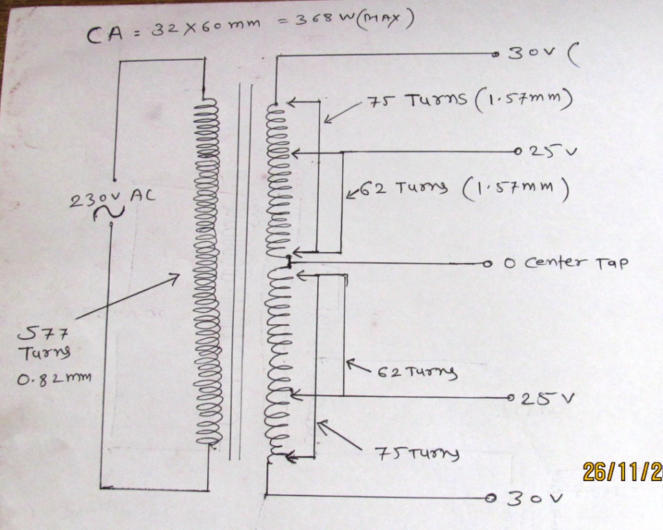

MY EI core size is 32mm*60mm giving 368 W maximum power.I want to make 30 0 30 5A secondary out from transformer. according to my calculation dual winding of 75 turns for 30 0 30 V if i want another 25 0 25 V 5A from same winding with same center tap.Can it possible after dual 62 turn to take wire out for 25 0 25 V and continue up 75 turn which will give 30 0 30 final out from secondary.(Note that I will not use both voltage rail at same time).
following diagram for better understand my question

Isn't it a bit short-sighted that you have used Ae² for your power capability calculation after Pafi has assured us that this is wrong !.........MY EI core size is 32mm*60mm giving 368 W maximum power...............
Your turns ratio 577:150 gives the open circuit voltage ratio.
i.e. 577Turns @ 230Vac gives an open circuit output voltage of 29.9Vac for 75Turns.
You now need to reduce this by the estimated transformer regulation value of this EI. Try using 8% for 368VA EI transformer.
i.e. output voltage ~29.9/1.08 ~= 27.7Vac when loaded with a resistor to draw the maximum design current.

Thank for your reply ,i will make changes according to your suggestion ,but is it OK to take multiple voltage from same secondary winding according to my posted diagram ?
Multiple taps are good.
Better if you do a multiple tap dual secondary.
No more wire, but a lot more flexible when you come to wire it up.
