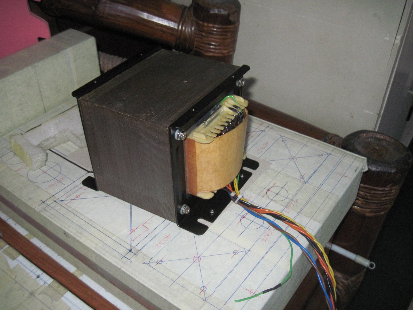

here is my recently built traffo using H50 cores, no load testing showed 60mA no load current,
and 15 watts of core loss, and with 9kgs of core material, that is 1.6 watts per kilogram...
with an effective radiating surface of about 59 sq inches, this traffo is running cool...
core is a 1 3/4 inch center leg with 4 inch stack....
will do short circuit testing shortly....
Looks nice!
nicely done, looks 1st rate.
do you use any special impregnating sauce recipes for tropical climates?

Looks nice!
and i guess there is no point to being too precise, being in the ball park is good enough for me......😉
i use the clear air drying polyurethane varnish where i dip(submerge)
the traffo for about 15 minutes, then pull out to drip, then back in again in a
process that takes almost an hour....
then under the hot manila sun to dry, takes about a week...
sun baking, these traffos get hot to about less than 50*C....
