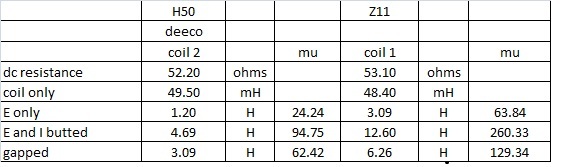

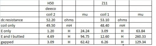

on stacking factor, RDH4 recommends 2 or else use a bigger sized laminate....
one important factor to consider: the quality of cores used,
this is also a deal maker...
i have several power traffos made in the past that i discarded due to heating issues,
these traffos are good traffos mind you, but just that people find heating as unacceptable...
these traffos were built with H50 cores, since i got several kilos of RM18(M24) cores,
i am replacing the irons with RM18 ones, i have taken data readings as to no load watts lost,
so i can compare the results after the change....
below is the comparative inductance data with H50 vs, Z11(M6):
trend seems to indicate 3x better in terms of inductance,
but as always, downside is cost is 5 to 6 times more...
