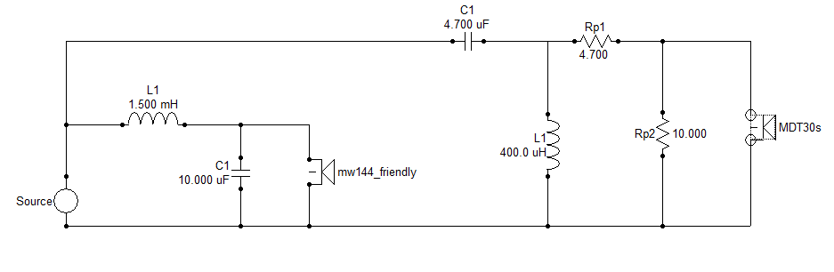

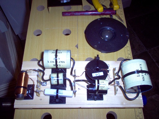

I just received some used IPL M4 crossovers. They use the same MW144 with an MDT39 tweeter in a 5L sealed box. They incorporate a Zobel network (say the instructions).
The LF section uses a 1.04mH choke followed by a 10uf to ground that sits in series with a 1ohm resistor.
The HF section starts with a 6.8ohm resistor followed by a 4uf filter with a 0.53mH choke across the tweeter.
I have no idea what this means, but it looks to be around a 2.5khz X-over by my reckoning.

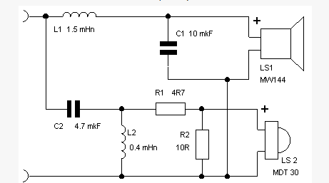

Do you know there's a Russian crossover design for your drivers?
2-? ???????? ?? ?? Morel MW144 ? Morel MDT30 – ldsound.ru

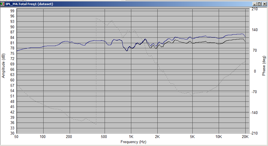

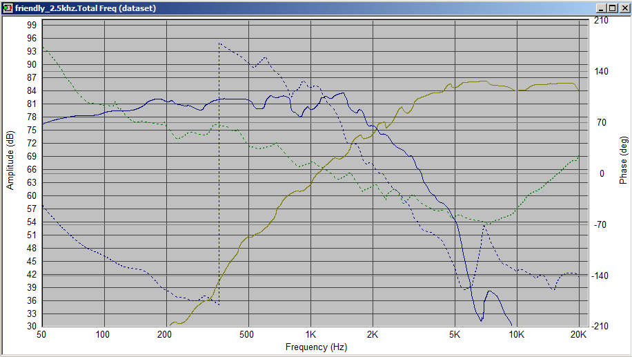

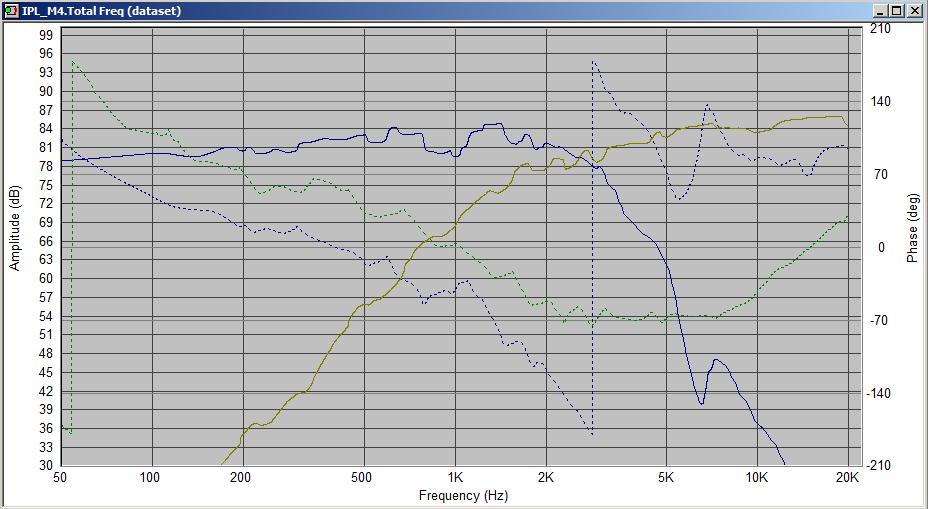

I ran those values through the same sim as I did before. Same drivers same offset just the new crossover values. The IPL is a bit smoother I suspect the drop between 5 and 10Khz will probably be pleasing. Black is the IPL curve... also slightly less peaking in the 1-2Khz range.
What I would really like to know is the real offset between the tweeters and the MW144's I went with 12mm... the IPL crossover seems to have not very good phase matching.. maybe they did this to get a smoother overall result. Perhaps the phase matching is not as important as what I think it is (certainly my own experience tends to say it does make a difference).. though revisting I certainly didn't get great phase matching either, perhaps the constant non matching of the IPL is better than my crossing phase...
Actualy I just put in some target curves, it looks like the IPL is a 3rd order butterworth at around 2.5Khz Tweeter doesn't match the curve fantastically but it looks like that is what it is which is why the phase doesn't match... it is not supposed to!! should be 90deg out and it looks like they have done a good job with that.
2nd attachment is IPL's phase, and 3rd is the phase of the crossover I originally put forward. 4th shows 3rd order butterworth targets at 2.5Khz 83db

Interesting the Russian crossover is quite similar to what I had come up with. here is the comparison.
I think I'll trace the russian final curve so I can compare it to the sim and get an idea how close the traced curves of the drivers are to reality!

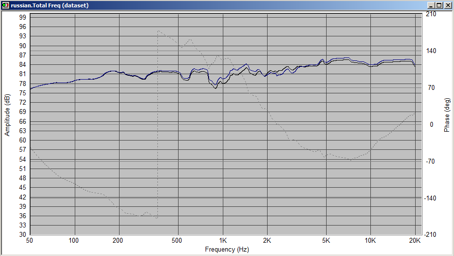

Tony.

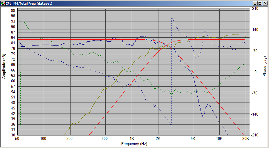

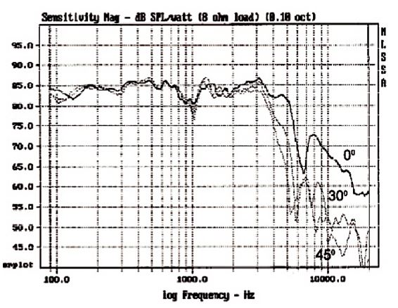

Quite a difference between the sim (using traced manufacturer curves) and the Russian result! Note he is using a vented enclosure so that explains the low frequency boost, but quite a difference in the upper frequency response! black is the sim, green is result traced from russian site.
I guess this shows why having some real measurements of your actual drivers in the box is the only way to go.

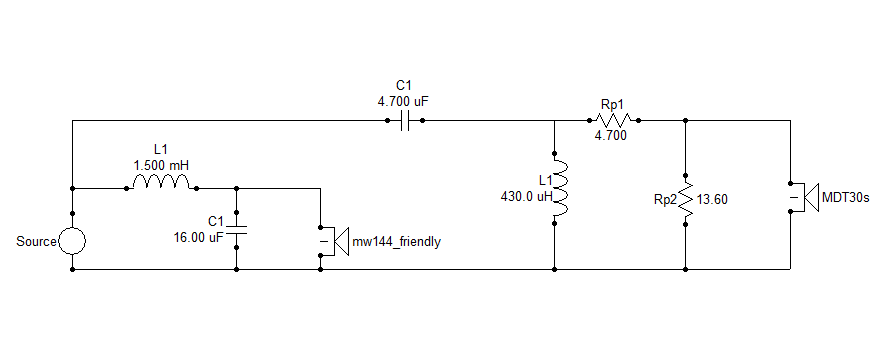

I did some new measurements on Sunday, and wanted to have a go at doing a new crossover, at a lower frequency. I'm using vituixcad for the first time and wanted to try the off axis measurements but something is not working out right. I assume that's where you saw the plots.
If I make that crossover and it works out as good as the sim I will be very happy indeed! I've been mostly happy with the current crossovers for the last 6 years or so, but have always thought I could probably do better. The funny thing is that the current crossover involved weeks (or maybe months) of trying things in the sim, the one I just did took me a couple of days, and is heaps better.

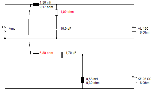

I found I did have the IPL crossover in speakerworkshop. Not sure what you have tried but my first suggestion would be to try upping the 6.8 ohm resistor to 12 ohms and see how it sounds. I think (once again assuming that the factory traced plots I have bear some resemblence to your drivers) that that would be a whole lot more listenable.
blue is original IPL crossover values, black is with 12 ohms instead of the 6.8 ohm.

Hi Steve! Simple provided the mw144's are actually similar to the factory specs 😉 not sure if you remember what mine look like... I did these measurements on Sunday, as I am having a crack at a new crossover for them.
It's looking promising, would you believe I got them (in the sim) to within +- 0.75db from about 160Hz to 13Khz...
In my case I found getting a good phase match essential to getting a really good sound with these drivers, and without some actual measurements in friendly's case I'm not confident of getting it.
