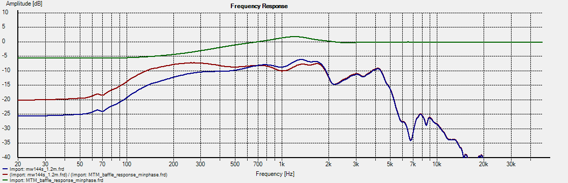

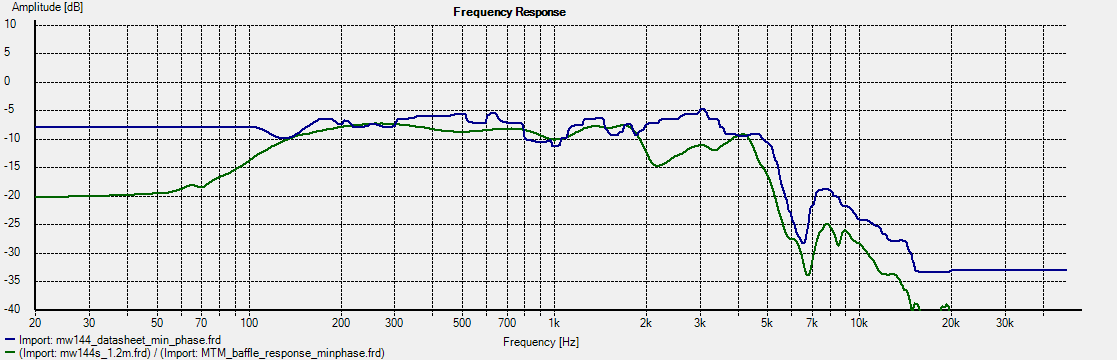

I have a rough crossover for your MW144 and MDT30 (?), based on Tony's rather good MW144 FRD file, which matches the published curves. Tweeter level might need adjust. Any resemblance between this and a 11 ohm BBC LS3/5A is not coincidental. It's all rather Butterworth. 😀

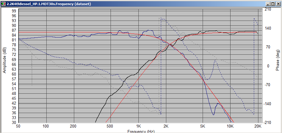

This is so long ago, that I can't remember what we were doing here, but I was looking at this crossover today.
If I remember right, the MDT30 digs a bit lower than the smaller MDT29, but a useful idea for a low 2kHz MW144 crossover here:
MW1448 + MDT29-4 Passive Crossover Design - Madisound Speaker PDF Library
Hope it helps. BTW, I'm not sure if that bass shunt resistor is 3R or 6R overall either. Horrible slackness by Josh! I would call him into the office! LOL
It's not set in stone but this adjustment sounds alright. Which seems to point to a greater difference in sensitivity than expected. I need to get that fresh fluid in and then see about turning the tweeter down a couple of db. It has been a while but iirc Tony set me up with a 2.4khz crossover drawing which I need to look over but it may allow just a simple L-pad of fixed resistors to fix this. Ultimately it's just the balance I'm talking about here though. I still have thin sounding tops. I think I'm right in saying dynaudio have the softest of silks I tend to like, so may cast my eyes that way soon. I picked up a Roksan K3 and it's not done the tops any favours beside my old Arcam
Looking back over the thread, it seems I used a commercial crossover aimed at this duty, with an additional 5ohm in series with the tweeter. I feel more like a reader than the thread starter now. There are people reading up to this point that know more about what I have done than I do. Actually, that's not really that surprising.
