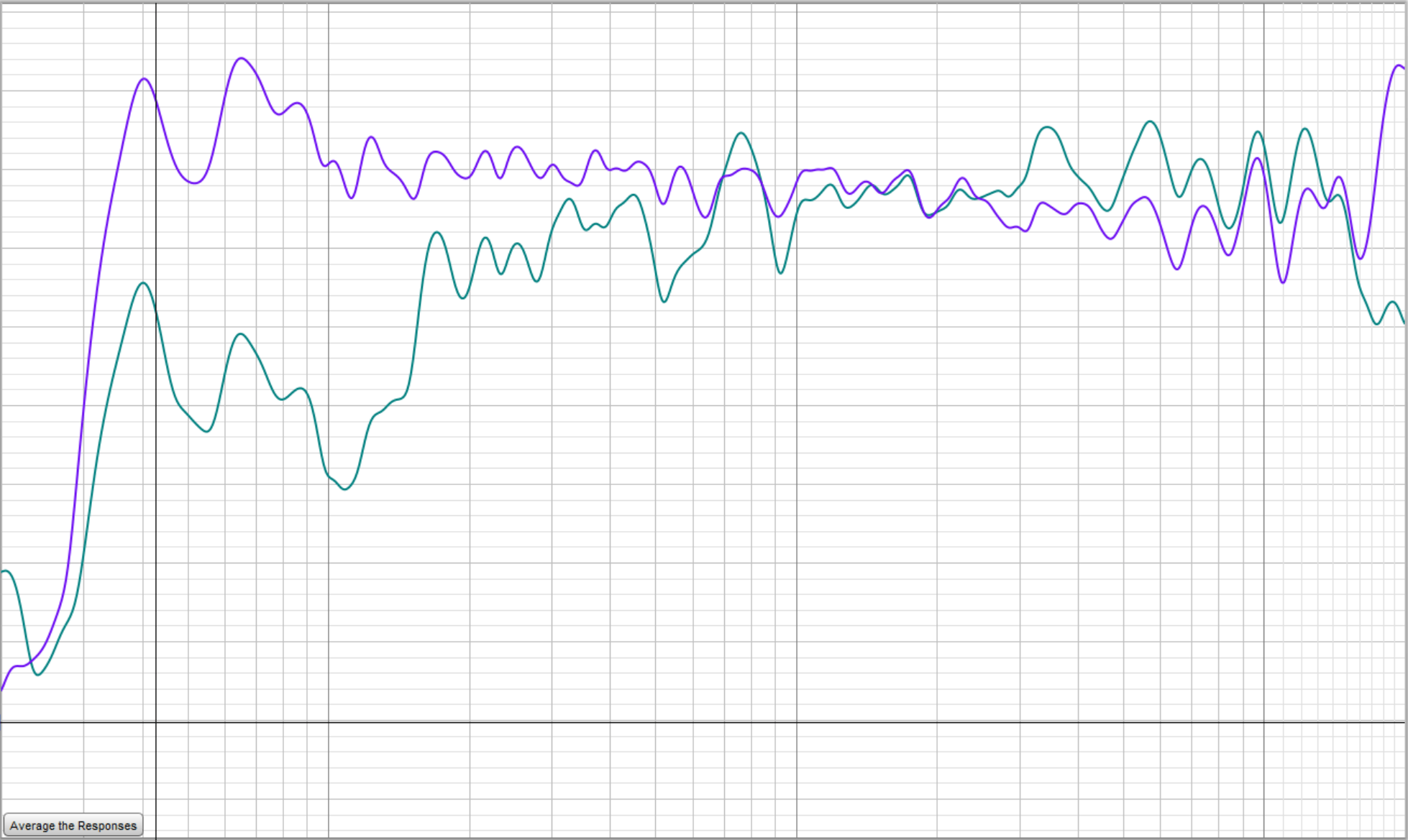

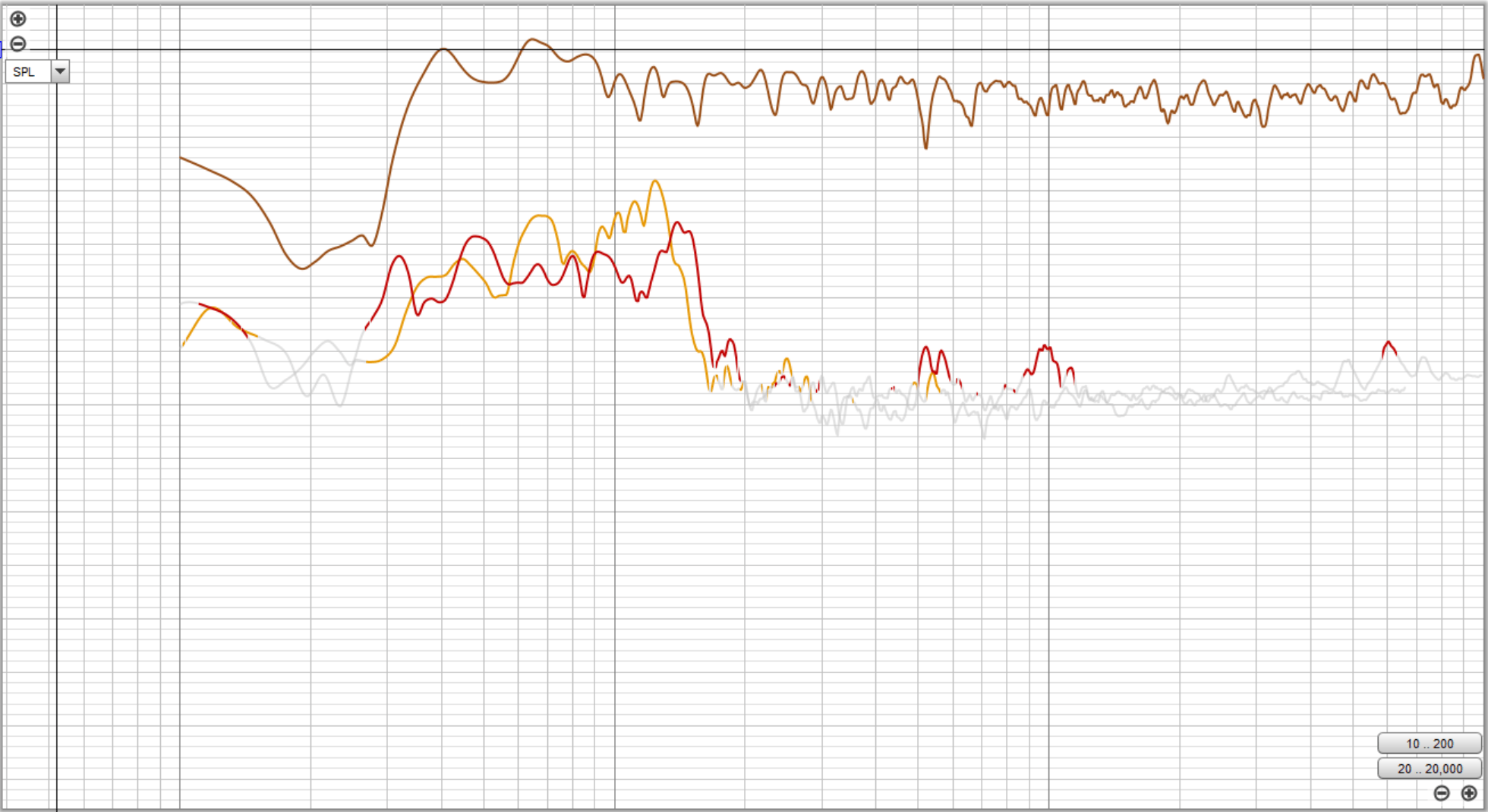

Here's the measured response at 1.50 meters. Green line is without DSP and purple line is with DSP.
Of course, once the bass is boosted, the distorsion rockets.
The cabinets is audibly vibrating, particularly the rear panel. I suspect it's due to coupling the driver's magnet to it directly with measly foam in between. By clamping the cabinet as hard as possible with my hands, 99% of the artifacts due to vibrations are removed.
Also, for now, the driver is screwed directly to the XPS, which is very obviously less than ideal. And since the screws cannot really 'bite' that hard into the foam, there as to be some leakage and vibrating from the driver being passed to the front panel.
I tightened one of the screws while pressing hard on the driver and it already made an audible difference.
I'm going to see how I can make sure the drivers is correctly fastened to the baffle, perhaps by adding a dense cardboard ring between it and the baffle. Should give some additional bite for the screws and reduce vibrations.

Alright. I unscrewed the driver and removed the brace that was touching the magnet. Most of the vibrations are completely gone and it sounds a looooot cleaner. Now, the only remaining vibration, although very slight, seem to in the 80-100Hz region. I'll see what can be done about this, but overall really really happy with how it sounds. It's big, warm-ish, but still detailed. I stuffed the port to try it sealed and I like it even more.
EDIT: I squashed the rest of the ringing emanating from the cabinet. Bass region is now as clean as can be, no weird vibrations. It is a little smeared and overwhelming, but I guess that's all that can be expected from a fullrange being pushed this low.

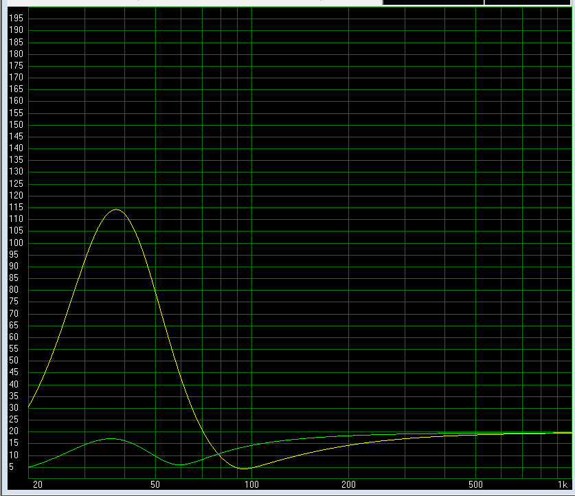

The power that is needed needs to come from either electrically or acoustically.
The electric power that is needed is inversely proportional to the cabinet volume.
This can be very easily be modeled in your favorite simulation/modeling software.
Here is a example of the same woofer in a 4L cabinet vs 12liter cabinet, both with the same frequency response (corrected with EQ) and same SPL.

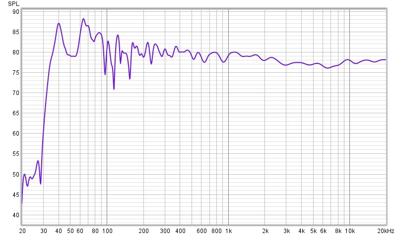

Your curves have no axis labeling… looks like a huge step at just under 200 Hz. Way faster than baffle step would decline.
Have you got a leak in your box.
As to the driver brace, having done it hunddreds of times, your brace must have been poorly implemented as we get the opposite results, getting it just right is tricky.

With the same music, in a smaller box with more EQ (aka some conditions) it still needs more power.
The only variable here is the acoustic volume and the EQ to compensate accordingly.
Since P=V²/Z (Z is impedance), electrical power MUST go up.
In this particular totally random example, we already have a factor 80/10 = 8 difference in power @ 50Hz.
I don't call that nothing, I call that extremely significant and enough to blow up a small amplifier when not taken care off.

How stupid of me. Here's the curve with Var smoothing and proper labeling.
The response is somewhat wonky. I also EQ it with a very approximate house curve in REW, I'll need to work on it more tomorrow.
There's is definitely some weirdness in the 100 to 200Hz region. I squashed even more of the panel resonance since I made that measurement.
I checked for leaks and while I couldn't seem to find any by doing the 'wet lips trick' (made me look very stupid), the baffle seem to have come slightly undone in one place due to the glue not curing fast enough expect at the edges. I caulked it and it's now being pressed under weights. I'll leave it like this for a good day or so, as some of the glue points, while seemingly sturdy, actually haven't really cured yet. Which does help at all with panel resonances since the bond isn't perfect yet.
